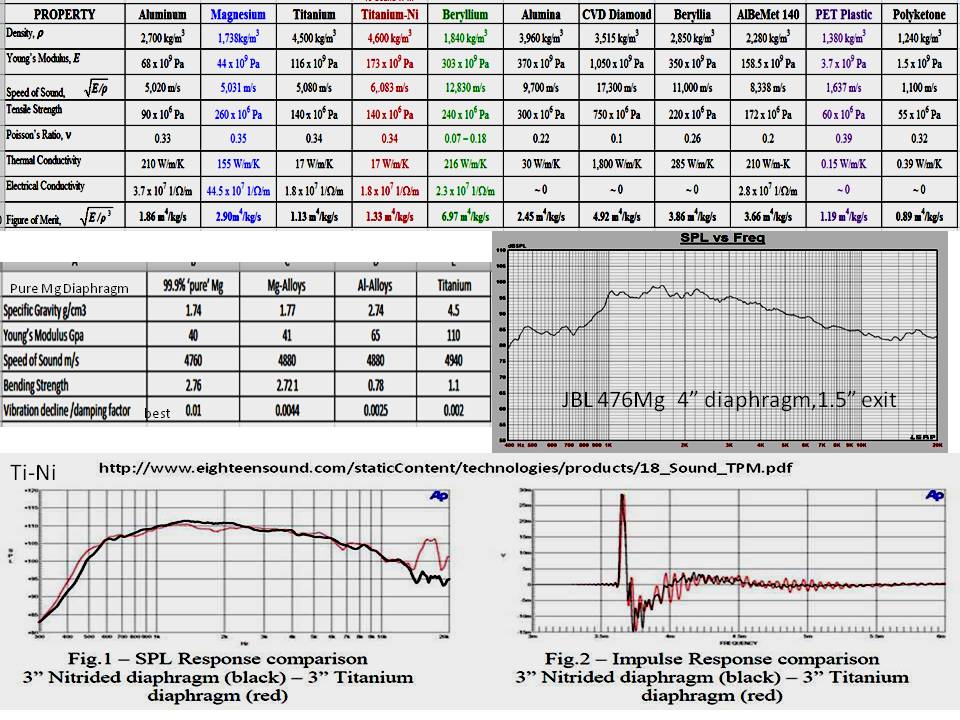

The Faital HF108 and BMS 4552 would be my choice... for the lower 1000-1400Hz Xover frequencies required by 12" - 15" midbass using light-load horns like SEOS, H290C, QSC.
The plastic diaphragm Faital HF108 uses a NdFeB magnet for 2.2T with a very shallow phase plug producing conical 31-degree(full-angle) exit.
The BMS 4552 has a unique annular plastic ring radiator diaphragm which avoids many resonant modes. With a path length of 5.1cm and 24-degree exit angle the curved wavefront launch from this patented design helps conical and tractrix horns improve coherence (arrival time smear). Versatile.
The 18Sound NSD1095N would be my choice... for 1.6kHz and above. The 27 exit angle is designed for the 18Sound XT1086 horn. The NSD1095N uses a TiN diaphragm for high-detail treble with reduced Ti resonances.

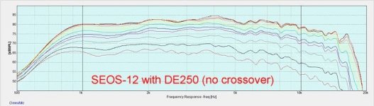

I immediately did FR sweeps of each driver with no EQ or XO. Measured at about 1 meter. DE250 is yellow, TCD is teal
Then I tuned each one to be flat and w/in about 1 db of each other, green is DE250, purple is TCD

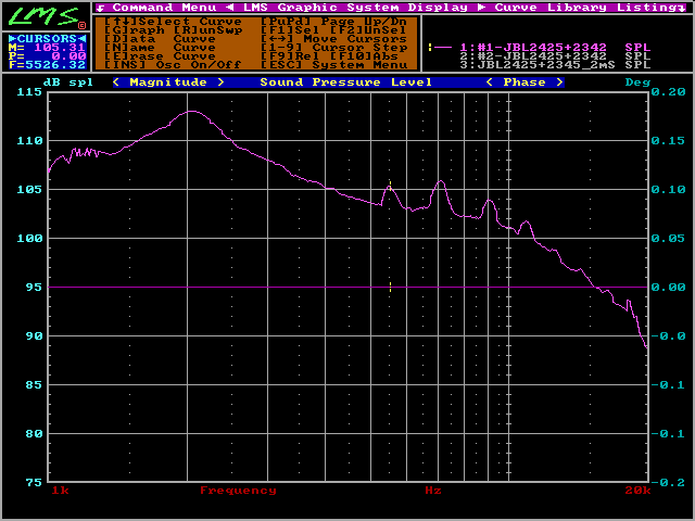

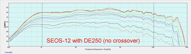

Does DIY sound group plot looks smoother or is it just the way it's presented.
Which ever way it is, it's still better than my JBL 2425 with a 2342 horn. I nearly fainted after I ran the sweep. Maybe something is wrong with my 2425.🙁
