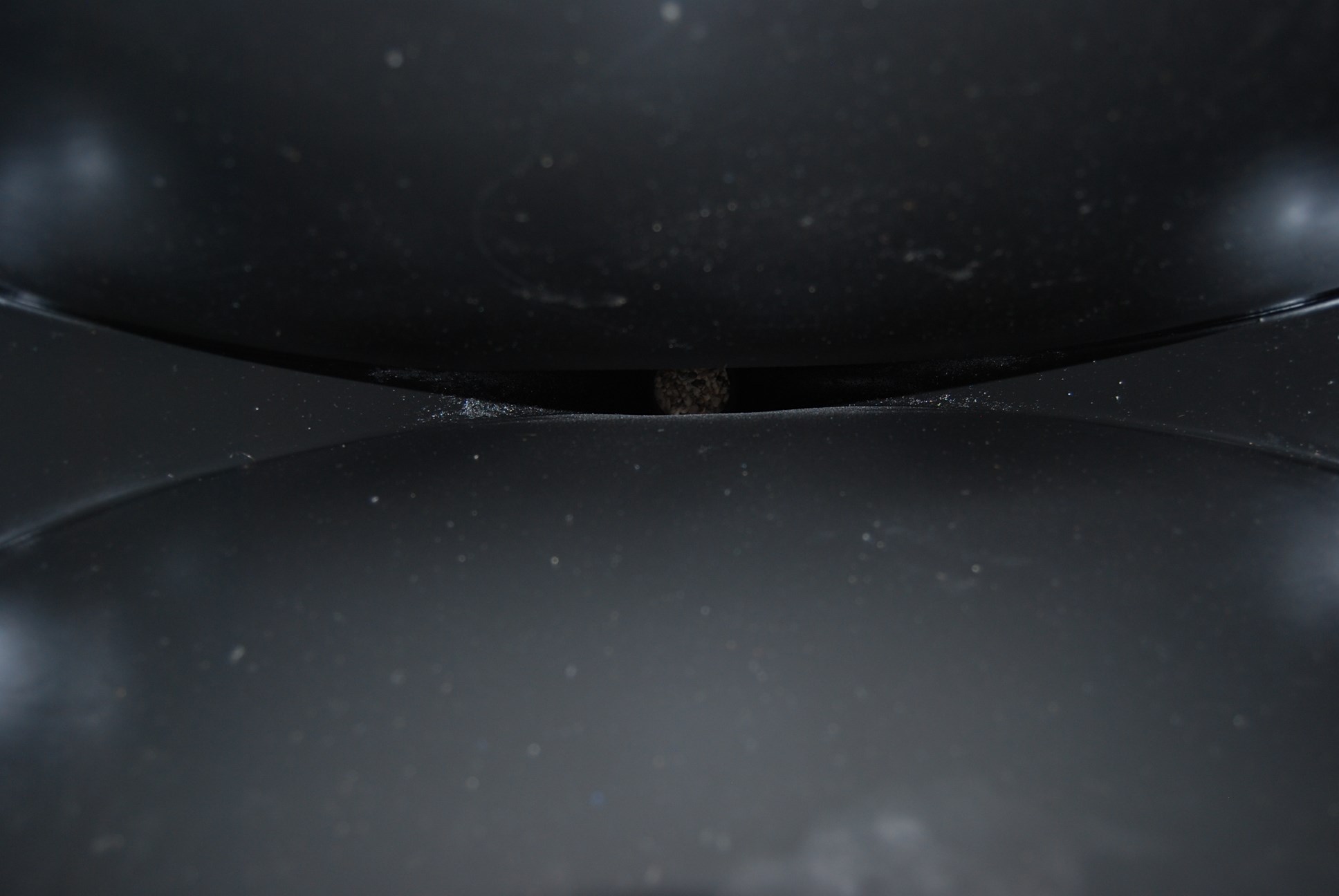

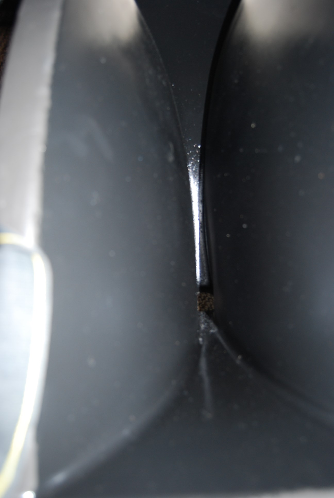

The path does narrow after the throat.

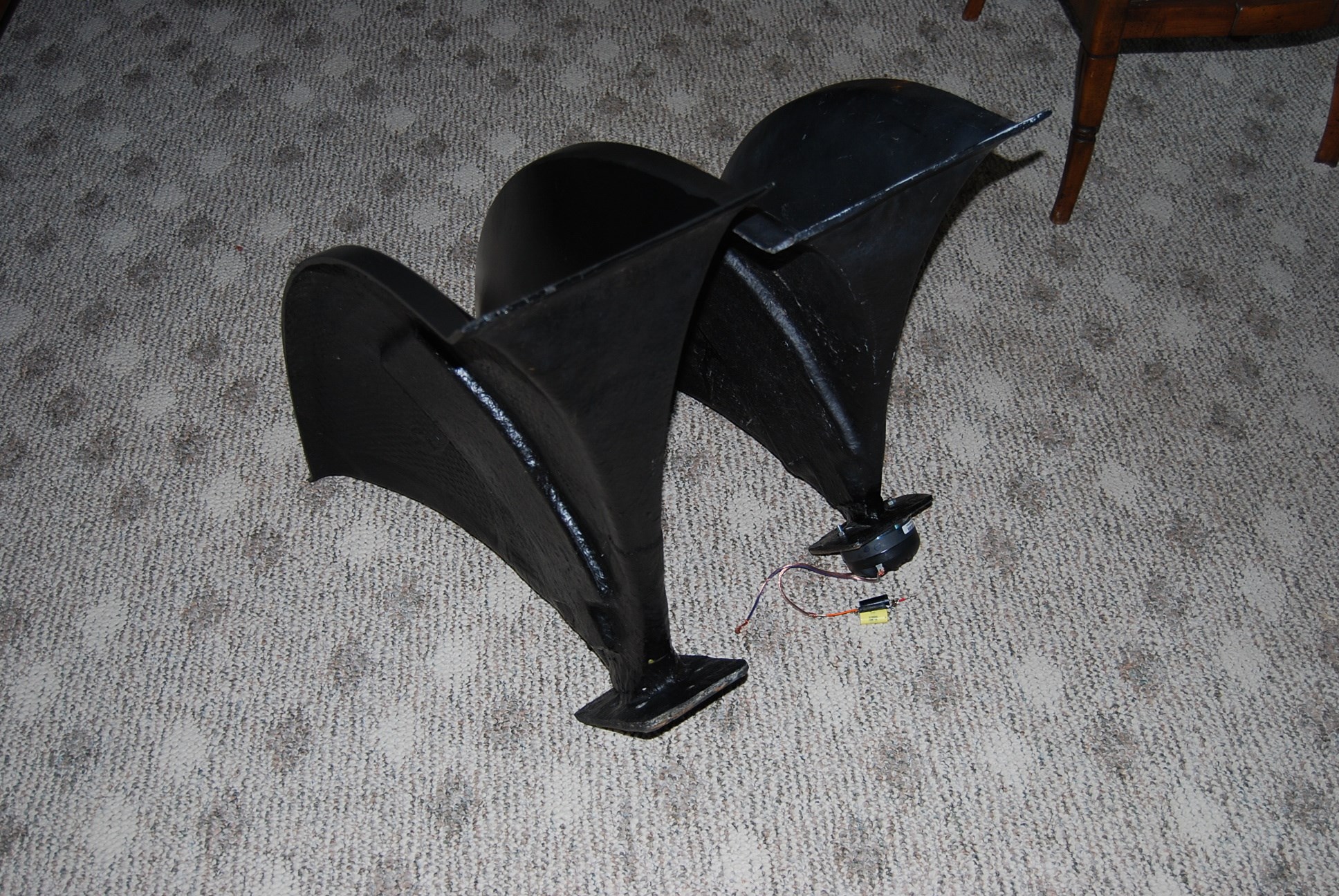

I've got SFW's slightly smaller version of Community's BRH rotting outside my house - too much stuff-- must be 28" from mouth rim center to throat plate - maybe a 2" version in a shed. The SFW with a modest Altec driver had great vocals in one of my old quick lashups with the Karlson - better than my Edgarhorn cone driven tracrix. K-tubes are great if the crossover is high enough.

The path is 'clean', but it does narrow after the throat, which will diffract more than something that continually expands, like with waveguides. Well, any change in wall shape actually diffracts (so, all horns diffract to some extent at least), but narrowing is usually done so that the diffraction will widen the radiation pattern (narrows the aperture) at highest frequencies.
