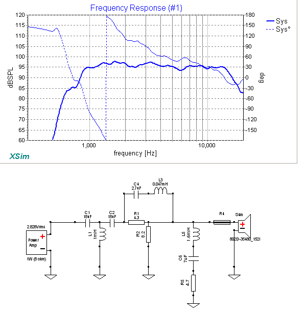

Here's what I've collected through the years.
A closer look-see;
And the GPA 902-8A ( thanks to Zilch );
They are certainly not the smoothest drivers to work with ( but manageable ).
Here's an older 802-8D ( loaded with a 35480 diaphragm ) on the QSC ( 152i horn-clone ).
- This was an exercise in pushing downwards towards achieving a 1K crossover point , with reasonable padding ( while still reaching upwards for usable HF extension ).
attachment.php
