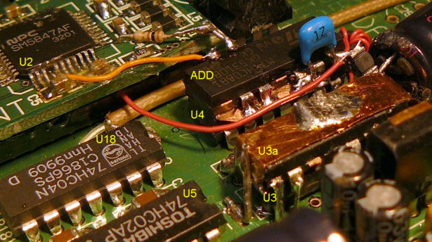

LATCH update in TentDAC

Joseph K said:
Though my second thought would be a little bit of doubt.. I had this suspect just before, (and wanted to tell you, Paul) but now that PAOSU had mentioned a possible level change, it just got reinforced.. I had bad experiences with level changes - usually they are the sign of some malfunction.
But, there is no level change It seems to be so! With my second update today (in the CD624 with the new back end, skipping the SPDIF) I measured the level before and after the update and there is no change. The performance of the change is just my impression, which means that the sound is more gentle to me.
In this present scheme of Paul the LE goes up and down totally in between BCLK pulses, so do not satisfy this requirement? For example, if one BCLK is lost in the process, then that would mean only 19 bit's shifted in, and that would explain the level decrease [though it should be 6db?]
The second rule you mentioned, means that the LATCH should be high at least one clock impulse. Also satisfied!!!
Anyway, it's just an observation, might not be relevant. When in doubt, I usually take a digital full scale signal generated, and look at the scope, if the output really swings +/- 2mA ? (or the equivalent after I/V conversion)
This is precisely what I did.
Otherways congratulations, Paul, as always!
And thanks to PAOSU, you really found out a neat implementation.
No thanks at all. It was all your idea!!!
I attach a photograph of the secod update. Much less photogenic.....

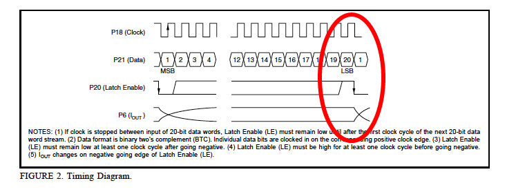

Again LATCH in PCM63
I copied from the NOTES in figure 2: Timing diagram.
(1) If clock is stopped between input of 20-bit data words, Latch Enable (LE) must remain low until after the first clock cycle of the next 20-bit data word stream.
(3) Latch Enable (LE) must remain low at least one clock cycle after going negative.
(4) Latch Enable (LE) must be high for at least one clock cycle before going negative.
(5) IOUT changes on negative going edge of Latch Enable (LE).
My interpretation:
ad.1: LE must remain low (at least) until after the first clock cycle of the next word.
'Remaining low until after the 20th bit of the next word', as in our case, fulfills the rule.
ad.3: In our case the LE remains low for more than 20 cycles, so also this rule has been satisfied.
ad.4: In our case LE remains high for nearly 8 cycles (look at the pictures attached) so this rule has been satisfied.
ad.5: is only a message. It is wise to latch some more time before the first data-cycle of the next word.
All rules has been satisfied.
OK, the rules seems to be more a statute then a technical specification. Luckily I am from a juridical family......
Herb,
Check figure 2 from the datasheet (attached).
I've circled the detail of LE on the 20th bit. This does seem to suggest that LE does need to be kept high for one BCLK cycle.
cheers
Paul
spzzzzkt said:
DR H
you have delayed LE by 4 clock cycles. On the rising edge that is no problem, but the falling edge now occurs 2.5 clock cycles after BCLK restarts, .....
No,No, NO! Look at my picture of the LATCH (the lower one) and the stopped clock signal. LE falls some 8 cycles before the next word!!!
Mind that the picture itself is not for a stopped clock configuration !!!!
Technicians somtimes are bad writers! Certainly if they are Japanese......
The notes begin with: 'If clock is stopped between....', but this does not mean that the drawing is a stopped clock drawing!
Confusing, yes, I agree.......
