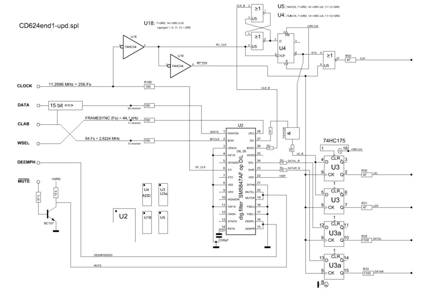

Are you sure that one can reclock all 3 lines simultaneously using CK without any problem?
I seem to recall trying a single 74HC174 to reclock the 3 lines (just one reclock for each) and having severe clicking noises on the outout. Reclocking just LE solved that problem.
Thanks for the idea.
You shouldn't have problems if you are driving 4-6 chips. If your driving anything more than that you'll need to think about buffering the DF clk output - you could do it by using the df to drive 2 gates of a 74HC125 and fan out from the output. If you are running wires to the reclocking chips use a separate wire to each clk input and put something like a 47-100 ohm resistor on each line at the "sender" end.
Hi again Paul,
Don;t mean to labour the point but want to be sure I undertsand your proposal:
Each of the 4 DAC receives 3 inputs.
Are you suggesting that EACH input is reclocked 4 times using a seperate 74HC175 for each, so 12x 74HC175, each wired up so that the signal gets reclocked 4 x?
Sounds like a lot of work!
Also, what would happen if I just reclocked DATA and LE and not BCK?

Yes that would be the best way to go, if you want "deep" reclocking.
Look at the SM5847 and timing diagrams and see what happens if you move LE and data but not BCLK.
Remember that data is clocked into the dac on the rising edge of BCLK. If you shift the data and not BCLK you have a problem. This is the root of problem - you have to respect the timing requirements of the DAC.
If you want a reasonable compromise, cut back to a single flip-flop per line. Just use a single 74HC175 per dac to reclock LE, DATA, and BCLK.

Thanks Paul.
Would it be easier to simply implement your PLL idea? I may not have a good grasp of digital, but I can follow the schematics...could ypu pint me to a suitable one?
Perhaps I'll just settle on the 2-3 times reclocking with '175 as a compromise. This DIY hobby is too time consuming!

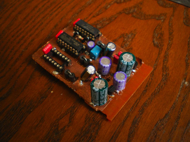

If you want to try out a PLL the simplest thing to do is to use the variant of the Pass D1 PLL I was using initially. It's not ideal but it works pretty well for a small package and is much better than the recovered clock.
The rev2 schematic on the first page of the thread shows this hooked into the CS8412/SM5842
The PLL/VCXO and reclocking circuit comprising U5, U7, U8, U10, U11 and VCXO1 can be built on a bit of perf board.
I put the 2 * 74HC175 onto small perf board adapters which plug into the 74HC86 sockets. These reclock DATA and LE only. BLCK is driven from the output of U10.

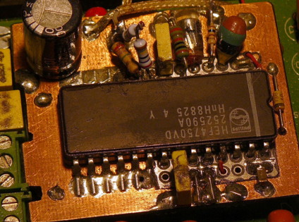

This is the current state of my D1V3 - it's an unholy mess.
It has Jocko's spdif circuit on the far right, a main board with PIC controlled pll and the core of the Tent reclocking circuit, and small board holding the and gate for the reclocking mod, and 74HC175's sitting on adapters.
This is a perfect illustration why I want to get a board designed to hold all this!!

As Herb says, it is essential to send a clean clock from the transport, before starting the 1X (or 2X or 3X etc, reclocking - yet to be discussed here). In this sense, it can be considered as a part of the needed "steps" for getting good reclocking at the end of the day (i.e. being an "attachment" to this great thread).
Paul Herb, George: My deepest thanks to all of you for this great work here!!!!
