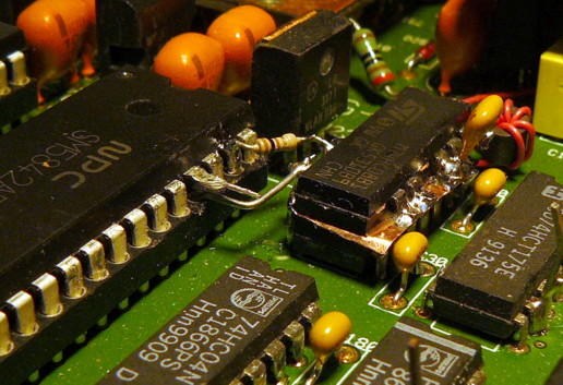

reclocking schema modification
After many email conversations with Joseph K regarding the Tent, Heijligers, et al reclocking schema I've made a small modification which seems to bring positive results.
While the reclocking schema works wonderfully "as is" a question was raised to the effect of "is it really stopped clock operation if the BCLK starts running while the output is still settling?". Using WCLK/LE output of the SM584* results in BCLK restarting 137ns after the falling edge of LE starts the conversion process while the specified settling time of the PCM63P is 200ns. Joseph K made the suggestion that using the DG output would move the falling edge of LE forward by 2 clock cycles giving a total of 308ns before BCLK restarts allowing the output to settle with minimal activity on the chip.
An email from another member containing comments regarding crosstalk caused by LE going high while the 16th bit is loaded from the DF raised the idea of moving the rising edge of LE after ALL 20bits of data have been loaded into the serial to parallel register eliminating this potential source of degradation.
It turns out that the LE which satisfies these requirements can be generated by ANDing the SM5842/7 DG output with the the Qbar output of the 74AC74. The output of this gate replaces the SM5842/7 WCLK.
I'm running a slightly over-complicated 2 gate version of the above rigged in to the FrankenD1V3 and have been quite pleased with the results. Even in this less than optimal setup it seems like there is better resolution of detail and improved imaging. Not a bad result for the addition of a single logic gate.

Re: reclocking schema modification
Gentlemen, thanks for this excellent study!!! I'm working with the 'TentDAC' and measured nearly the same time intervals.
In respect to the specs of the PCM63, the reclocking circuit satisfies. Also I had my doubts about the timing of the LATCH....
I wonder if the 'fast (200 ns) current output (+_2ma)', here called settling time, dictates the LATCH to go low >200 ns before the first intake of the next data word, but it could be better. No cross talk!
The same counts for the upgoing edge of the LATCH which coincides with the down-going edge of the bitclock (at least in my implementations). The data is 'taken in' on the upgoing edge of the clock, so.....
BUT, I agree !! It can't do any harm and it may do some good.
Question: is WCLK the same as WCKO in the specs?
spzzzzkt said:Using WCLK/LE output of the SM584* results in BCLK restarting 137ns after the falling edge of LE starts the conversion process while the specified settling time of the PCM63P is 200ns. Joseph K made the suggestion that using the DG output would move the falling edge of LE forward by 2 clock cycles giving a total of 308ns before BCLK restarts allowing the output to settle with minimal activity on the chip.

Re: Re: reclocking schema modification
Hi Herb,
This was my feeling also. The change in timing does seem to bring some positive gain but my current test setup for the tent schema is probably not the best indicator of it's true impact. I'd be interested in your impressions if you try this mod out.
Yes, WCKO is the correct designation as used in the SM584* datasheets.

Separating Data and Clock reclocking
In the schemes I attach to this posting, the last updates of my CD624-player is presented.
Please pay attention to the U3 and U3a. In the original reclocking circuit of the TentDAC (as I call it) both, clock signals and data have been reclocked in one IC (74HC175). It is well known that the delay in the 75HC175 depends on the voltage on pin 1 and 16: the power supply.
When one looks at this point, the supply-voltage changes with the audio content because the supply current to the Data-ports depends on the audio content!
Ergo, the delay of the clock signals will be infueced by the audio, which introduces audio-related jitter.
The solution (of Henk ten Pierick) is, to use two IC's 75HC175 connected two separated power supply stabilizers.

Question to Spzzzzkt:
Could you exactly point out between which pins of the different IC's the ADD should be connected to delay the upgoing edge of the LATCH, and to which pin its output should be connected? I could find out myself, but I'm an 'analog engineer', and still learning a lot about digital circuits......
Here is the next scheme.
I'm working on the basis of using single gate packages for all the reclocking. This should minimise crosstalk as far as possible.
Inputs to the AND gate are:
pin 27 of the SM5842 (U2 in your schema)
pin 6 of 74AC74 (U6)
The output replaces the existing LE/WCKO, so might be able to patch it in by lifting the DF end of R23?

spzzzzkt said:I'm working on the basis of using single gate packages for all the reclocking. This should minimise crosstalk as far as possible.
Paul
U6 ==> U4 I think. I found out myself already. Thanks again for this marvellous update!!!
What about the supply to the single gate packages? You should have a separation at least between the data and the clock gates.
I hadn't finalised the power supplies but I'll make sure there are seperate regs for clock and data gate.

Last but not least I will show you how simple the soldering is.
I fixed 'the ADD' (74HC08) on top of U4. An earth screen between them. P4 end P5 are the inputs, P6 the output.
I lifted P25 (WCKO) of the dig.filter (SM5842AP) and put a wire in the whole of P25 and connected the other side to P6 of the ADD.
With a 100 ohm resitor the connction between Qbar (P6) of the underlaying U4 and P4 of the ADD has been made.
With a 100 ohm resitor the connction between DG (P27) of the dig.filter and P5 of the ADD has been established.
All connections are very short!
The photograph attached here, makes all clear.
