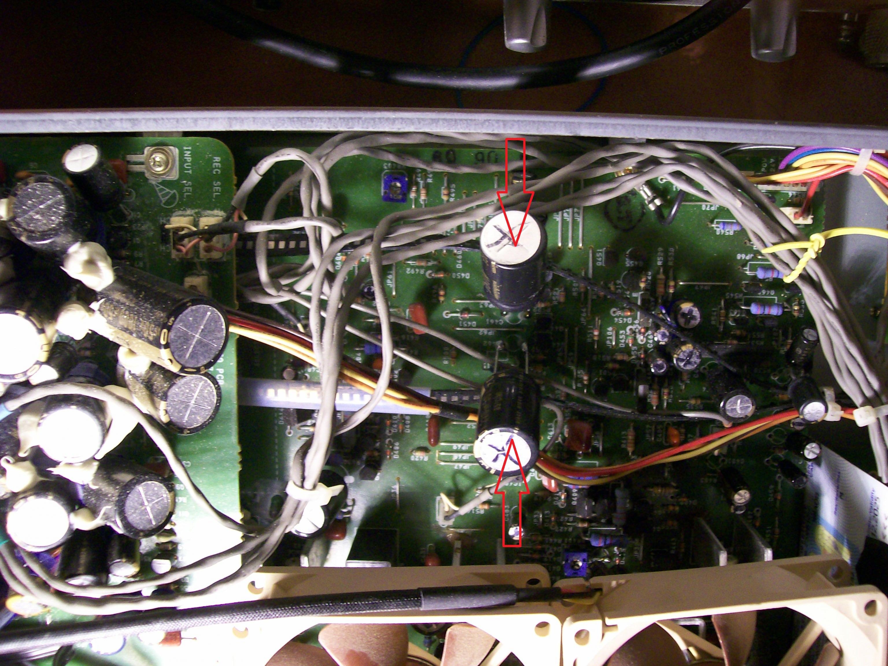

For example a few days ago I changed the 220uf caps from my NAD 306 that are located on power amp boared crossing from Cerafines 25v to KZ 50v.
I also posted a photo with the caps locations.
With Cerafines the sound was a little distorted and blured in high mid-high frequency so my ears did get some irritation
So I swapped the Cerafines out and with KZ the sound is now with smooth high frequency also the mid is very smooth but now the sound is very analytical but is cold .
So just by replacing those two 220uf did make a huge difference

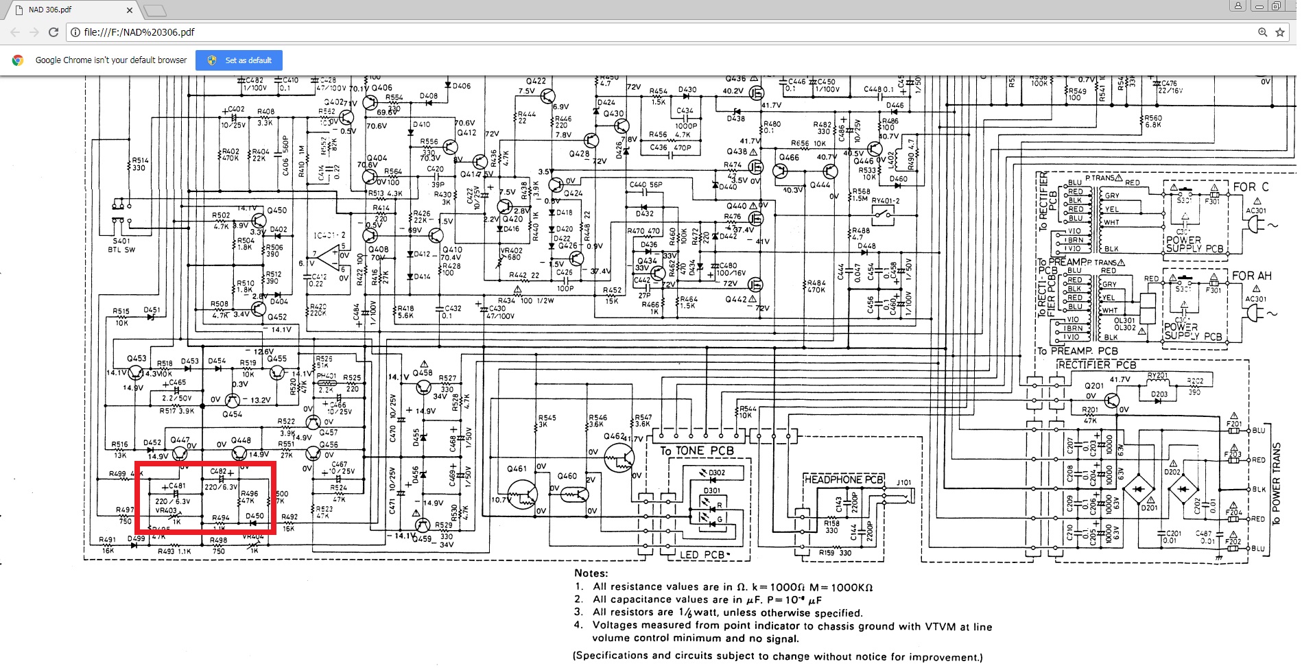

The circuit you have highlighted seems to be part of power protection / switch on delay. If you think that will have a effect on the sound you are really off your trolly and can be safely ignored.

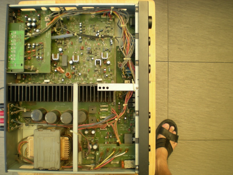

Would be interested in seeing those capacitors in place in your NAD 306.
Any chance of a photo like the one I have attached?
P.S. You don't have to include your foot in the photo! 🙂

I know what I'm doing . The cap placement looks very bad but there is a trick . After the cap was soldered I applied a special glue on the back leads so they are glued on the front board . If you watch closely the photo you can see that there is glue there . I did this to change those caps on the fly .
Also many times the cap will not fit .....so without special glue on the front board there is great risk of the leads messing the board because they are not fixed .
Exactly! This was pointed out to Robert2017 previously on another forum. His argument as to how replacing these caps altered the sound: Because they connect to other parts and "interact".
Robert2017 should just be ignored. What's annoying about this is having to correct all the misinformation people like him spread. NAD gear is a cut above the standard consumer fair, but swapping out some or all of the electrolytics with audio grade can not cause the changes he claims.
If Black Gates made such a huge improvement, they would still be in production. Every high end company would be buying them. Robert, resistors make a difference too. Time to replace those cheap ones in your NAD with expensive audio resistors?

Hi robert2017,
Glueing the parts isn't an answer. It also make further service on the unit more difficult to impossible without damage to the PC board. Normal sized parts are available just as high (or higher) quality than the originals. The oversized can also radiate or pick up noise or signals from other parts of the circuit. Highly undesirable, and certainly audible if your listening skills are even half as good as you claim them to be.
Oversized components are a failure. Plain and simple as that. This is also true where components are wired point to point.
