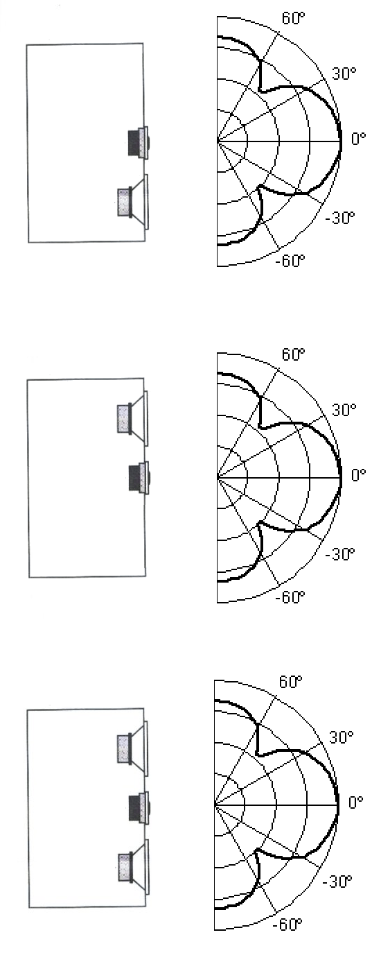

And i think i know from where the confusion come from: the tilt observed in TM or MT for the on axis behaviour.
With MTM there is no tilt, the 0* axis is the tweeter axis.
With TM/MT there is a tilt upward or downward and as such is not directly on axis ( as clearly shown in your sketch). I understood this is why you were bothered by the 3D rendering too as it display the correct overall shape but without the tilt 'clearly' figured ( i suppose the front/face of the MT loudspeaker could have been angled backward in order to compensate for it, but i will never know as this rendering are from the internet and i have no more info on them).
In the Biro article the vertical plot ( of TM) shows it much more clearly imo.
Am i on right track?

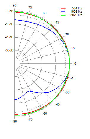

1/4 wl spacing, in phase on the 0 degree axis gives a single lobe which is -3dB at +/- 90 degrees.

Now you have posted a sketch that IS incorrect. This topic does seem to confuse you. 🙂
I think maybe you have an inherent misunderstanding of the radiation characteristics and/or your understanding of the terms is incorrect.
The lobing characteristics of MT versus MTM configurations have been understood for many decades. I don't know why this should be confusing at this point in time.
Anyways, I thought the topic of this thread was an MTM configuration????????? (That's the context that I'm viewing the posts in.)

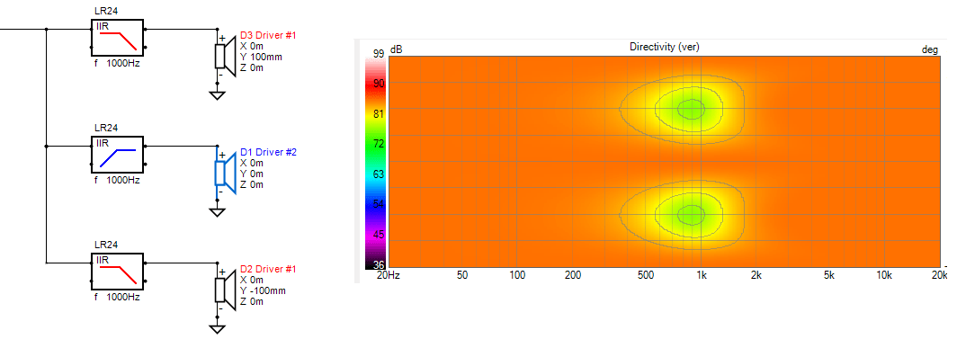

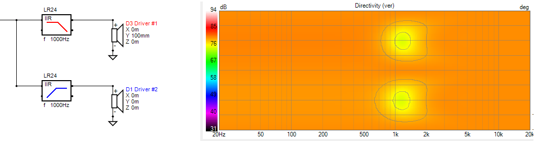

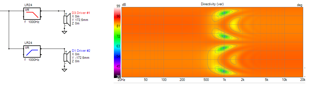

I've used Vituixcad to show that the nulls are present and are at the same angles for both the MTM and non MTM versions.Now you have posted a sketch

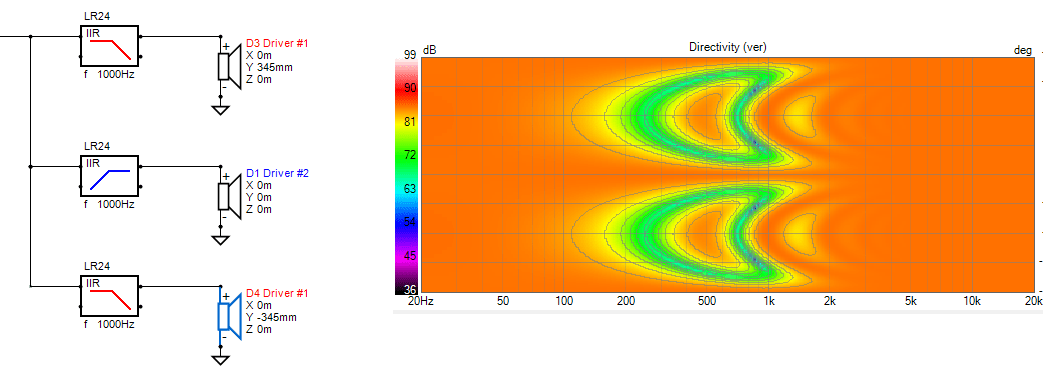

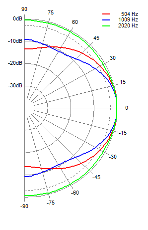

Distance 100 mm mean wave length about 3400 Hz not 1 kHz.I've used Vituixcad to show that the nulls are present and are at the same angles for both the MTM and non MTM versions.

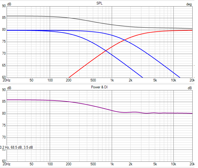

Yes. Here's 1 wavelength. The crossover lobing is still there but you have to separate it from the directivity caused by the woofer spacing.
Rather than digging yourself in deeper, why not just go back and correct your depiction in Post #83?
