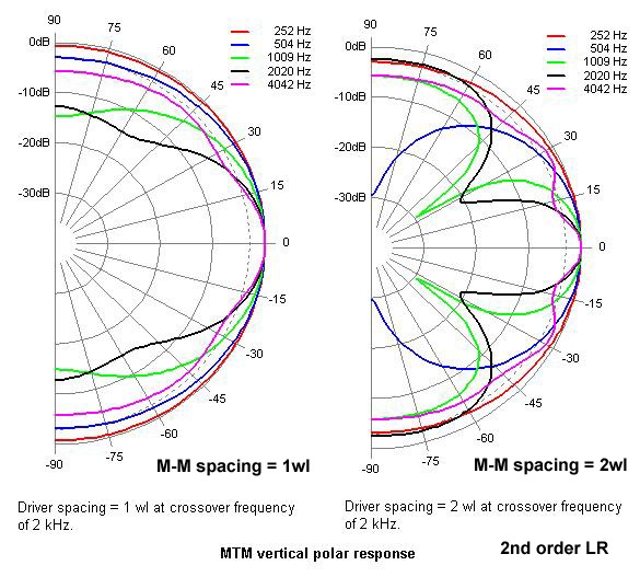

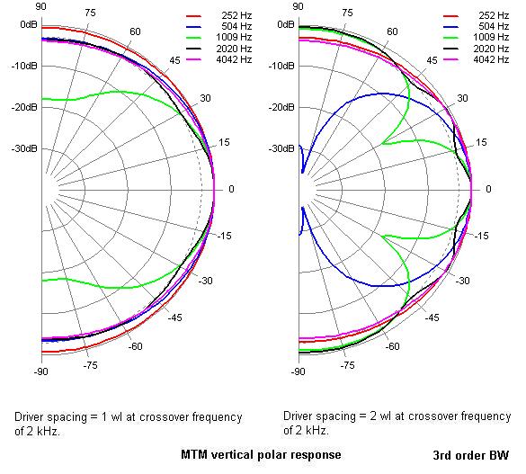

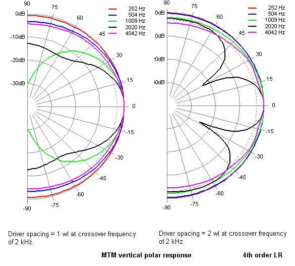

I do not remember the source but I have these graphs that compare BUT and LR filters. Maybe someone here could 'decode' what they're supposed to mean (good / better / best etc.).. in theory MTM LR will have no benefit with regards to crossover lobing....
Ok. Take a look at the crossover, so just look at the black traces since they are for 2kHz. All the Butterworths have fairly even vertical response and all the LR have nulls above and below.
The nulls are what normal lobing looks like in any case. Since the Butterworths are not symmetrical, flipping the lobing pattern tends to fill in the gaps. LR is symmetrical to start with, so flipping them makes no difference.

The slopes are symmetrical around the crossover frequency, but the lobes aren't symmetrical around the 0 degree axis. The reason is phase, which is symmetrical and it tracks, but with a fixed 90 degree offset.
looking at the picture of the BUT18 at 2k crossover, one WL CtC spacing : the lobbing seems symetrical on a large frequency flat magnitude (spl) in the vertical 15° around the axis point. Looks good to me. What do you think ?
@newvirus2008 , What are the dotted line, please ? -3 dB i.e. beginning of the non flat magnitude below that dotted line

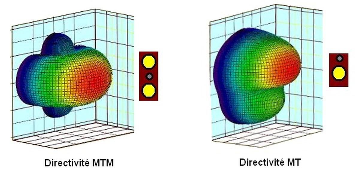

This 3d graph should help clarify things about directivity behaviour.
If you look at the vertical polar Newvirus linked you will quickly identify what they mean once in 3D.
As was already stated the horizontal behaviour is the same as for a single driver ( high end will depend of the tweete/horn own behaviour though).

krivium, thanks for the plots. They show the 3d nature of it.
However I'm concerned they could be misleading in answer to diyiggy's question and would like to ask for clarification. I'd expect the polars to be the same for MT and MTM for a symmetrical crossover, exactly at the crossover frequency, when the drivers are at a directivity match... What you've shown looks like it has other factors going on.
Yes this pattern are not focused on any frequency, they represent the overall directivity shape in 3D and the colours used the relative SPL.
I don't know what kind of filters were used either for MTM or TM, that said as i played extensively with simulation of MTM in the past i'm pretty sure the filter used here is 18db/ octave for MTM.
As well it should be noted the colour pattern is equal to intensity ( spl) and gives an idea of the recommended listening axis but doesn't take into account the directivity behaviour of the tweeter. To say it differently it was simulated with ideal omni driver behaviour. In reality if a waveguide was used the overall shape would track the waveguide own directivity rather than the overall shape presented here.
But with all this limiation in mind i've found it is interesting 3D rendering nevertheless. It made me understand why it is often recommende to listen to TM either on tweeter axis or a litlle below. As well why people insist on the symmetry of vertical behaviour of MTM and why you should listen them with tweeter at ear height ( at least in close proximity).
