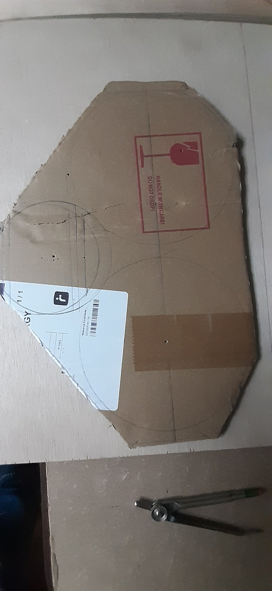

Sligthy off topic but still in the crossover and layout discussion,, what do you think about that pattern with two 15 cm midwoofers and a 10 cm tweeters if listened far field near 3 to 4 meters ? See picture... of course the baffle step must be commpensated. I have hard time to sim that due to the baffle shape.
Theorical advantage : closer edges and closer CtC between all the drivers. Theorical disadvantage : tweeter is not vertically aligned with the woofs.
Thougths ?

Except in very large room at 3m you most listen to the room than the loudspeakers themself.
That said i don't get your concerns about driver's merging: with well implemented mtm it works close distance ( with Kino i didn't noticed anything more than the horn own vertical coverage limit up close - less than 1m away) and is maintained in the farfield ( it's the whole intersting point regarding the 'point source-ness' of the principle).

@krivium, I should have said in my illustration the CtC is still between 1 to 1.2 WL at crossover point because not big 15" and horn as the op. So the cut off in that illustration is near 1900 hz... My point is to reduce the honey comb behavior but maybe it is a lost cause ?

If you have T and M within 1/4wl, do you need MTM?
It can be of help to mitigate floorbounce if the M drivers replay frequency involved in the floor bounce, depending on sweet spot location and overall loudspeakers dimension.
