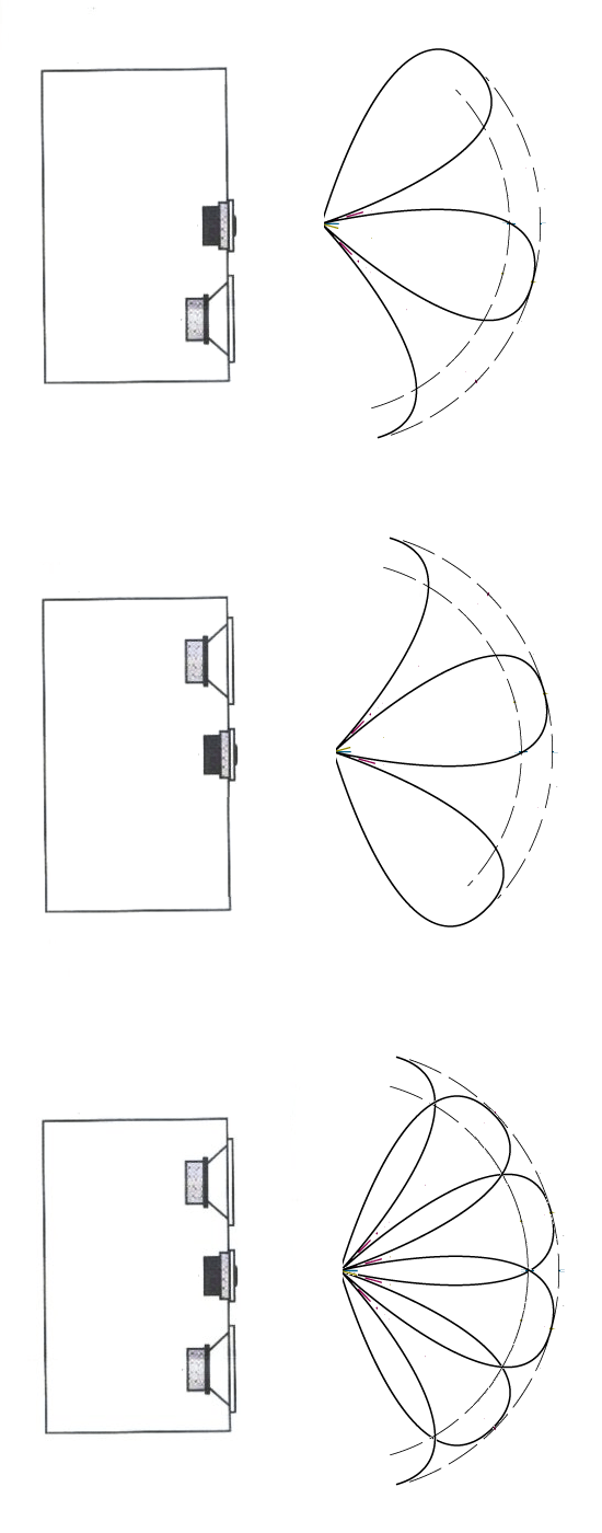

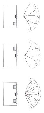

This is the part I suggested was misleading. TM itself is not asymmetrical as shown.. unless you begin to consider secondary factors, which can apply to either configuration in any case.It made me understand why it is often recommende to listen to TM either on tweeter axis or a litlle below.
Not sure what this means or why it is a concern.As well why people insist on the symmetry of vertical behaviour of MTM
In an MTM, MT gives lobing which is the mirror image of the corresponding TM.that you can measure an MTM and then flip it upside down and measure again

Well, i don't find your sketch misleading at all.
In fact, i think it gives a nice explanation of what happen:
If you take front lobe or tm and mt and you sum them up, then you obtain a larger one which ls on axis with the tweeter.
Now If you take the secondary ones ( both pointing downward and upward) of both tm and mt and you sum them too you'll end up with the typical UP and down lobe and the 'notch' In directivity circa +/-30* you find in vertical plots of MTM.
Iow you juste explained the overall shape seen in the 3D rendering imho.

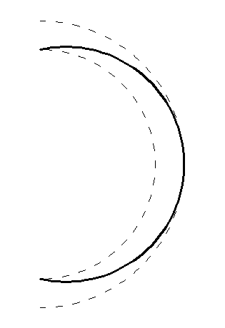

Your sketch is just fine. But it doesn't demonstrate your premise.
The bottom one clearly shows a symmetrical MTM polar pattern.
