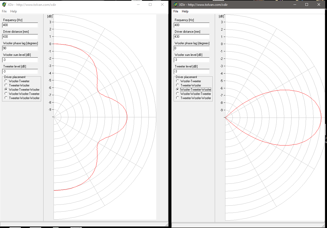

wanting to try a d'Appolito crossover on an MTM speaker with IIR DSP.
woofers are covering only 2+ octaves 80-400hz, large horn with coax CD above
1. develop LR4 crossover slopes
2. time align the drivers using digital delay
3. adjust the delay by 1/4 wavelength at the crossover frequency
is it that simple?
You don't need to perform step 3.
When performing step 2 reverse the polarity of the tweeter and adjust your digital delay to achieve a deep interference null at your chosen crossover frequency.
Then change polarity back for normal usage.

B&C ME464 with 15" woofers. CTC spacing will be approx 1/2WL @ 400Hz.
BTW, here are lobing errors at XO with 1/2WL spacing and a zero/90deg phase shift. I understand the 90deg phase lag is the real "d"Appolito" alignment, traditionally done with 3rd order crossover to get the shift. But the pattern should be independent of the XO slope and dependent only on the phase at XO.

Using 18dB on woofers low pass ?
I am wondering also for a smaller MTM (5.5" and 1" - eventually with a WG). Seems D'Apolitto used LR24 later and didn't mind because of the far fieeld listening >=2.5 metrs in most living room ?

And no you don't need 5m for them to sound coherent, it's the whole point of mtm 'simulating' point source behavior. If ctc spacing is 0.333 wl then they behave as one source only.

Butterworth gives you 90 degrees with no effort required, as voodooless says.. but as you say, it doesn't matter as long as you get the phase shift. Are you using a crossover simulator, because you can usually fudge these things in unexpected ways by making small adjustments?
