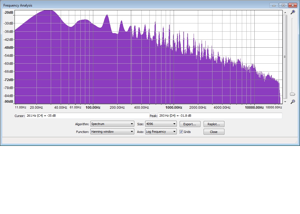

Looking to build a sub. 20hz is always people's goal, but surely 40Hz or so is more realistic, even for hip-hop/electronica?
No sense chasing notes that don't exist anyway
If you are building a subwoofer for home playback of recorded music, what's a reasonable cutoff? From what we've seen so far, mid 30s is plenty. Even with EDM, a solid 40Hz would be OK. Work on getting a clean, solid 33-35 Hz and you've got it covered. Chasing lower notes may be a waste of resources. Boost the bass level if you want that club sound.
well for good modern classical recordings if you want to get the sense of space you might want to consider lower. attached is an analysis of a recentish Chandos release on 5.1 so without the normal LF roll off that red book releases seem have. There is significant energy down to 11Hz and possibly more.
