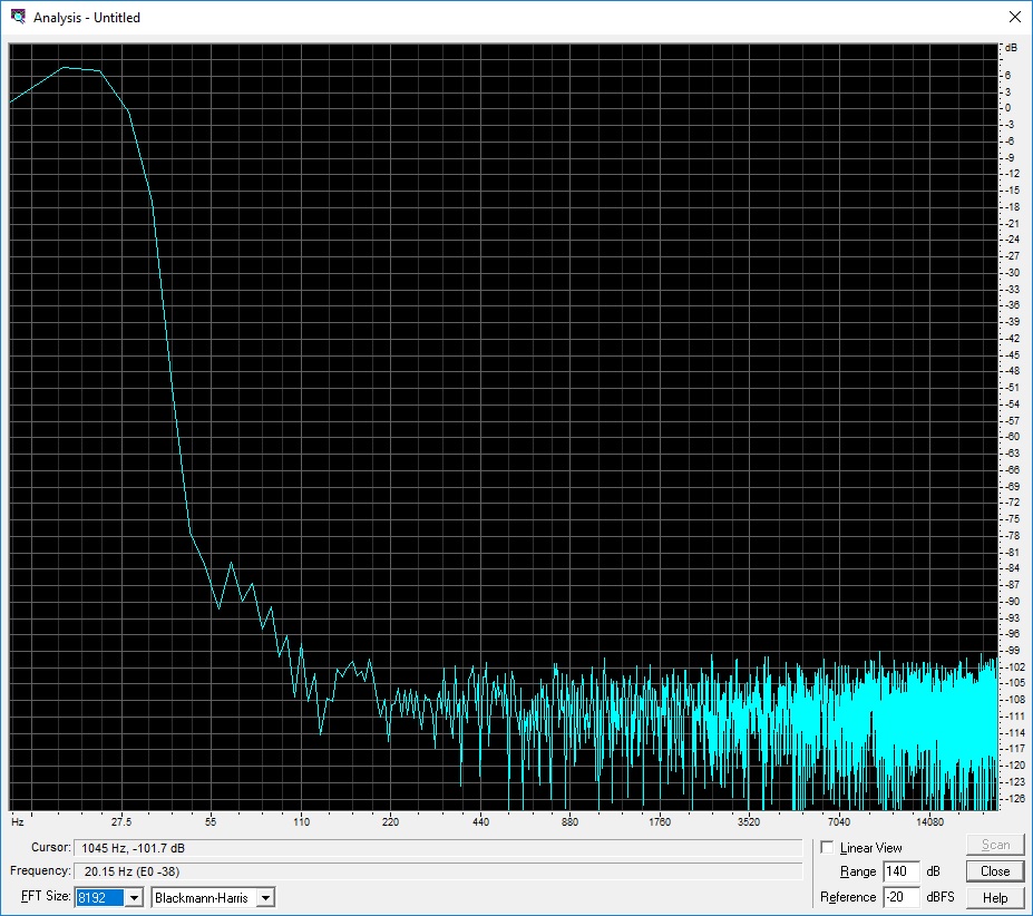

Hey guys, looking at the Audacity spectrum analysis for the mentioned Chandos release, I see the window size was 4096 samples.
Is that the favored size to use for checking for bass content?
I see things look quite a bit different as I increase sample size on tracks I've looked at, most often accelerating bass roll-off.
Bit of a newbie here....i get the sample size to freq resolution relationship....but just wondering what folks find works real world...thx
Good point. I will re do that tonight with a larger window size and see what that changes. Not sure how I missed that at the time.
Yes, my understanding is, the larger the sample size, the more resolution at lower frequencies, resulting in a more accurate representation of what's actually going on down there?
It's window leakage/skirts displayed on a log scale that can fool you into thinking there is something there. A 20Hz tone at 8192.
I'm comparing with other recordings with nothing there though. Always happy to be wrong though.
Well your plot doesn't look like much I've ever seen, expect maybe pink noise. 🙂 It's an interesting track. Would love to see it with more FFT bins.

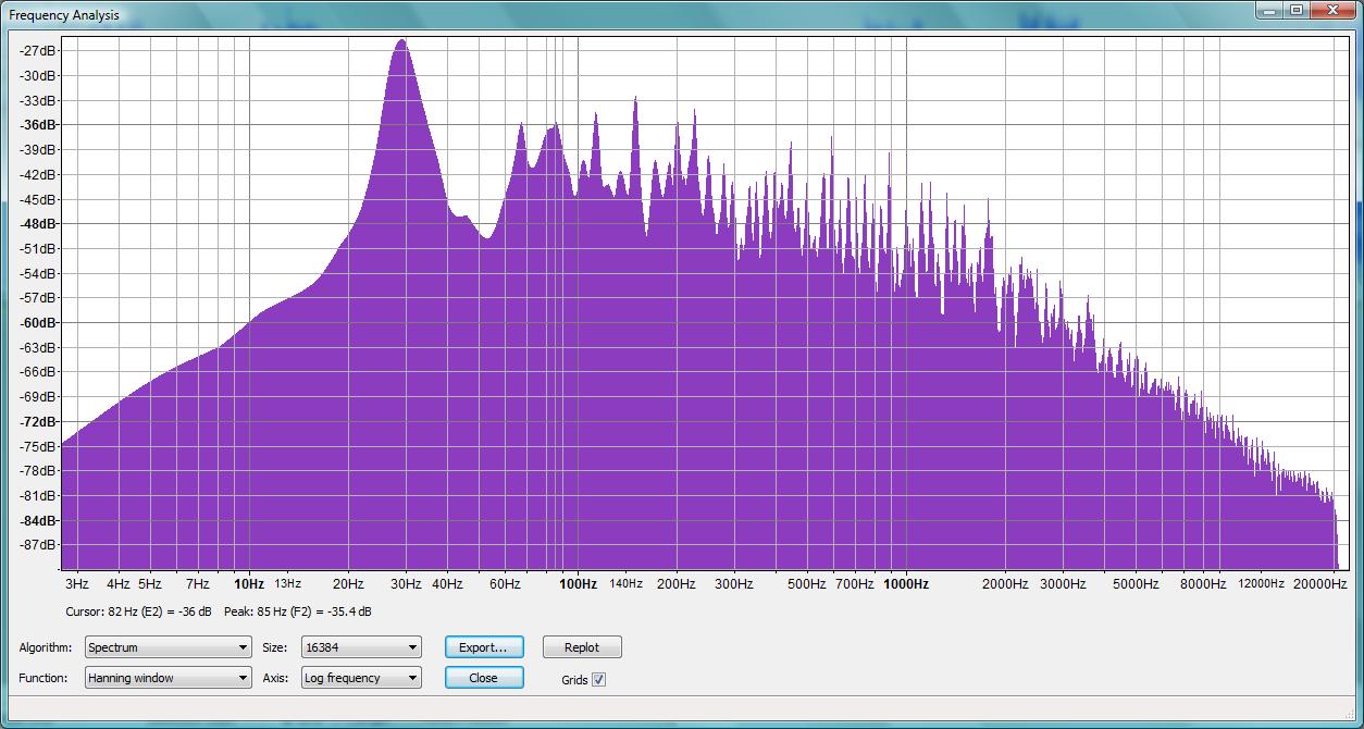

Here is a helicopter that I recorder back in 2008, when it flew above my house when I recorded a rain. Sometimes I use it to test or demo my setup.
http://wavebourn.com/rain_helicopter.mp3

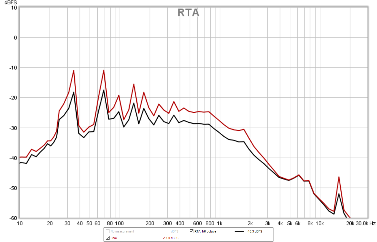

Interesting track. Big peak around 35 Hz, but rolls off rapidly below that. First image is an RTA with infinite averaging (using REW) of the contents of the MP3.
As an aside, I've found that most music that sounds "good" on almost everything seems to have a fairly consistent content curve when RTA'd - a smooth slope upwards from 10kHz down to about 200 Hz, then a more rapid increase up to 50~60 Hz, then shelved downwards, sometimes pretty quickly, after that. Music with more content at 40 Hz rather than 50 Hz for example actually sounds like the bass isn't EQ'd right. But that's just my opinion. The second image is an RTA capture of a psy-trance track that sounds good on almost any system I play it back on. I think that there's an untapped market for "content" EQs that EQ the content before it's passed on to the rest of the system to reproduce - PAS Graphic Equalizer Studio 2018 is capable of doing this, and it works quite well.

What microphone was this recorded on? Helicopters produce very low (single digit) Hz IIRC, so the fact there are the big peaks but then not much below 35Hz makes me wonder if the mic was rolling off.Interesting track. Big peak around 35 Hz, but rolls off rapidly below that. First image is an RTA with infinite averaging (using REW) of the contents of the MP3.
