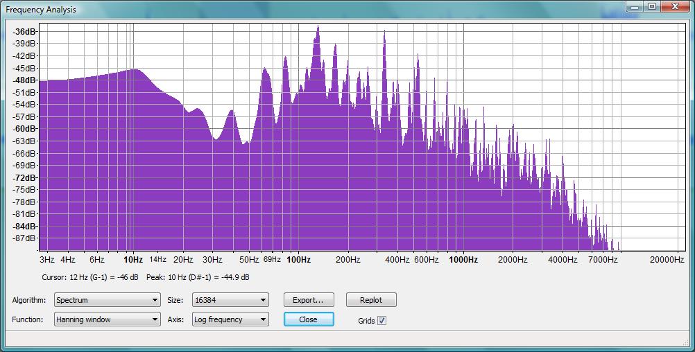

ok here is a recording done in the new purpose built hall in Glasgow. If anything it's even odder. The linear plot shows peaks down to 3Hz but you can't expand the scales to look closely. If anyone has better analysis sw I'll send them a chunk to look at.
This level of subsonics is daft though. I suspect audacity but might right to Chandos and just ask them the question!
I THINK that is because square waves may have senoidal components in the 3Hz spectra, depending on what type of mathematical transform is used in the analyses. Well it might suit a subsonic speaker workable basis but just for casual ringes down to a component part not a really sounding note...

Odd indeed! I have some other ways to analyze and would be happy to do so. Send me a PM and we'll see what we can find.ok here is a recording done in the new purpose built hall in Glasgow. If anything it's even odder.

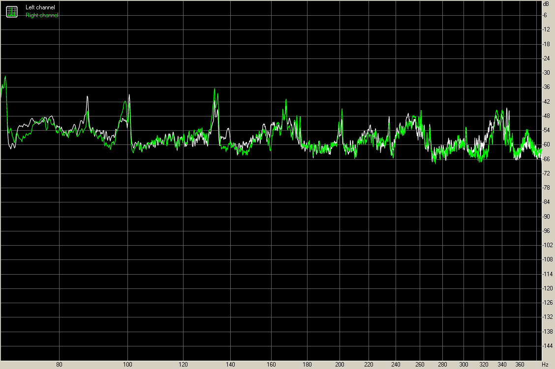

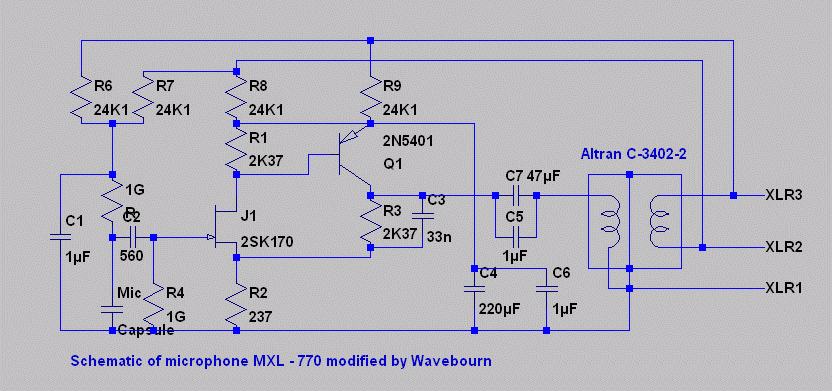

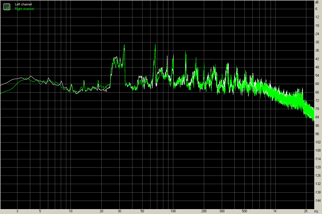

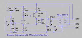

What microphone was this recorded on? Helicopters produce very low (single digit) Hz IIRC, so the fact there are the big peaks but then not much below 35Hz makes me wonder if the mic was rolling off.
I don't think so. There were my microphones, directly connected to Tascam DR-100
It is obvious that the helicopter produced almost 35 and 70 Hz, the rest was way below their level.
0.3 Hz corner frequency for input RC, 80 Henry primary of the transformer, 22 mm capsules from MXL-770 microphones.
Well; the capsule itself has about 100 pF capacitance, loaded on 0.5G - is it about 3 Hz -3 dB frequency?
Yep, looks like 35 and 70 Hz was what the helicopter produced.
What is clearly shown with a longer FFT is the Blade Pass Frequency (BPF) single component and it’s exact harmonics up to the 11nth:
33.5Hz, 67Hz, 100.5Hz, 134Hz, 167.5Hz, 201Hz, 234.5hz, 268Hz, 301.5Hz, 334Hz, 368.5Hz .
The waviness is again of a period corresponding to the BPF.
BPF=main rotor’s RPM * No of blades / 60
For 2 blade main hub, rotor rpm=1050
For 3 blade main hub, rotor rpm=700
For 4 blade main hub, rotor rpm=525
The BPF is the lowest frequency main aerodynamic component.
http://www.dtic.mil/dtic/tr/fulltext/u2/684394.pdf
https://ntrs.nasa.gov/archive/nasa/casi.ntrs.nasa.gov/19880017523.pdf
