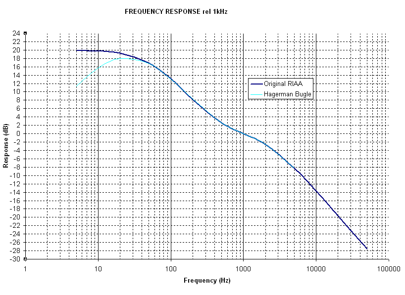

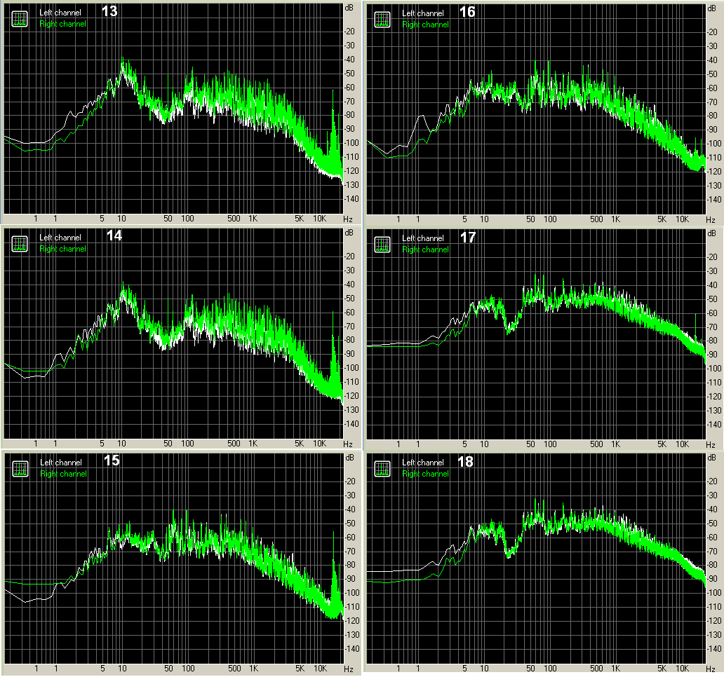

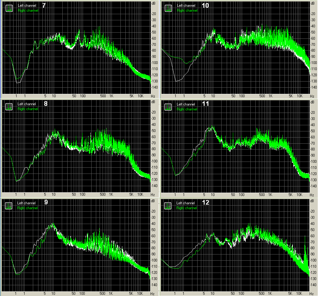

Some vinyl transfers that have survived.
FFTs are from the 1st minute of each. The 1812 has an extra one to incorporate the canons.
All transfers were done on the same system
There is even more LF energy than shown (the Hagerman Bugle RIAA preamp that was used, has the IEC/ LF roll off incorporated)

7 Mahler Symph Nr9 Dimitri Mitropoulos-NYPO Replica RPL2460161 Carnegie Hall Jan 23, 1961
8 Mahler Symph Nr10 Dimitri Mitropoulos-NYPO Replica RPL2460161 Carnegie Hall Jan 23, 1961
9 Berlioz-Symponie fantastique Mitropoulos NYPO CBS-Odyssey 32 160204
10 Prokovief Romeo & Juliet Mitropoulos NYPO CBS-Odyssea 54019
11 R Strauss Elektra Mitropoulos-NYPO FONITCETRA TRY07
12 DG??
13 Mussorgsky Pictures at an exhibition SUPRAPHON 1110 0570 G disk non washed
14 Mussorgsky Pictures at an exhibition SUPRAPHON 1110 0570 G disk washed
15 Tchaikovsky 1812 DECCA SPA 108 disk non washed
16 Tchaikovsky 1812 DECCA SPA 108 disk washed
17 Tchaikovsky 1812 DECCA SPA 108 section with the canons disk non washed
18 Tchaikovsky 1812 DECCA SPA 108 section with the canons disk washed
>Edit: all records were 33.3rpm vinyl

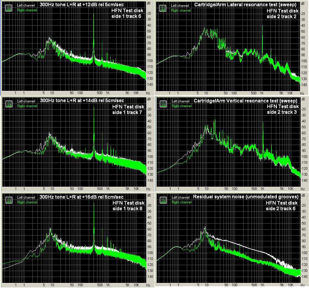

Thanks for those George. Plenty of info there. I see a broad peak of energy between 5-10Hz on most of these. Why do you think it's there? Cutter noise? Playback?
If you look at the last block you have the results of resonant tests and that looks mainly to be horizontal resonance. The 20Hz vertical peak doesn't show in music which is interesting.

Well spotted. Tho it looks slightly lower in most of the music, maybe that's just down to how the test disc is set up.If you look at the last block you have the results of resonant tests and that looks mainly to be horizontal resonance.
If you look at the silent groove test that gives you the amount of low end just generated by the cartridge/arm system just sliding along. Program material seems to be just a few dB above that, so little to none was cut in is my take (and expected).
The musical content excite the arm/cart resonance a little bit differently each time (due to freq bandwidth and amplitude variations of the music) but not very much. The 5Hz to 20Hz bump due to that resonance is evident in the LP recordings but is pretty stationary (for each playback system)
Those vinyl transfers show a lot of differences at the LF end and this is not due to the playback equipment. The larger the recording venue and the less the close miking, the more present is the acoustic signature of the performing space.
When I HP filter large orchestras and opera live recordings, I don’t enjoy the outcome as much as the non filtered . I have tested it so many times that I have made up my mind on this.

But if you look at some of the FFTs, there are four performances at the same hall (Carnegie), two on the same day, yet there are different low end skirts due to different musical content (excitation).
