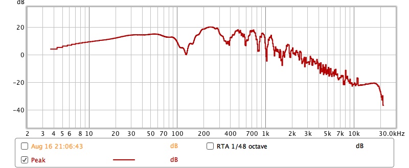

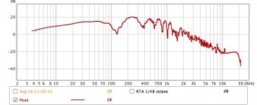

Thanks Wavebourn. And Pano is absolutely right. Here's the RTA. (The peak at 200 Hz might be clipped a few dB.)There is some good low frequency energy there, for sure. Lot's of mids too.
While the Danley recordings are relatively heavier in the bass end, this firecracker is pretty much a Dirac pulse or a square wave. Really sounds swell on my 12 Hz 17-foot pipe.
B.
I meant clipping in conducting my RTA, not your WAV file, as you say.No clipping was possible...
BTW, I'm all digital and I have some rudimentary grasp of dots-and-dashes. But I often see the overload lamps flashing on my DSP and hear the results. So I believe that real-world digital devices can be operated in a way that they do run out of headroom, whatever the theory may say to the contrary.
B.
Yes, they can, but if they claim 120 dB dynamic range I can run recording on peaks 20 dB below clipping. It is what I usually do, also the limiter is always on.
I don't see what a limiter can help you during recording. If it is set to slow, it will not prevent clipping during a sudden pulse (e. g. fireworks). If it is set to very fast, the limiter itself is what will cause the distortion instead of the clipping.
