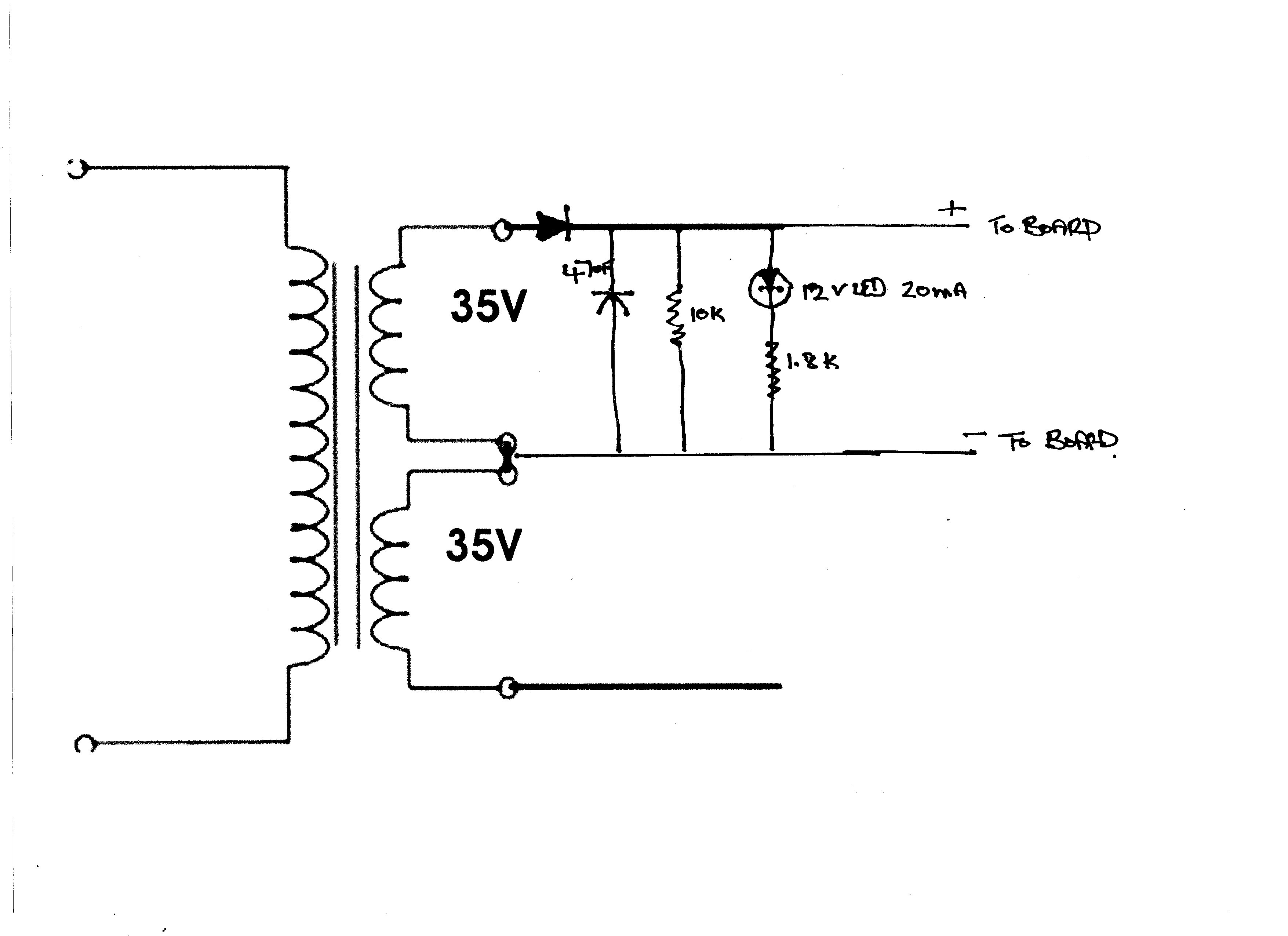

Hi, just to make sure this old brain of mine is working (or not) will this work with the original boards. I think it is what you have described in your reply to me. Also, would it hurt to use a smaller pF cap - say 22pF for even quicker shut down?
Thanks Keith
Thanks Keith
22pF is an RF filter cap! It won’t smooth 120Hz rectifier bridge ripple much.
The SSRs need about 20mA and you can do the math to see how long a 10uF or 22uF cap charged with the secondaries will provide at least 18vdc. Below that, and circa 5vdc or so, the SSR shuts down. We ran simulations and found that about 22uF gives enough ripple smoothing and shuts down quickly. Try 10uF or 4.7uF and see if it works. If it’s too low you might hear the 120Hz modulation in the SSR.
Sorry a typo I did mean 22uF, but my main question was, with this simple psu, will it work correctly and switch off speakers if there is a DC fault in the output even if I'm using just one winding?
Yes. The DC fault is independent of what you are using to power it. The DC is detected by an optoisolator. It’s isolated from the supply voltage. The supply voltage using the small 22uF cap will shut the SSR off in about 100milli seconds.
You only need about 2mA for LED. 20mA will fry it.
So for say 50v supply, use circa 22k to 25k resistor.
The spec for this Halo LED incorporated in a switch is 12v at 19 ma. Just checked the current, and it does draw exactly 19ma. So are you saying then that I could use a separate dc power supply independent from the amp supply and the boards will function as normal. Please bear in mind that I am talking about the first version of the boards and not the latest one that you are currently offering.
Oh, this is to light up your on/off LED front panel switch. Ok. If it’s set up for 20mA that’s fine. You will be drawing 20mA more from your SSR Gen 1. Gen2 is probably about the same. I have not measured yet. So the small capacitance PSU needs to supply 20mA to LED along with 20mA for SSR. 22uF should be fine.

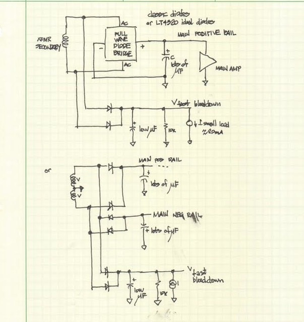

Won't Keith's circuit pick up one half of the power sine wave only?
From the Instant Shutdown Mod circuit sketch, two rectified voltage feeds are shown for a centre tapped secondary. So, is losing half a power cycle OK for operating stability of the SSR?
Wouldn't it be more reliable to simply add in the extra diode? Or have I got my wires crossed?
That's why I was querying whether my circuit would actually work - for me, it was just about halving the supply voltage to the board, using both windings would put the voltage close to the max operating voltage of the board.
I only used 1 winding. You only need 18v or more. More just dissipates more heat on voltage regulator.
Yes, I would add another diode for a full wave wave bridge of using both windings.
These were the schematics by Jhofland earlier in this thread:
