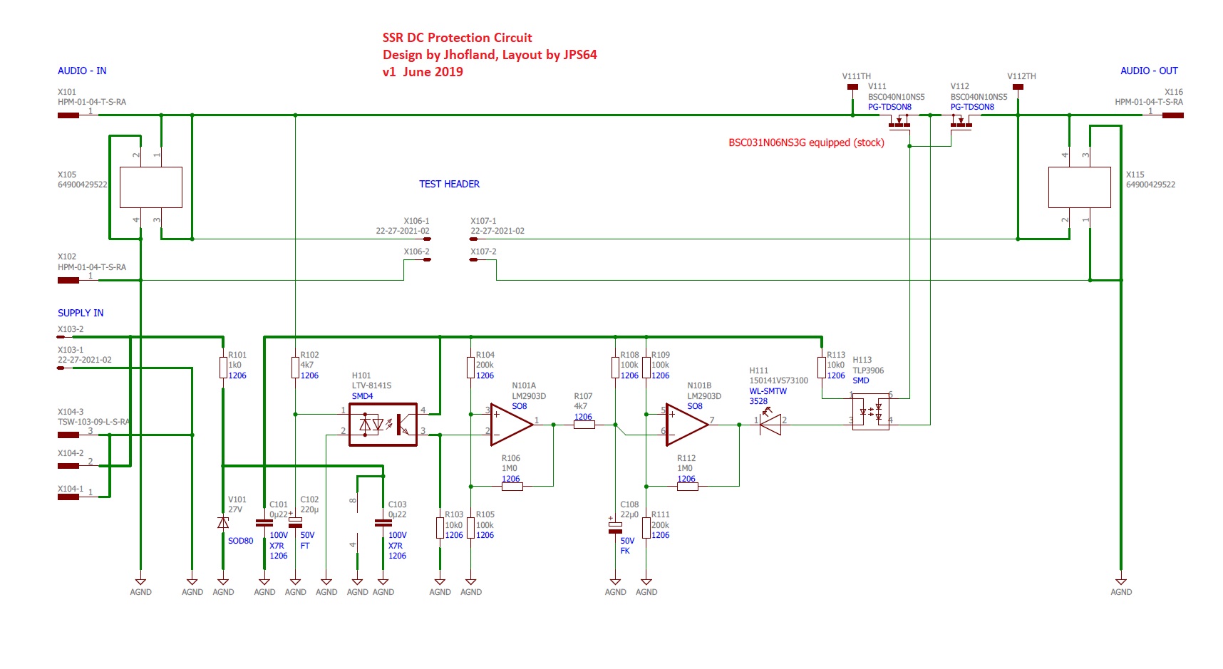

This protection could be good for a circlotron ?

I don’t understand your circuit as the speaker is placed between two -35v rails of two power supplies, and the outputs drive those connections.
The Gen2 SSR is designed to withstand global DC offsets like that in a BTL amp since the speaker input and outputs are optically isolated from the power supply and are “floating” relative to PSU ground. So a BTL amp that would have Vcc/2 at the outputs all the time could work. The DC is detected relative to the two speaker output terminals. So in this case it will have to go after the node where the two PSU negative rails and output stages connect. Basically right before the output binding posts (like in most amps). But, yes, it should work.

In theory, If I wanted to extend the delay of the gen 1 SSR to 30 seconds or so, what value would I need for R8?

There is a 2-3 second turn on delay that should help to avoid turn on thump. If you need a longer delay, one of the RC time constant components (R108 or C108) can be made larger. Generally, the resistor is the easier one to change. Presently, R108 is at 100k.

The DC sensing works just fine in my application. The SSR light goes on briefly after the initial delay, then shuts off quickly as the DC offset rises, then goes back on after DC goes back down. My DMM didn’t read any more than 350mV the whole time.
Once it trips, it takes 2 seconds to come back on after the DC is removed. I think the timer is based on a 100k and 22uF cap. R108 and C108.
I don’t think it’s practical to make it 30 seconds as that might not be very accurate or stable. If 2 seconds is 100k, 15x longer is 100k x 15 or 1.5Mohm.

Did you try the 1/2bridge and 10uF cap low capacitance power supply to power the SSR to shut it down? This is discussed a few pages earlier. Works really well for me.

A full wave bridge is fine but just trying to save people $ as two diodes are like 5 cents? You can even use a 1n4148 in a pinch. The current is only 20mA.
