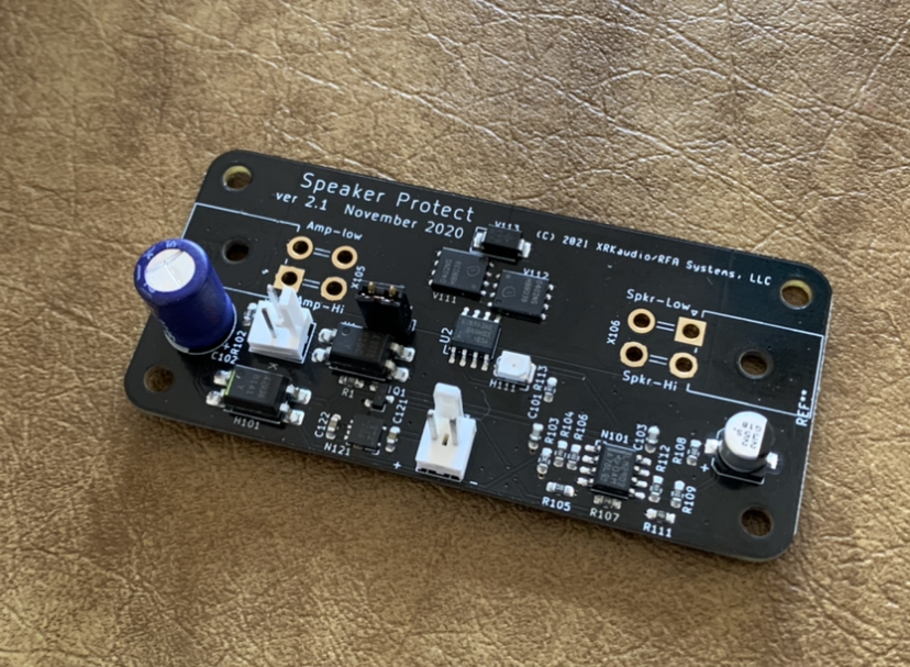

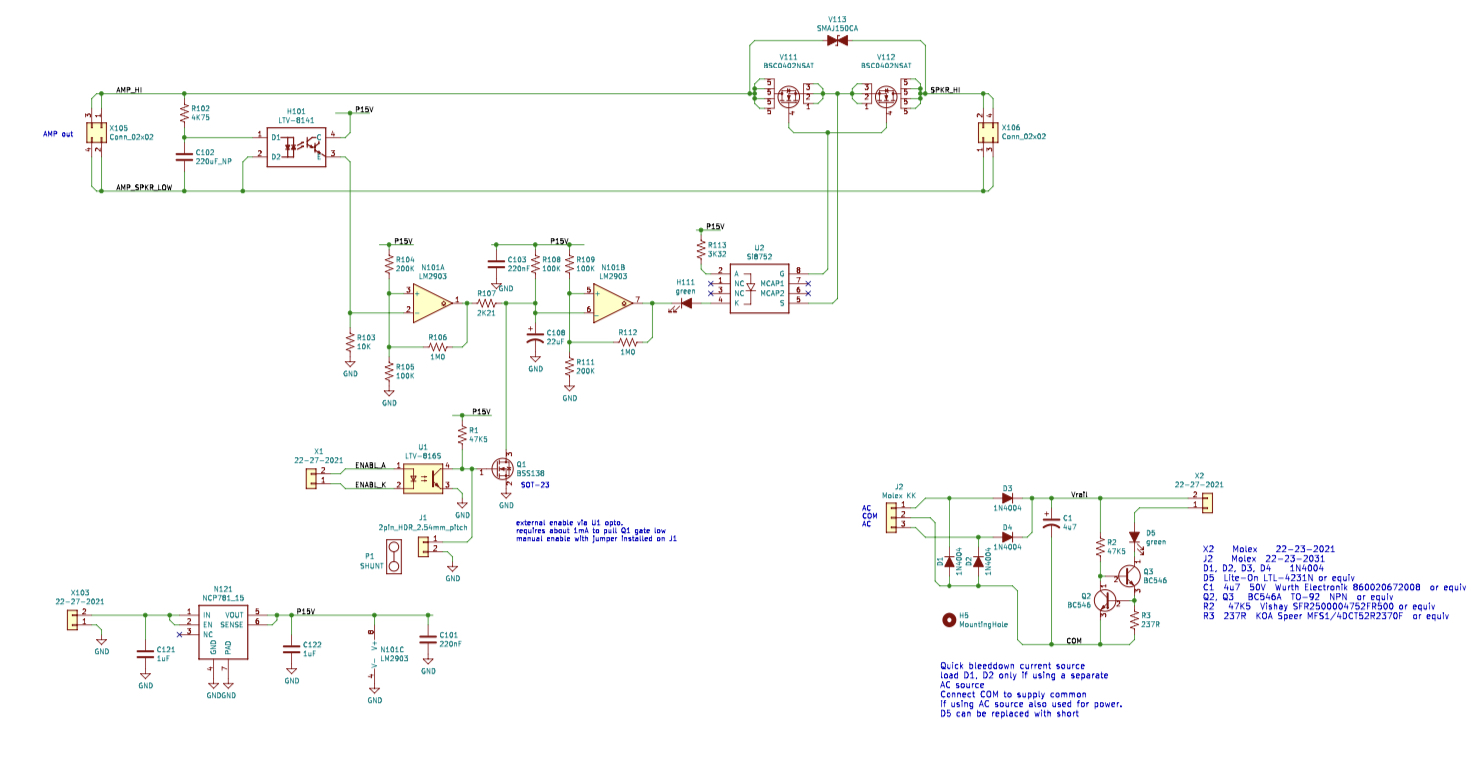

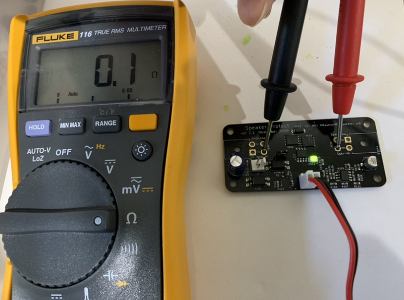

The Gen2 has its power supply isolated from the speaker negative or ground - allowing use in BTL (non zero volts negative terminal) amps. Hence, the PSU connection needs its own ground.

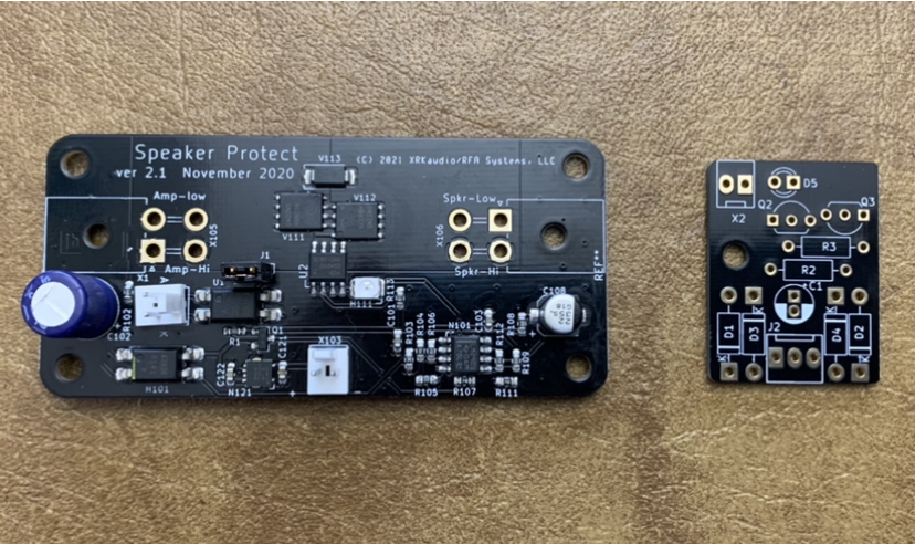

There is also a remote quick shutdown connection, that when used in conjunction with an open collector type logic circuit, allows the SSR to turn off instantly to prevent speaker turn off thump. The bonus unpopulated through hole board that comes with the SSR allows you to make such a circuit with a few parts. Or if you are handy with microcontrollers or Arduino, you can easily provide this signal yourself. This bonus instant off controller board is powered by the secondaries of the power trafo. The moment power is switched off, the bonus controller switches the SSR off. Connect X2 to X1 (pin 1 to pin1 and pin2 to pin2). By making the controller board separate, it can reside closer to the PSU. The controller board can switch two SSRs off by putting the connections in series.
Note that if you are not using the external instant shutoff feature, a jumper must be installed at J1.

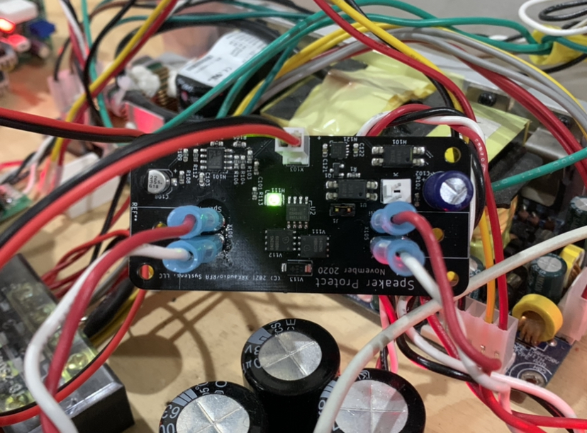

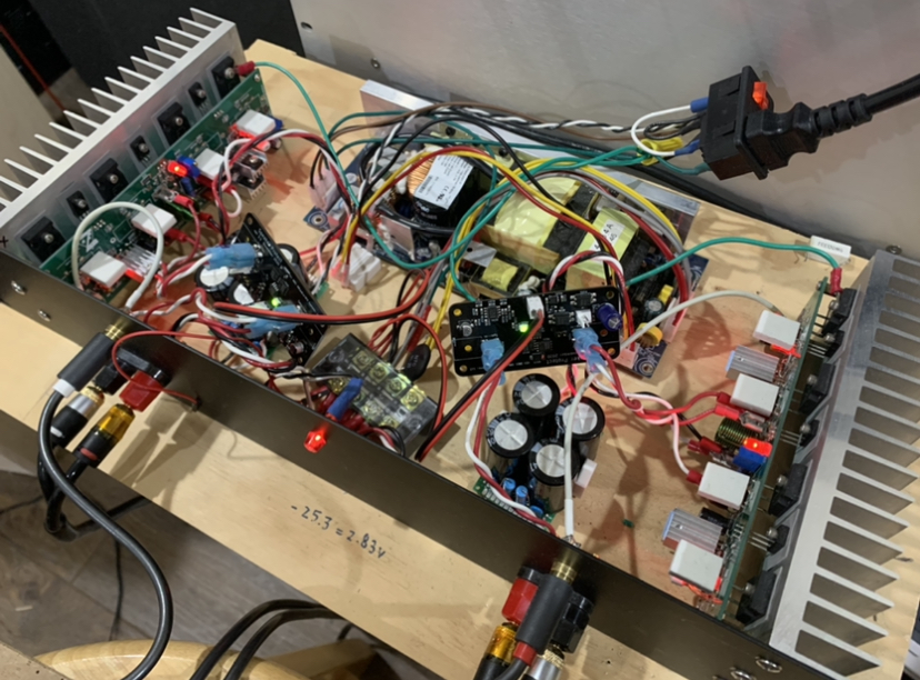

OK, thanks for the quick reply X.
To sum up the connections for a normal stereo power amp build - the following should be correct.
1. Wire Amp output to X105 with positive to Amp Hi and GND to Amp Low.
2. Wire speaker binding posts to X106 with positive to Speaker Hi and GND to Speaker Low.
3. Power supply to X103 with amp GND (0V) to pin 1 and the positive amp rail DCV to pin 2 (40VDC in my case).
4. X1 is not used.
5. Jumper installed on J1 - I assume the assembled and tested pcb will be supplied with that jumper in place?

I have great news here, the Gen2 SSRs are delivered! They look well packed and individually packed in anti static bags. Bonus boards separately packed and broken off already. The J1 shunts are already installed. I tested one and it works well.
