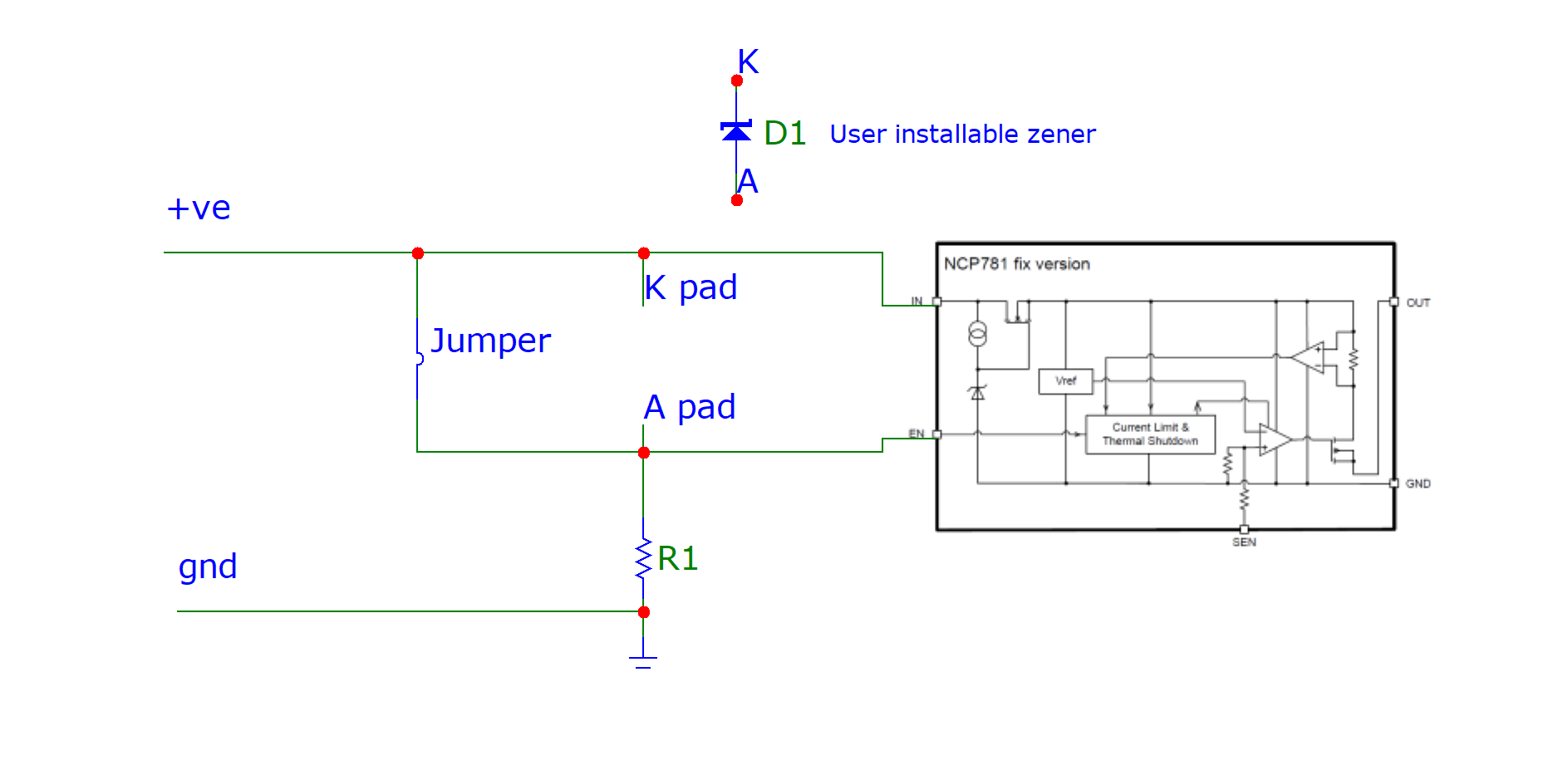

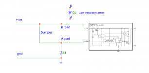

Speaking of zeners, for a future Rev3 version, below is another definitive and easy way to provide a fast off for avoiding a turn-off thump. This zener is NOT in series with the regulator as above, rather it is in parallel.
Rather than tying the enable pin of the NCP781 directly to +ve, tie +ve to a jumper that normally shorts out two through-hole pads for a user-installable zener diode. You’d also provide a pull down resistor at the NCP781’s enable pin to ground, say 4.7k. The board ships with the jumper and resistor installed and no zener. Should the user decide to implement the fast off feature, they pull the jumper and install the appropriate zener.
The PCB ties the zener's cathode(+) pad to +ve and the zener's anode(-) pad to the pull-down resistor to ground. The enable pin is tied between the zener and the pull-down resistor.
The voltage value of the zener is user selected and installed according to the specific rail voltage of the amp and the droop allowed before the NCP781 disables itself.
For example, if the amp has 42v rails and the user chooses to allow for 7v of droop, the user pulls the jumper and installs a 35v zener.
Pulling the jumper could add turn-on delay to the existing 3 seconds. I imagine it should be minor.
A picture is worth 1000 words...
I wasn’t thinking of the zener to make the shutdown faster. Just to address your concern of excess dissipation if rails are too high.
We found that a low capacitance power supply feeding the regulator was sufficient to shut down the SSR before turn off thump. This was discussed earlier as using half wave bridge and 22uF cap that feed power input. It would collapse in under 100milliseconds upon the PSU secondaries losing power.
