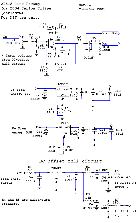

Things improving...but too much gain?
Hi all!
I built the AD815 pre to drive my chipamp (all, pre and chipamp Carlosfm's implementations). First I had a dual 100k pot -way too high...yeah, I know, but faked with a 2k7 resistor- and Carlos adviced me to change for a 10k or 20k log pot.
I did already (10k) and all sonics are greatly improved but ....
I was wondering about the best way to reduce gain: is better to reduce in the pre or in the power amp?
I have now lowest volume at 12 o'clock, and I can reach only 15 o'clock before breaking anything (my beloved ears... ie), so only 45º rotation I think is not the ideal setup. I have to mention they are driving very easy and sensitive speakers.
btw, Carlos: have I to measure dc input offset for trimming with the source connected? (newbie attacking again )

Hola Juan,
If I remember, you have very sensitive speakers (>95db), indeed you must decrease the gain of the preamp.
I suggest you increase the value of R4 (330R) for 1.2k.
That will give you a gain of 1.5, almost half of what you have (2.87x).
Then adjust dc-offset, with no source connected, volume pot below mid position (10 o'clock is fine).

carlosfm said:Hola Juan,
Thanks Carlos for your fast response (I know you are very busy).
Ok.. for me it's 16 o'clock (I start at 12... various design reasons)... and I'll make all changes. Have I to measure dc offset at input? I think at input, because I remember you mentioned you had between 30 and 100 mv at output depending on pot position.
Really excited about it. This combo rocks!!!
Obrigado
JL
Dr.H said:Carlos,
Does this mod affect the sound or just the stability of the regulator?
Hi Ryan,
It creates additional PSU filtering (R+C), before injecting the voltage on the NI input.
Sorry if I didn't update the schematic back then.
The thread was forgotten around here and I didn't think somebody would build this.
It's worth the trouble to build this pre, that's for sure!
Dr.H said:Have you played around with different sizes of transformers for the power supply to the AD815.
No, I didn't change the trafo, it's not practical, and the one I use just fits very nicely.
My pre has 6 inputs, 3 (buffered) tape loops, two line outputs and dedicated headphone out.
No space for a bigger trafo...
I'm using a small toroid ~500ma at 2x20V that I scavenged from a very old Nokia modem.
The PSU, before the regs, is RCRCC.
Hi Carlos
I have 3 questions
What did you use to buffered the tape loops?
How was the "dedicated headphone out" done?
For the AD815 was carbon or metal film resistors used?
jaudio said:Hi Carlos
I have 3 questions
1. OPA627, biased to class-A
2. OPA2132+BUF634
3. Metal film
