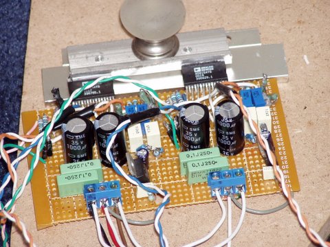

Im listening to the headphone amp driving small computer speakers and I can tell you the AD815 are driving the h*ll out of these speakers.
From 7ft away I can hear it very clearly. Now, think of what it can do for headphones.
jaudio said:Im listening to the headphone amp driving small computer speakers and I can tell you the AD815 are driving the h*ll out of these speakers.
jaudio did you just bend the legs of those ad815 a bit to make them fit the hole spacing of that board?
btw i hear brass doorknobs sound a lot better than frosted glass ones you should try it! 🙂
neutron7 said:jaudio did you just bend the legs of those ad815 a bit to make them fit the hole spacing of that board?
Yup I just bend them. If you bend them be careful.
neutron7 said:btw i hear brass doorknobs sound a lot better than frosted glass ones you should try it! 🙂
Ha Ha It is there to hold the aluminum strip to the tab. I heard silverplated gold is even better.
