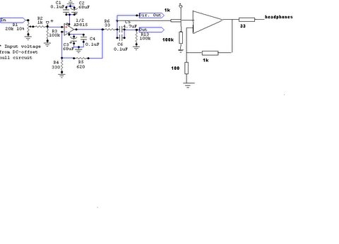

jaudio said:Is it a good idea to place ad815 headphone amp after ad815 preamp or after pot?. Ther headphone amp is the same as the preamp except for gain. And a 10K pot instead of 20K.
No, don't cascade them.
The pot feeds the two halfs of the AD815 (one channel), and use ~200k instead of 100k for R3.
Don't forget to adjust DC-offset on the headphone amp with the same load as your headphones.

Carlos, I am currently gathering the parts to try out your preamp. Could you please let me know why you put so much efforts in nulling the DC offset? I mean, you have a DC blocker on the output anyway (if you dont use the direct output shown). Did you ever try it without the additional circuit?
Mick
Mick
Mick_F said:Carlos, I am currently gathering the parts to try out your preamp. Could you please let me know why you put so much efforts in nulling the DC offset? I mean, you have a DC blocker on the output anyway (if you dont use the direct output shown). Did you ever try it without the additional circuit?
Mick
Mick, I use the direct output (I said that a few days after posting the original schematic), because I have input coupling caps on my power amp.
Otherwise I would use the output caps on the pre.
Don't cascade coupling caps, you will notice the veil right away.
Anyway, my pre has two outputs, one direct, one with the caps.
The output with the caps I'm using to feed the sub.
As I said initially, the efford to null DC-offset (which is null on the output on one point of the volume pot that you adjust, it will range from negative to positive, but low value) was to also null the input dc-offset that these chips have.
Normal on current-feedback op-amps.
Otherwise I would easily solve the problem by using input coupling caps, or an input buffer stage. And that was out of the question.

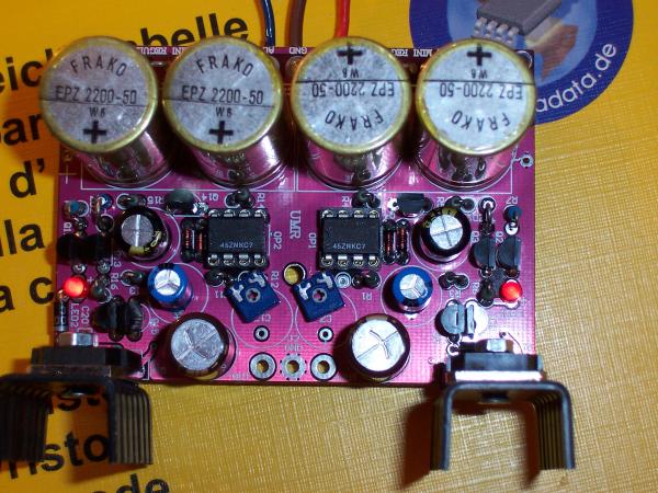

carlosfm said:KT, without any details and with such an elaborated text, that looks like marketing talk, copied from the manufacturer's user manual or publicity, something that reviewers do very often...
Carlos,
Yes, there's not very much detailed information about it. Do the regulator components in the not-too-detailed photos suggest anything to you? Maybe nothing new or novel is being done, but it would be interesting if it were.
Best,
KT
KT said:Yes, there's not very much detailed information about it. Do the regulator components in the not-too-detailed photos suggest anything to you?
It can be some variation of Jung super regs.
I have built this one, PCB came from Taiwan, gently sent by forum member Coffin.
Btw Tom Evans has made good things and usually knows what he's doing.
But... $4000 for a PSU?

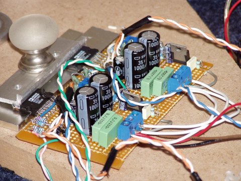

This is my AD815 preamp-headphone amp. It is dual mono,one half is the preamp and the other half is the headphone amp.
I have listened to the amp for a few minutes,I can say it sound very promising. Im getting some hiss from one channel,when it is connected to my bridged OPA549 amp(It maybe the amp. that channel does have fits once in awhile). If you use the AD815 as a headphone amp,dont set the gain as high as you will normally would.
