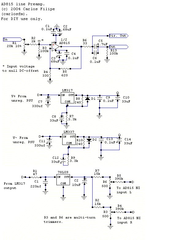

Here it is in all it's glory
With this circuit I have absolutely no DC-offset on the input.
No input caps needed.
I have two outputs on the board.
The direct output, depending on the position of the (20k log Alps Blue) pot varies between -30mv to 100mv DC-offset at max. volume.
I'm using the other output (with the caps).
The sound is fantastic, enjoy.😎

do you use both halves?

As other people said the schematics do help to clearify a lot.
Do you use both halves for right and left? or do you use two seperate AD815's for channel seperation; and do you then double the regulation?
Thanks.
Re: do you use both halves?
Yes.
Double the regulation?
No.
The LM317/337s are on-board, the PSU is unregulated with schottky diodes and 4700uf caps.
Regulation before the LM317/337s sounds worse to me.
The 78L09 is to null dc-offset.
This is a current-feedback op-amp and, as normal, it has DC on the inputs and outputs.
This way DC is low on the output and none at the input.
DC was a little high because I'm not matching impedances.
Otherwise the input signal would be very attenuated.
Remember, here we can't use the feedback resistor we want as in voltage-feedback op-amps.
As I said, the schematic was halfway done.
I finished it yesterday night.
I had the two channels on the schematis (it's redundant anyway) but I had to remove the other one because I reached the limit of 50 parts on CircuitMaker 6 Student.
This software makes very "clean" schematics, I like it.
But 50 parts is a very low limit.:bawling:
EDIT: Oh, if you are worried, let me tell you that soundstage is very good and channel separation too.
Maybe i haven't given this enough thought but the offset compensation circuit does not fill me with confidence. It seems the noise from the 7809 will be directly injected into the AD815 input. Maybe a dedicated CCS will be a better solution?
Yes, there are better solutions, but this simple thing works quite well.
The 78L09 is pre-regulated, anyway.
Someday, who knows, I make another board and think of something different.
For now, this works like a charm.
Gotta go, there's Morphine playin' and that unique bass kills me.😎

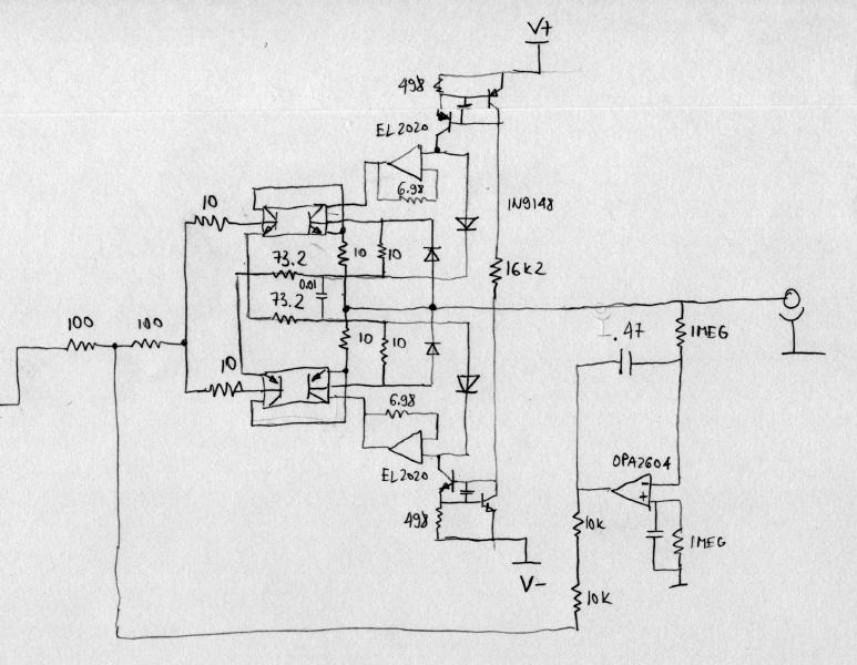

Here's the ML38 output buffer schematic with servo. You might try that servo and see how good it works. I still didn't have time to substitute it with a cap and compare, PS is +/-15V
Dual transistors are SSM2210/SSM2220, later upgraded to MAT03/MAT02
Hi Peter
How certain are you about the accuracy of the schematic? I might need to redraw it but so far fail to make much sense. By the part types i would expect a dual differential amp with each phase buffered by a EL2020. The discrete transistors look like current sources. Could it be the El2020s need to point the other way round? Or am i just being more stupid than usual?
