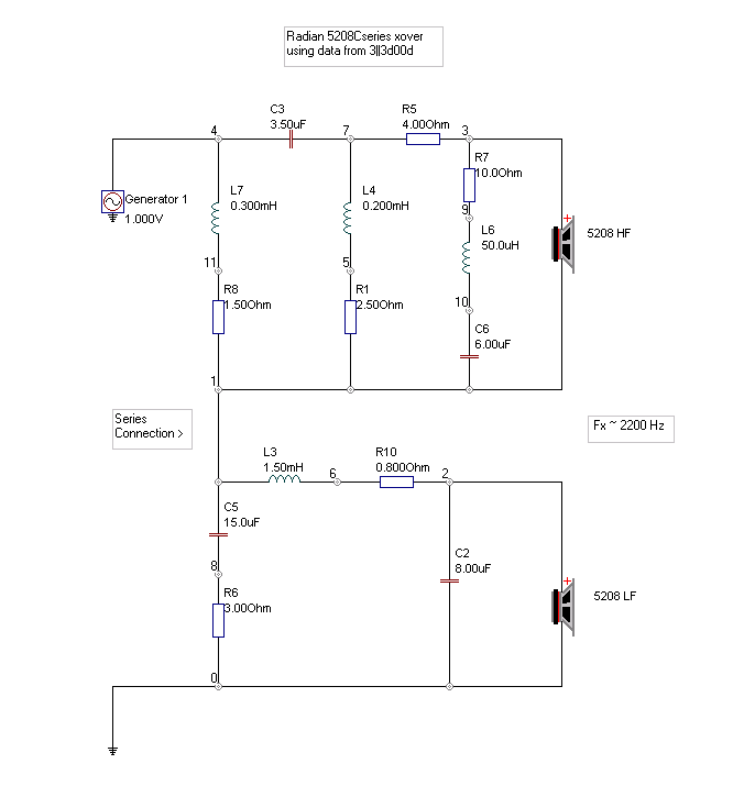

Silly question: Those resistors in series with the inductors are the actually dc resistance of the inductors and not additional series resistance correct?
On TerryO's series design, the resistance shown in series with each inductor is the total combined resistance of the coil and a separate resistor. For example, if L7 (.4 mH) has a dc resistance of 0.33 ohms, then R8 would be a separate resistor of 1.17 ohms, to make 1.5 total. etc This is just an example to clarify. Depending on wire gage, the dc resistance could be more or less.
Sorry for the confusion. It's just easier to run the sim that way, and then go scrounge through the parts bin for a coil that is suitable. (tolerance of 5 or 10% is often close enough)

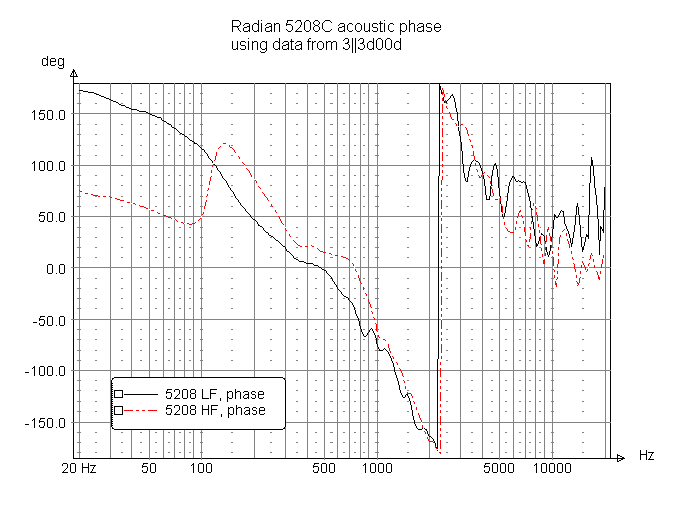

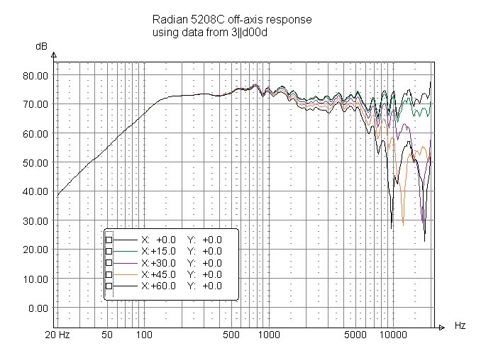

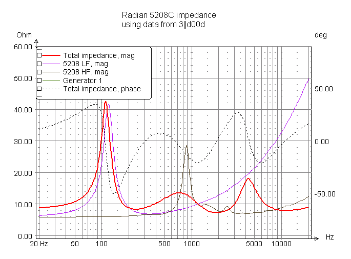

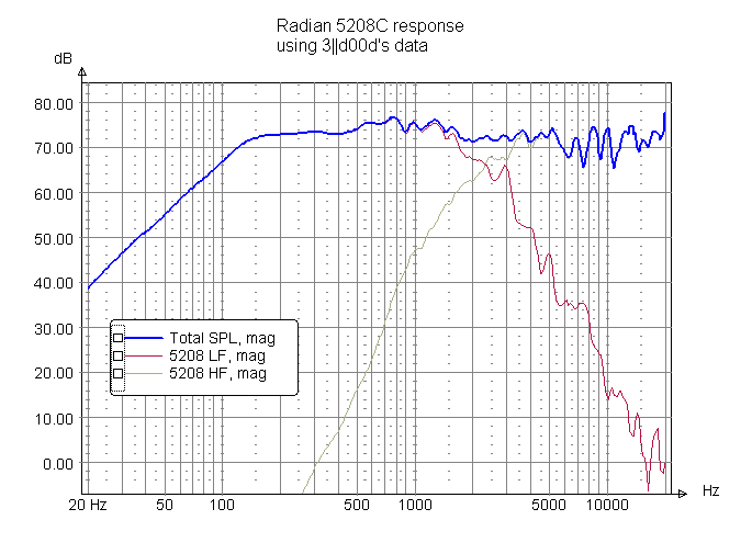

Also it was mentioned that the acoustic phase could be improved in the series crossover.
If you are referring to post #32, I was referring to possible improvement to the acoustic phase for the series crossover using data files supplied by
3||3d00d. The phase shown on that post using TerryO's data is about as good as it can get, IMHO.
For whatever reason, 3||3d00d's data was somewhat different for his set of drivers vs. TerryO's. Due to that, the series crossover that works well for TerryO's doesn't seem to work as well for 3||3d00d's. A few tweaks to component values, etc. might get them to a similar point, and with improved acoustic phase.
Is a first order series crossover out of the question? Just wondering....
Nothing is out of the question. A first order is obviously less expensive, and usually a starting point. But in TerryO's case, it took more components to achieve the end result.
3||3d00d,
Here's a series result using the "design zip" file that is on Post #14.
The basic topology is the same as the one used on TerryO's, but with a few changes to components. See my earlier post regarding resistor values in series with inductors in the circuit.
The acoustic phase looks good. And the impedance seems to be an easy load.

I plugged the schematic you provided into xsim and it only seems to agree with your sim if z offset is 0. I calculated as the W needing ~9.6cm of delay, apologies for not making this clear.

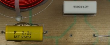

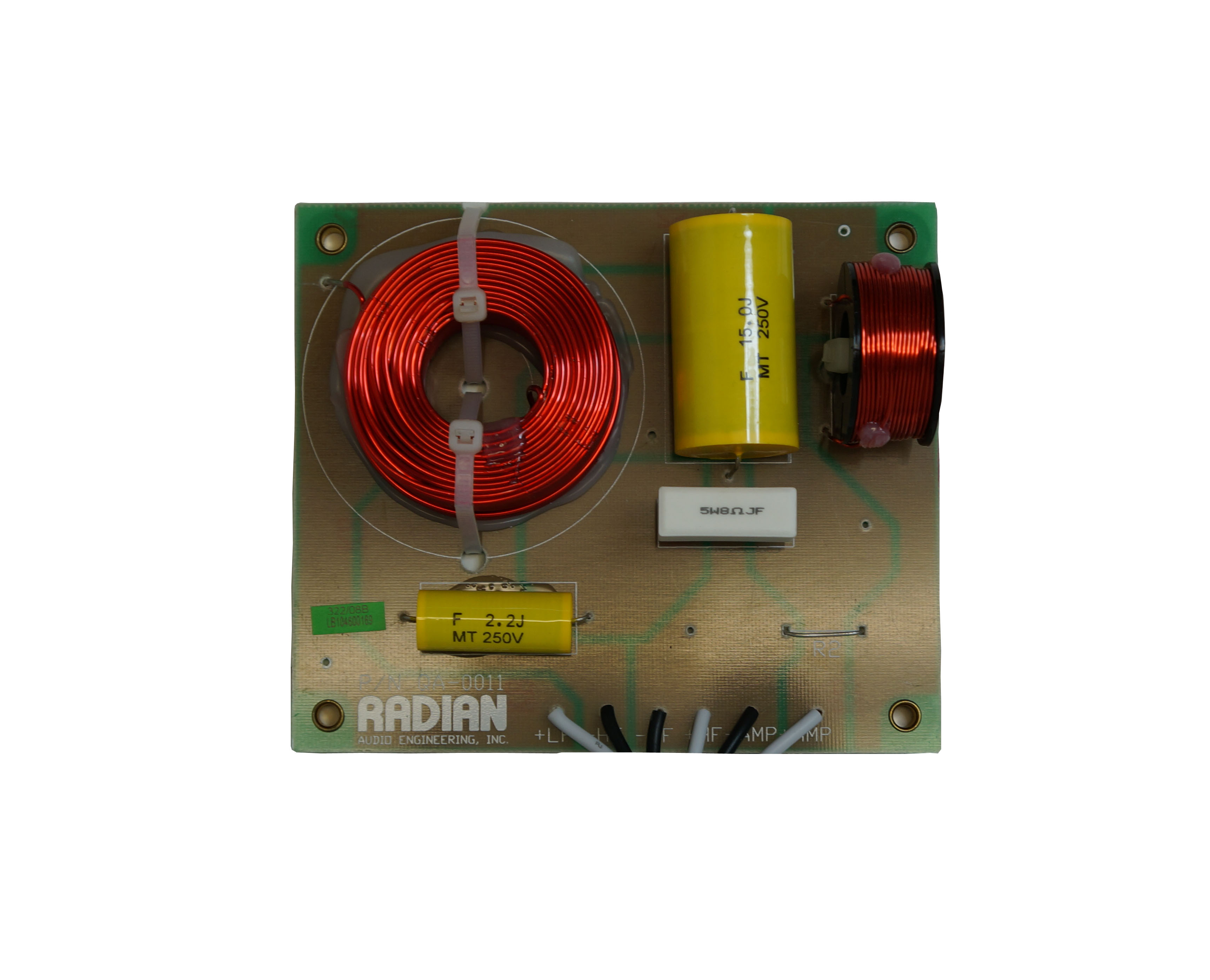

T/S parameters: Sd doesn't look correct from either sources. Can someone post the correct diameter (or area) of the diaphragm? (I calculated an area of approx. 225 cm2 w/o measuring.)😕
post #13
Radian@usspeaker

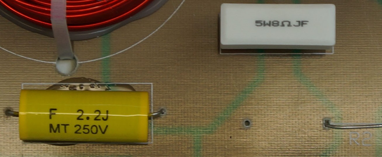

Below the 2. order crossover from Radian with HF atten. 8R0 in series with 2.2uF - Radian 322/08B-2. (Not certain about/if the same component value, being an old picture.)😀
