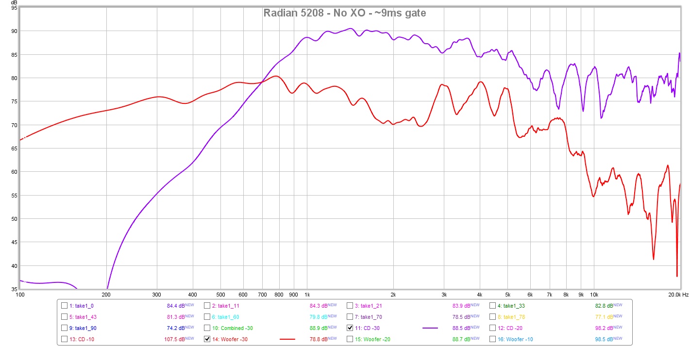

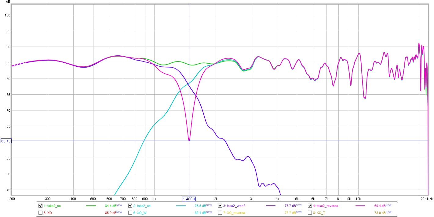

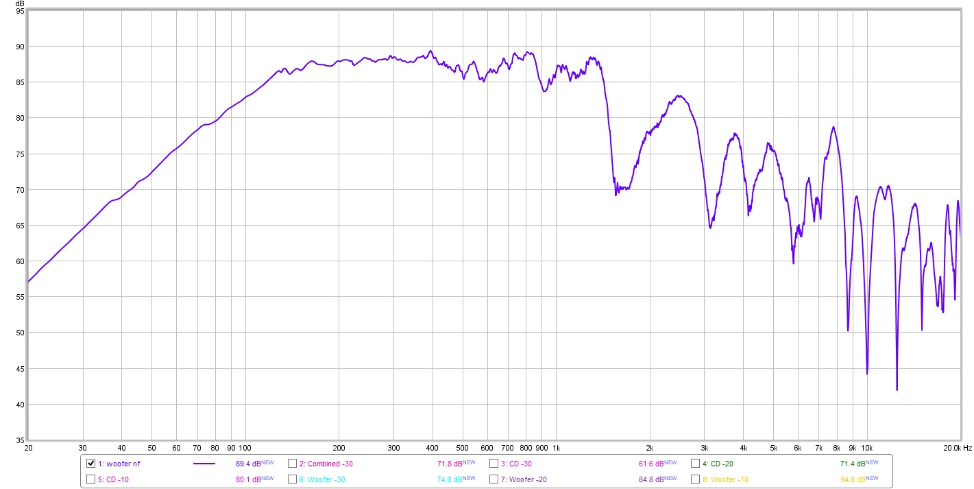

Radian 5208c coaxial project
It's important to note (again) that the acoustic phase alignment corresponds to the Co-ax baffle positioned directly above the H-frame opening.

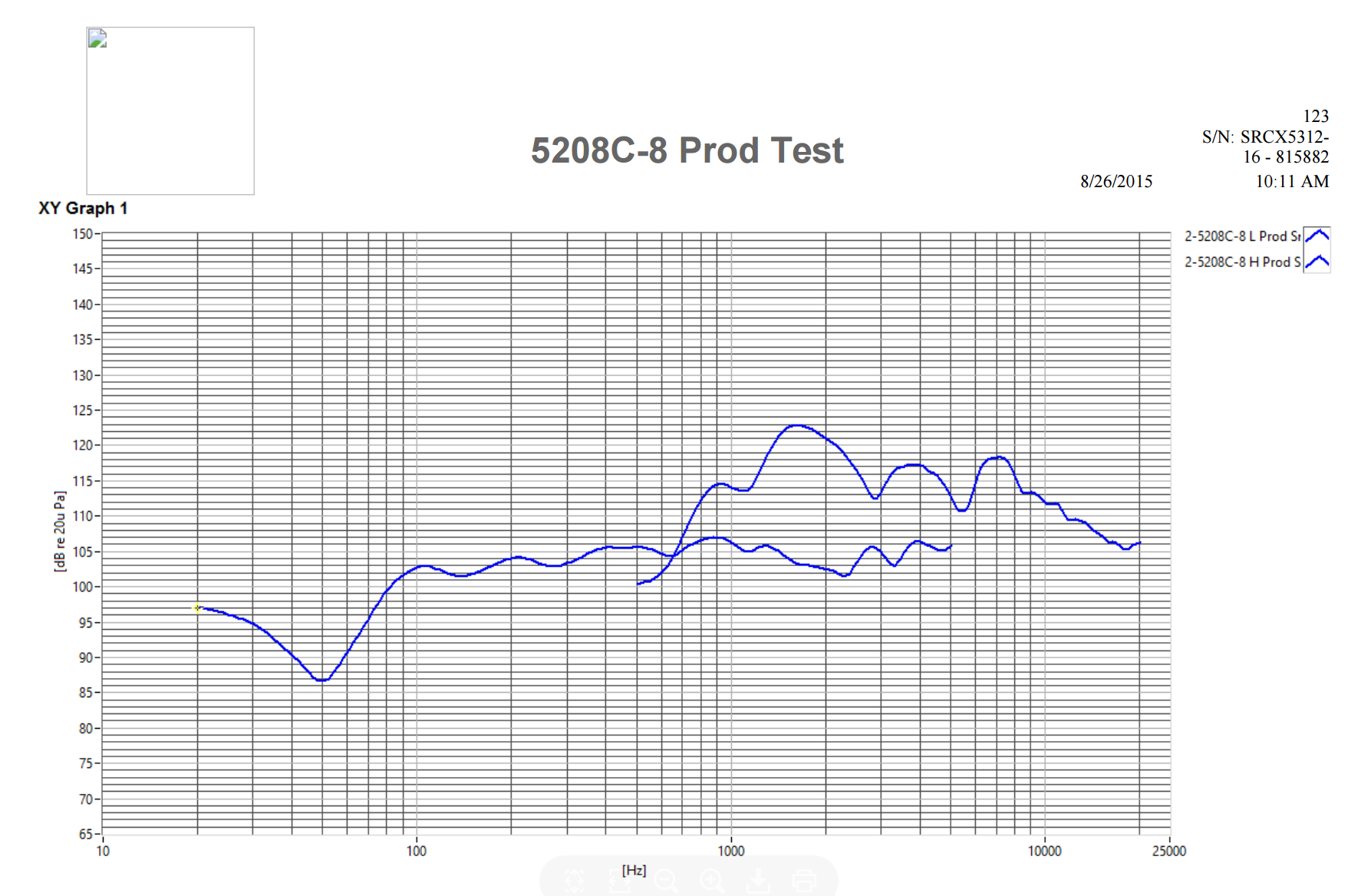

Curious: is this using the aluminum tweeter diaphragm? If so, I wonder if the crossover would need adjustment if Radian's Truextent beryllium diaphragm were used?
Greetings from Switzerland, David.
Hello David,
I am pretty sure that Terry's Radians are aluminum. Next time I talk with him I'll confirm that.
These are the only 5208c drivers that I have experienced. I don't know how the beryllium models differ in performance.
The Radian Audio website seems to link to the same datasheet for either aluminum or beryllium. 😕
Dear Dave
Thanks so much! You're right, I haven't been able to find another spec sheet on the beryllium version either. Judging from experience, frequency response tends to be very similar up to the extended treble, where a beryllium appears to roll off, but then, looking at a waterfall plot, it turns out what's "louder" in the aluminum versions is severe dome breakup. So if anything, the beryllium might need more of a lift above 10k or higher, not less - again, in my experience. In those instances where I could listen to direct comparisons (doesn't include the 8" coaxial discussed here), this difference is audible: the aluminum seems "livelier" at first, but sounds "annoying" in comparison after a short while.
