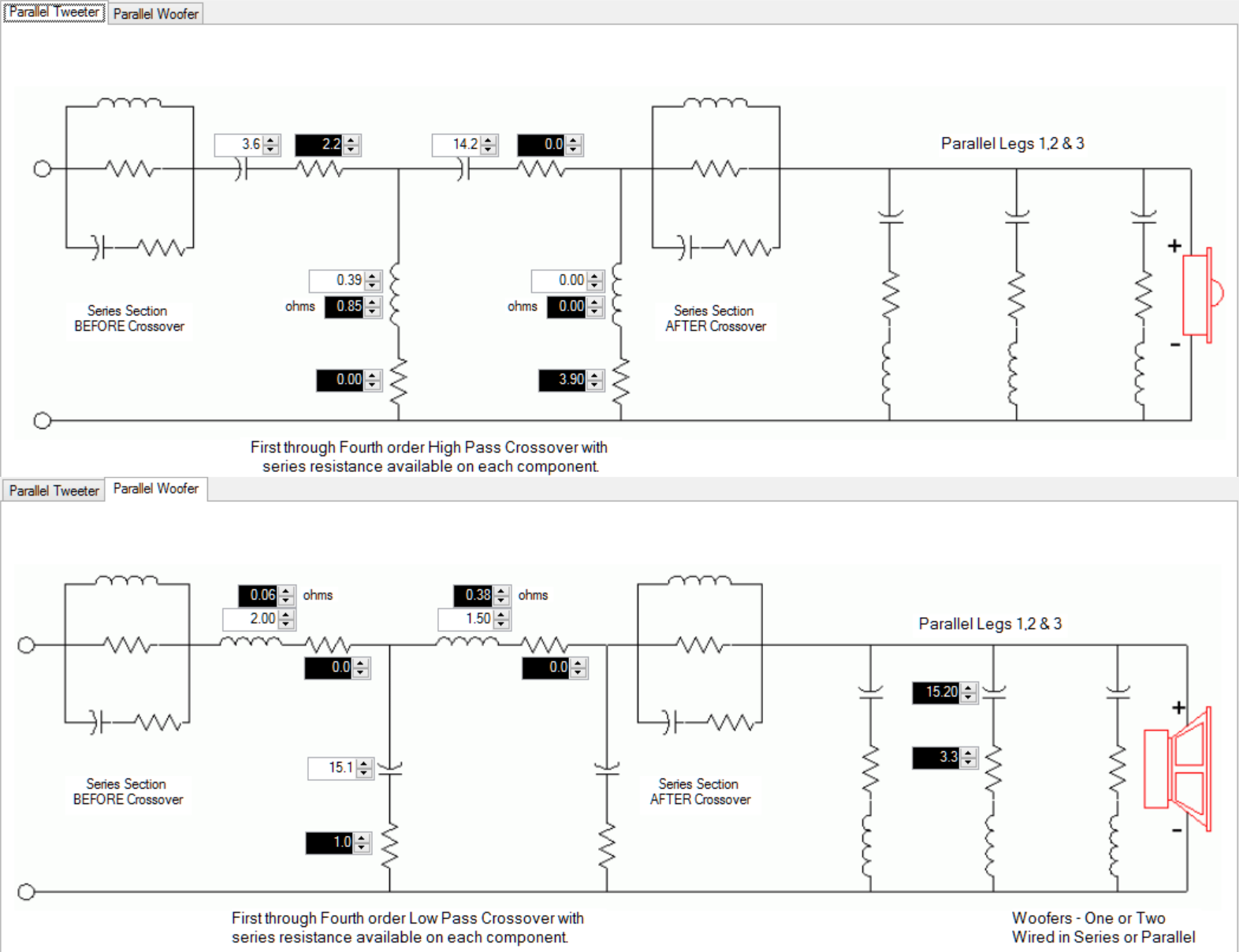

I'm not familiar with the crossover nomenclature that you provided for the schematic. Could you be kind enough to provide correlation of values to position in diagram, such as below?
here you go, top section is the high pass and the bottom is the low pass. Where zero values are shown, it means the component is not present.
I can share a winpcd project file if you want to play around with it.

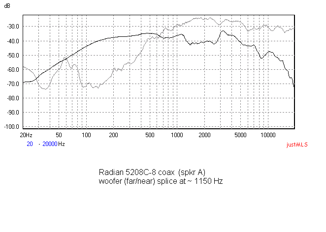

The zip file with blended data does not have minimum phase for the woofer file. Is there possibly a different file intended?
TIA,
it looks like I included the wrong one in those zip files, here's a corrected zip
View attachment 5208c_xo_design.zip
I now see there is a time limit on editing posts so I can't make this clear in the earlier post (but perhaps a mod can fix it)

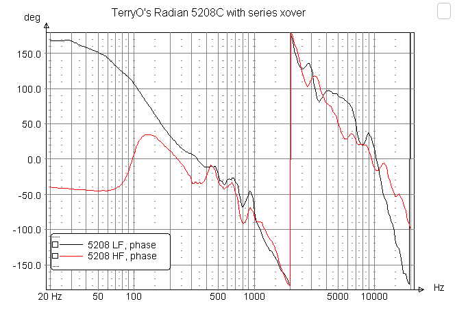

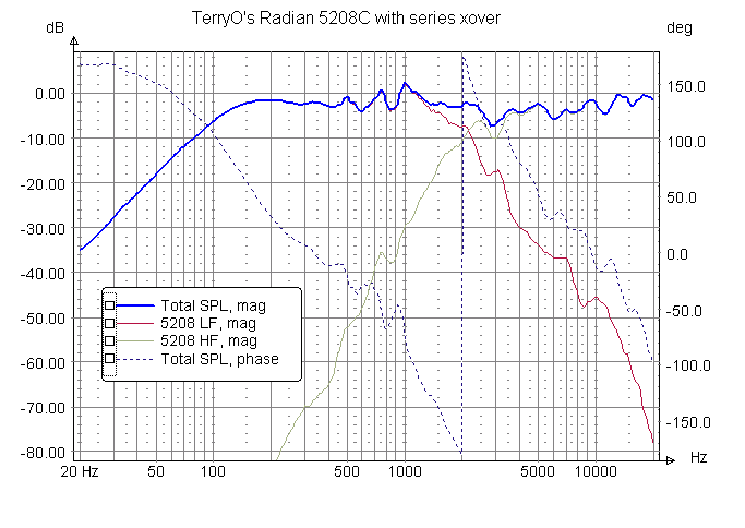

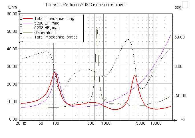

Thanks for providing the min phase file for the woofer, 3||3d00d. Nice work btw. My design has similar spl response, but the impedance and acoustic phase differ somewhat. I imported your data files into the series crossover sim. The drivers are different enough that several changes to components are required to get a similar response, but I believe the acoustic phase could be improved. If you're interested, I'll have more time in the next week or so to work on that.

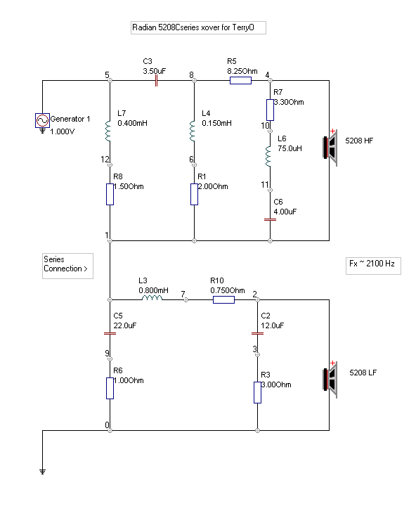

A few snapshots from TerryO's 5208C crossover design.
The raw spl of the LF and HF was similar to 3||3d00d's. But there are some noticeable differences.
The xover is series, just because I was interested in seeing what could be done with this coax. The crossover point was just above 2 kHz.
The result seemed to be a good balance of SPL, impedance, and acoustic phase. In fact, it is probably the best match of acoustic phase over the broadest range that I've dealt with (so far). 🙂

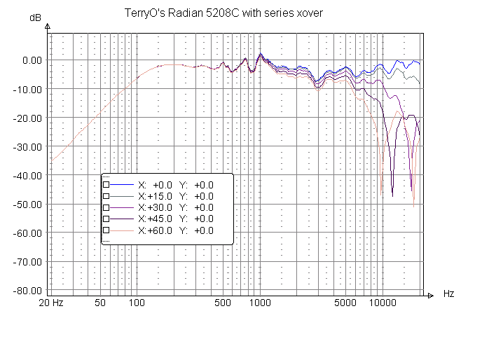

Here's a shot of the off-axis from my sim. (not the pretty colored contour plot)
There is something going on somewhere beyond 15 and 30 deg off axis. From prior experience, actual measurements off-axis don't necessarily show those nulls. Is this an inherent characteristic of the driver? Or is it influenced by the crossover?
Someday, I would like to take off-axis measurements to compare to the sim.

It looks like the Fs is a little higher than the published specs
just to be clear, the specs I published are the (current) official specs (as far as I know anyway, they come straight from Radian Audio so you'd hope they are official!)
Those resistors in series with the inductors are the actually dc resistance of the inductors and not additional series resistance correct?
if you mean on my schematic, yes (DCR)
