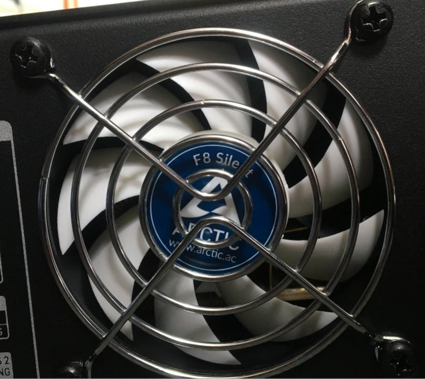

Ball bearing fans are noisier than fluid dynamic bearings. You will have better selection of fans if you use a 12V fan and a small 24v->12v buck converter (ebay). I did this for my DSP fan as I needed a silent 40mm fan and the installed one was 24v, I just heatshrinked the voltage converter onto the fan lead.

I ended up with a MagLev fan that runs at 24V. I am rather reluctant to install a buck converter (switching noise source) inside my amp enclosure.Ball bearing fans are noisier than fluid dynamic bearings. You will have better selection of fans if you use a 12V fan and a small 24v->12v buck converter (ebay). I did this for my DSP fan as I needed a silent 40mm fan and the installed one was 24v, I just heatshrinked the voltage converter onto the fan lead.
I'm assuming that 12V fan manufacturers might offer 24V versions of the same mechanical designs, but I'm just getting started sourcing fans. Actually, I'm going to make a bold guess that the only difference between 12V and 24V fans from the same family of a given manufacturer are the values of the passives on the internal circuit boards. Thus, I'm extremely reluctant to buy a 12V fan and attach it to a 24V system. It would seem preferable to let the manufacturer alter the internal PCB stuffing to adapt a quiet 12V fan to 24V input. Then again, I'm sure I have a lot to learn on this topic.

I have a QSC RMX 1450 and a QSC ISA 450 that I use in my home theater, but I changed the fans in both. Both have Noctua fans. One has a 12 Volt Noctua and an exterior DC to DC buck converter control module that I put into a small box to vary fan speed, and the other has a 24 Volt Noctua (this was an industrial use model and a bit pricey) with the leads between the amp's fan output on the circuit board and the new fan's leads running to the exterior of the amp, where I have attached a resistor to slow the fan down. The 12 Volt fan with the controller can be slowed to a complete stop. For what it's worth, even for movie viewing with four passive subs running at high volume, the air coming out of the amps is never even warm at the lowest speed. I have actually accidentally unplugged the fan cable on the amp with the external control, and run the amp for a week or so with the fan completely off without it shutting down due to overheating. When I noticed the fan was off, I had just finished watching a movie and the air coming out of it wasn't noticeably warm.
When I was doing the fan mods, I was worried about the reduced airflow that the new fans had, even at full strength, but now I think that we tend to underestimate how hard these pro units are required to work in their intended applications. In my 24' X 16' X 7' home theater, the volume levels the amps are required to produce are not going to cause overheating. My recommendation is to buy older used pro amps, QSC, Crown, etc., swap out the fans for quieter models, and use a resistor inline or some sort of fan controller to get them as quiet as you need. If you are using the amps for two channel music listening rather than loud home theater subwoofer use, you can probably turn the fans nearly off and still not overheat the amps.

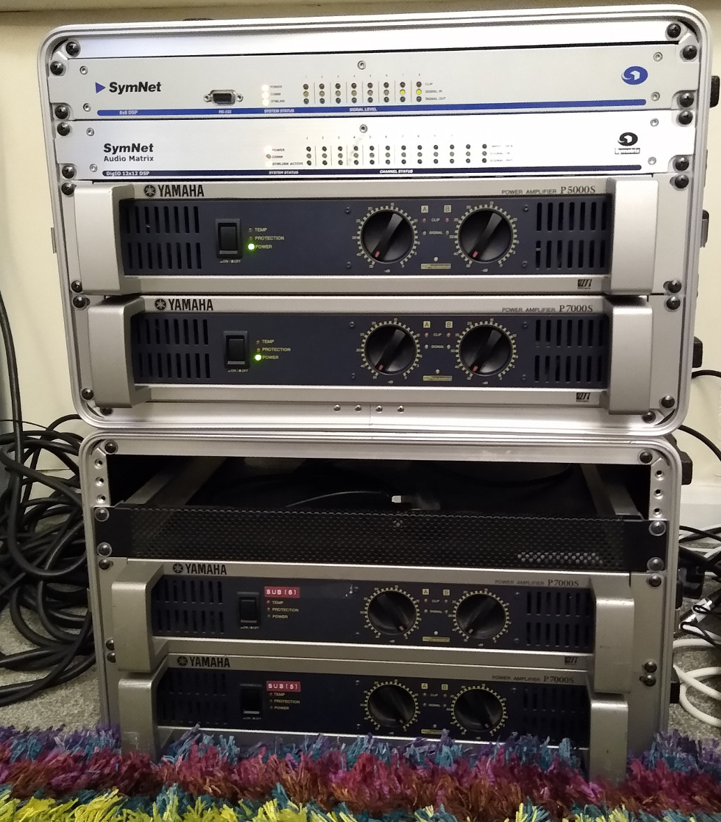

Installed new amps now running 3*P7000s +1*P5000s. Top amp rack has 2*80mm fans blowing across the top (holes in sides) to stop accumulation of hot air. I used slim ball bearing fans but even at 6V I can hear them so I might switch to thicker fans even if I then run the risk of damaging them in transit (as they would stick out about as far as the side runners on the rack box). The noise level is also low enough I can sometimes hear very high pitched whining from the DSPs power supply. I already re-capped any suspect caps in that supply so I suspect its just intrinsic to the design, its not loud but its a dent in perfection. I would like to upgrade to a symetrix radius NX, I did have the opportunity to buy one for £400 but it was untested and sold as seen and I didn't want to risk that amount of money. At the moment I run optical SPDIF into the DIGIO which goes over the 8x8 over symnet which outputs to the amps.
When setting up the new amps I found a flaw in the design of the P-series. With my Crown CTS4200 I had set the gains on the amp channels such that 18dBu on the DSP output clipped the outputs of the amp. I did this for optimal noise performance. When looking at the P5000/P7000s output on a scope with an 18Dbu signal and the attenuators turned down to prevent output stage clipping however I saw a clipped waveform on the scope display (also no clip light). So I had to turn the DSP down to 8dBu full scale output and turn the amps up to max, at which point the waveform only clips when the output of the amp clips. This has the side effect of reducing system SNR though so at this point I get way too much hiss from my tops when sat on the sofa (even though the P series has a lower noise than the crown these changes have amplified the noise from the DSP).
Anyway I have managed to solve the situation as I don't need anywhere near full output at home so I just turn the amp attenuators down at home and if and when I get to take everything outside again I will turn the amps back up.

Means you are clipping the input of the amp right.When looking at the P5000/P7000s output on a scope with an 18Dbu signal and the attenuators turned down to prevent output stage clipping however I saw a clipped waveform on the scope display (also no clip light).
You don't need the full power of those amplifiers in that case though do you. So instead of turning down the DSP output level for the CD's leave it at the same level as the mids and turn the HF amp gains down that amount. Yamaha has a cover that goes over the gain controls for this exact purpose I'm sure.I'm at 100dB/1W (8ohms) due to the passive mid/high crossover in my speakers. I have several projects though which will use directly connected compression drivers and I think the only solution for this is going to be:
I have the same issue with my setup.. P3500 or P5000 driving CDs directly but so far I have just been ignoring it because once the DJ starts playing it's a non issue.

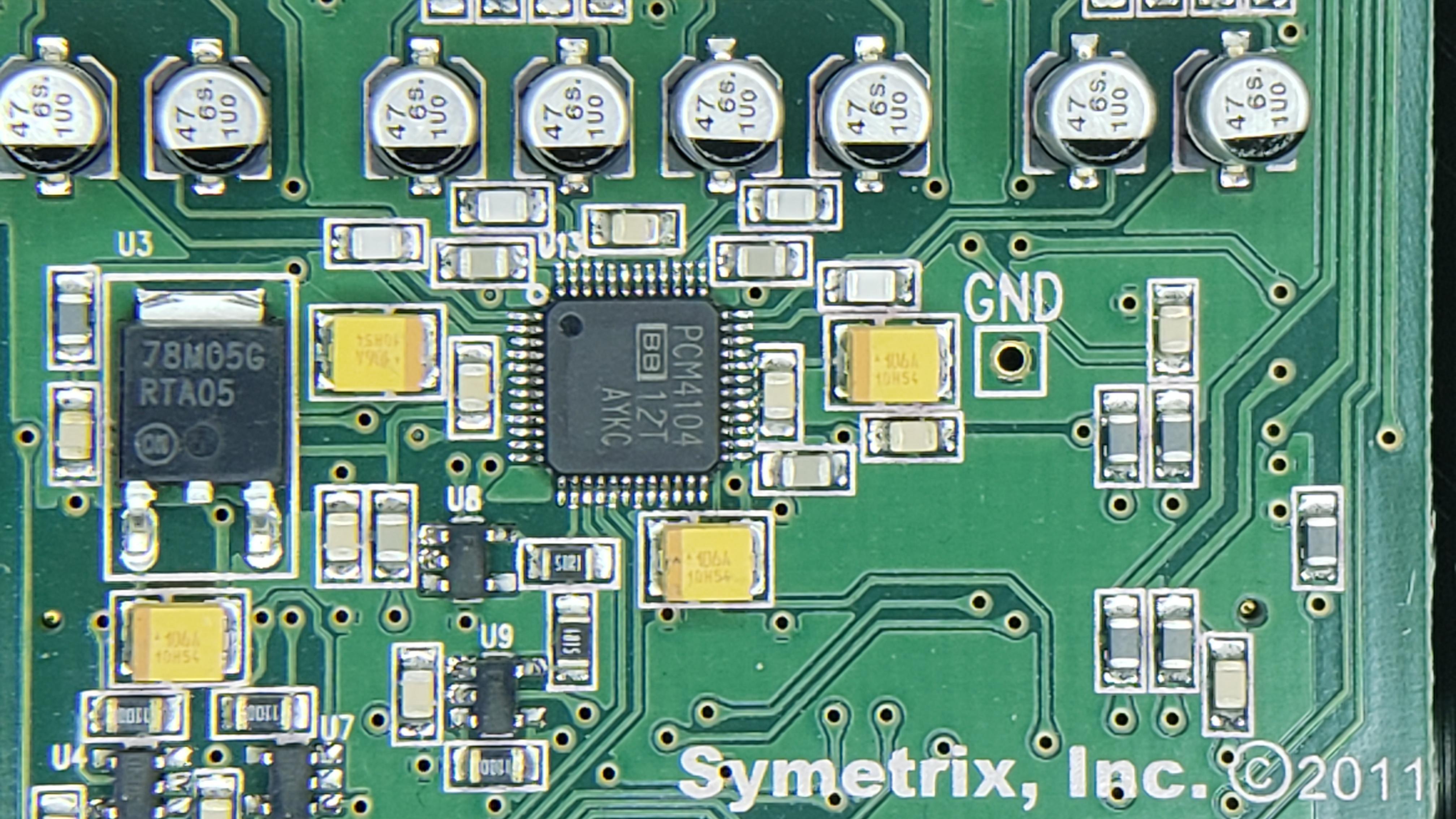

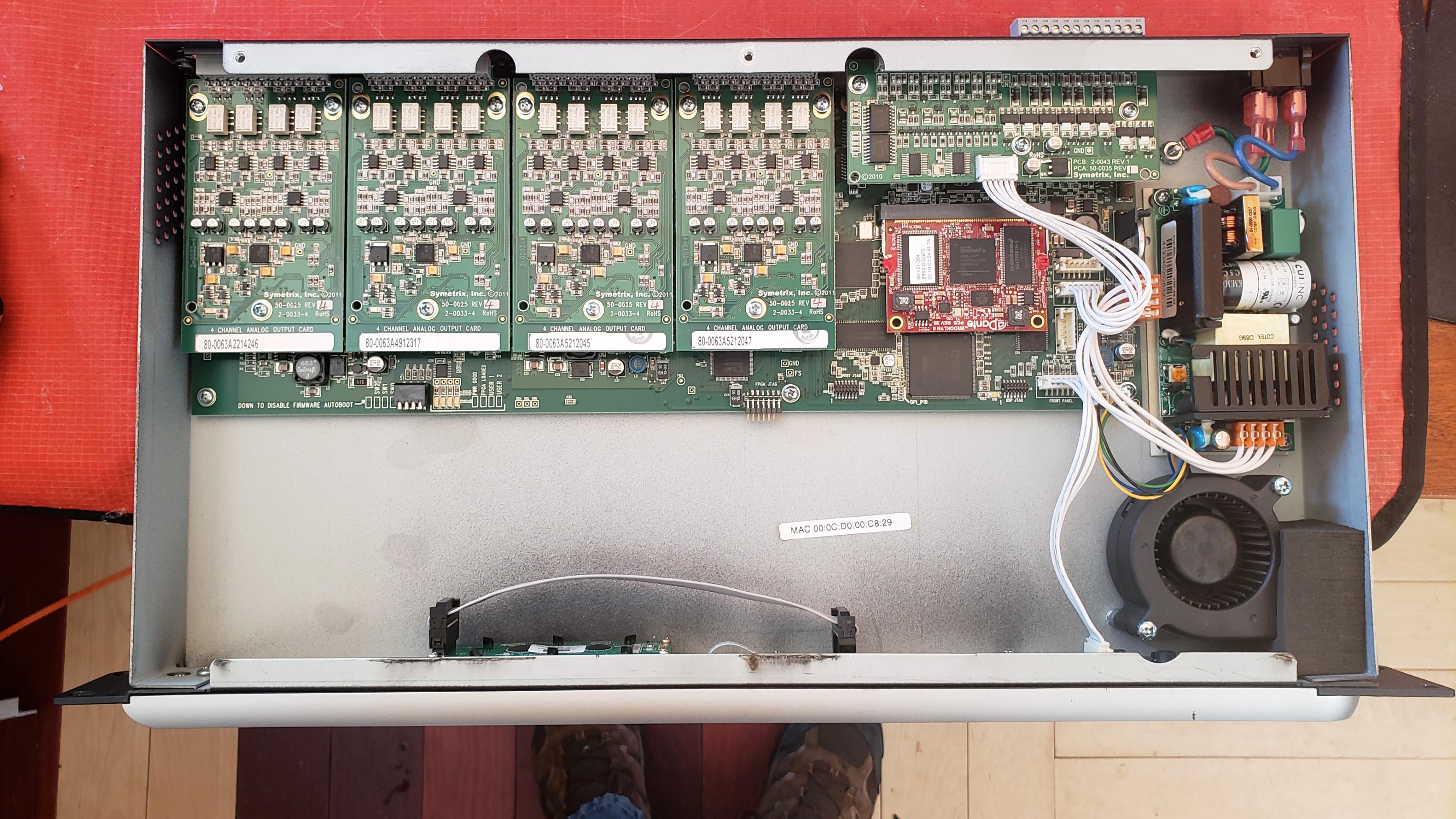

On DSP acoustic noise (since you are a fellow Symmetrix used-equipment fan)... I have a Jupiter, a couple of Radius AECs, and an Edge. The Jupiter has no fan. The Radius and Edge do have fans. They are variable speed, but in-rack, the Radius AECs' fans tend to run, and are audible. Not sure about the Edge, I haven't racked it yet.
I'm guessing a Radius NX *might* run quieter than the Radius AEC, as I suspect the AEC processors generate more heat than the 'plain old' analog IO cards. Ventilation is cross-flow. See attached photo of an Edge frame, populated with 16 ch of analog outputs.
As to the DSP and/or amp electrical noise, and which is the bigger problem... I haven't bought my QuantAsylum analyzer yet either (waiting for the QA402 to come out), so I can't be as quantitative about that as I'd like without trying harder than I want to. But here is what I can say anecdotally...
