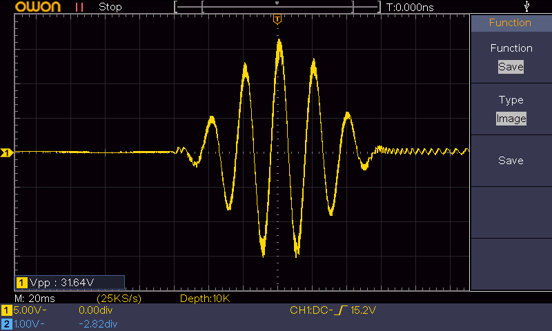

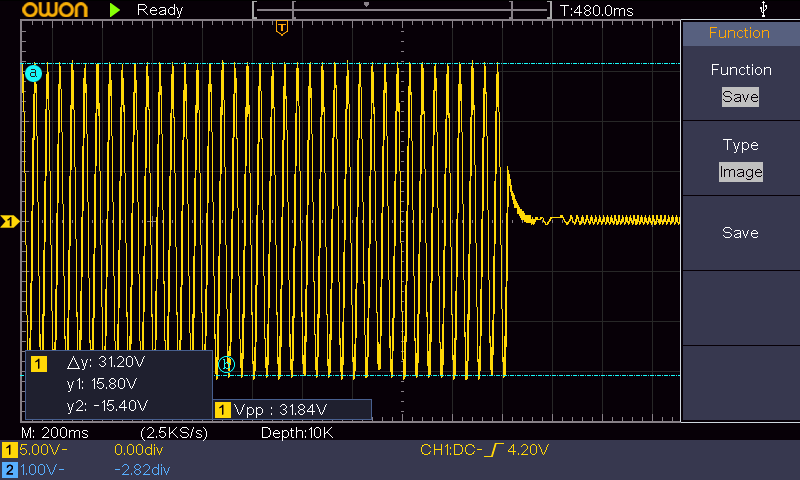

Some tests of the Crest Audio CLh5000C, at first I thought this was just an install version of the Peavy IPR2 5000 but it has better power output specs and its outputs are not bridgeable. This amp is not quiet but is also not so noisy as you hear its fans throughout the house only in the same room. This is quieter than classic PA amps with mains powered high output fans like the Cloud VTX1200. If you could put this amp in an equipment cupboard this would be OK. I now have a SPL meter but I only measured a small delta between the amp on and off so I am not certain of its accuracy.
SPL 1m from front grill amp off: 37.0 dBa (slow)
SPL 1m from front grill amp on: 41.4 dBa (slow)
To me 41.4dBa. seems plausible for how loud it is but perhaps the room is quieter than 37dBa as the low limit for the meter is 30dBa.
All voltages on scope screens are X10 as I used a 100x high voltage differential probe. The load is 4ohms on CH1.
CE2010 50Hz burst: 316.4Vpp = 3127W into 4ohms
After 100 cycles of 20Hz (~5s) = 312Vpp = 3041W into 4 ohms
There is an internal limiter that reduces gain to stop clipping.
So kind of weird I'm reading that this amp can do 110Vrms when the datasheet specifies it for 90Vrms. I'm also running off 240VAC not 120VAC as the datasheet specifies and perhaps they use a low distortion threshold? also there is quite a lot of switching hash which might be causing me to over read the voltage. Regardless this amp seems very strong with no significant reduction of output even after 5s so would be a good choice if you like sine wave bass lines (assuming you don't load it with 2*2ohms where the specs collapse a bit).
