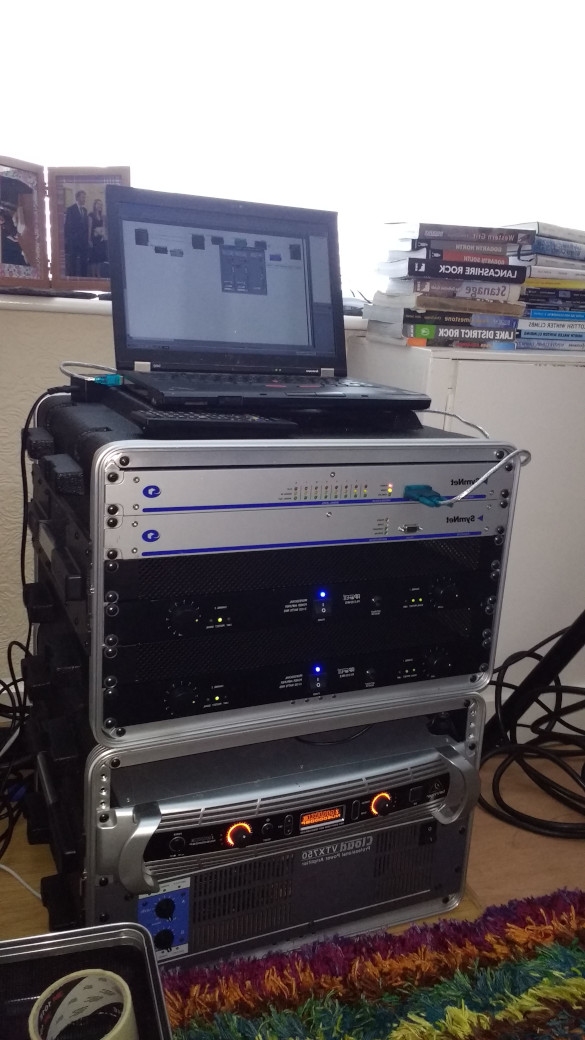

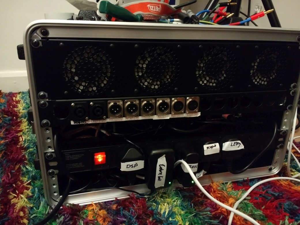

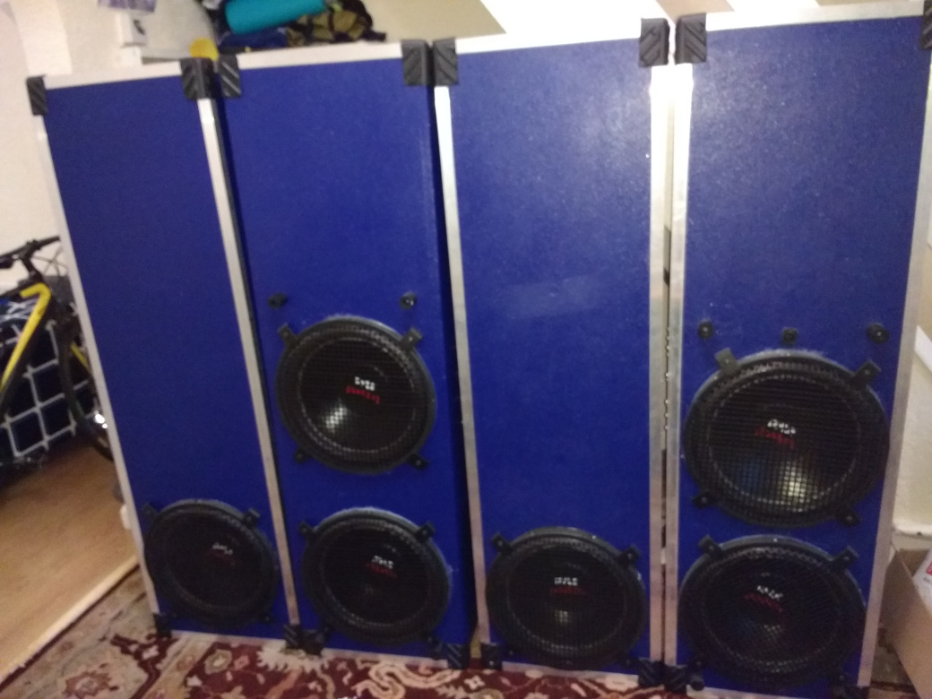

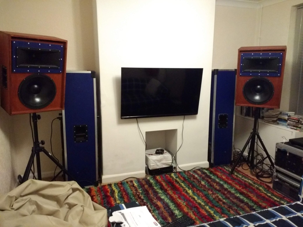

Here are some pics,
subs are in the four corners of the room for even bass. Two have 4 drivers and two have 2 drivers, I run each pair off a separate amp channel on the inuke. Tops are three ways with a plastic 90x40 horn modified to be a multiple entry horn. This allows me to cross to the mid-bass at 500 Hz keeping everything point source.
DSP is Symetrix 8x8 modified to have no fan and a Cobranet expansion.
Amps are Apart pa 2120 and inuke 6000. The amp at the bottom is just a spare and not normally used. The racks are internally wired so I can setup quickly.
I can't light the bottom signal light on the inuke without the house sounding like its falling apart so I'm planning on moving.

Sounds like you have your priorities in order!

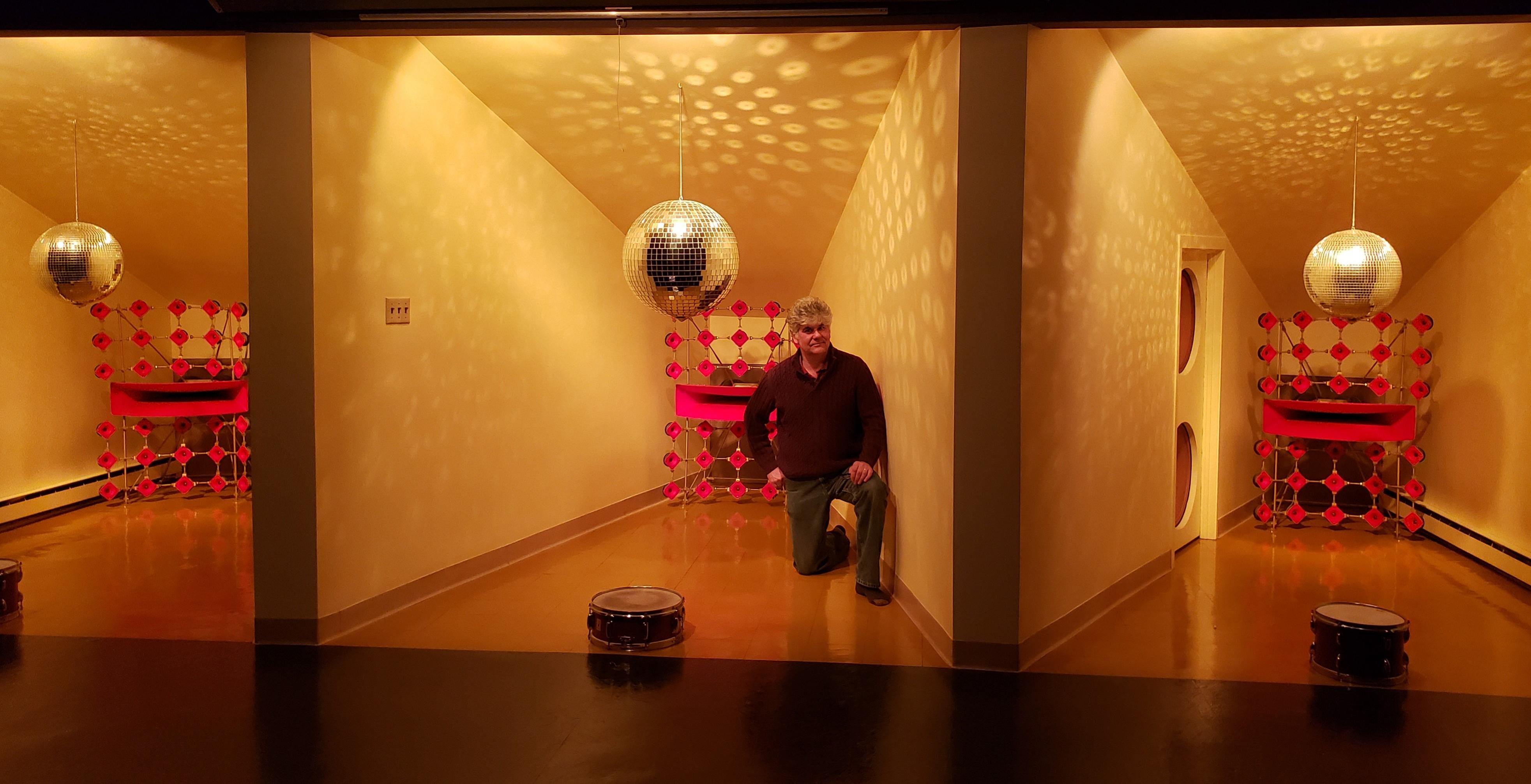

The gentleman who built this house, on the other hand, *did* think far enough ahead... that's me, inside one of his speakers ;0)

To get this very vaguely OT, the door that can be seen on the right (the one with 2x 24" woofers in it) is one of two similarly-equipped doors leading into the amp room. Fairly classic IB situation... no concerns whatsoever about amplifier fan noise!
I'm waiting to see if anyone out there is old enough to recognize this system. I was 13 when it appeared on the cover of Audio, it did a lot to create my obsession with big sound systems. To somewhat randomly have a chance to climb into the picture 43 years later was pretty trippy.
Sorry about the derailment, btw. I've been cooped up in my office too long.
Pretty darned good, especially considering its vintage (some stuff, like the amps & processing, have been updated, but the driver array is pretty much original).
The thing I would have thought would be a problem (the crazy tweeter array) sounded great. The midrange horns are fed by a manifolded pair of 2" throat (JBL??) Alnico CDs that looked a lot like like the Gauss CDs I had back in the 80's. Dick's system's midranges occasionally exhibited a honk that I found to be a bit unfortunate, depending on the program material.
I just thought of a bad pun: His system puts the 'Home' in 'HOM's.
But overall it was tremendously satisfying to listen to. The dynamic range was pretty infinite, which was fun. 4x24" IB woofers mostly keep up with everything else, unless you're going bonkers playing organ music, which we were.
What trumped the relatively minor flaws was that A) The room is amazing, aesthetically (grooooovy, baby!) and acoustically, and B) The program material was great.
Dick used to have pretty thorough access to performances at Jordan Hall, the Great Organ in Methuen MA, etc, and from what I can tell from looking at his catalog of recordings, just about anyone that he asked to come to play in his own room must have said yes. So a lot of what he plays back on that system for visitors is stuff that he recorded himself way back when, on microphones he built, amplified by preamps he designed (etc, etc), and mixed down and mastered specifically for that system, on that system. Overall, the effect was pretty astounding. I'd say that evening is tied for first place for the most fun I've ever had listening to someone else's playback system.
I did come away feeling a tad unworthy, though; for soup-to-nuts DIY, he's about as real as they come.
yep I have read about this system its very impressive, how does it sound?
