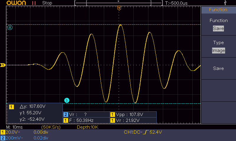

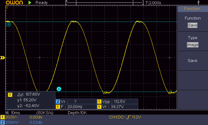

Here are some super basic tests on the CTS4200. Test condition is just CH1 loaded with a 4ohm test load.
1) 50Hz CEA-2010 waveform with gain adjusted such that waveform is just beginning to clip. 108Vpp, 363W/4R.
2) 20Hz tone burst at end of 100 cycles (5s), I wish I could show the full burst but my scope has tiny memory. Its a quite clipped but that me not bothering to set the gain exactly correct. Basically this is the same at the start and end of the 5s burst. The fan did not turn on doing these bursts, it only turns on when the output is run at this level for longer time periods.
This is an amplifier with a switch mode supply and class AB bipolar amplifier so these results are to be expected as the power supply is regulated and a single amp channel is insufficient to force it out of regulation. The spec for this amp claims 270W/4R for a single driven channel at 0.1% THD, it would seem to be more than capable of meeting this spec.

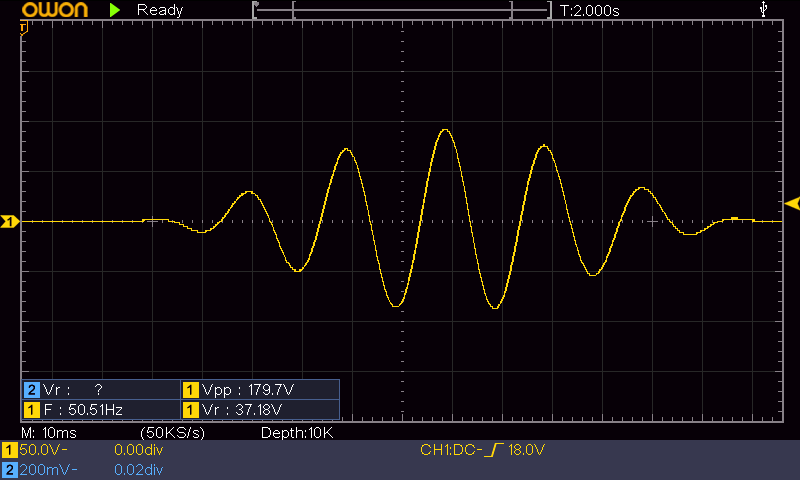

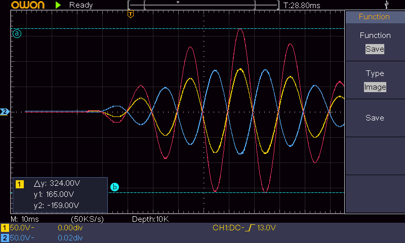

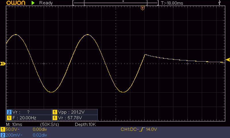

Here are the test results for the P7000s. Unfortunately repeated 20Hz sine wave bursts appears to have damaged* it when bridged into 4 ohms (the one burst rating in the manual made me curious).
1 channel / 50Hz CEA-2010 / 4 ohm = 179.7 Vpp = 1008 W
1 channel / 20Hz sine at end of 100 cycles / 200 Vpp = 1250 W
Bridged / 50Hz CEA-2010 / 4 ohm = 324 Vpp = 3280 W
I used the maths function to make a pseudo differential probe for the bridged burst result so the individual traces will have ground noise on them that's canceled in the maths trace.
So quite a good amp for getting a lot of power into 8 ohms (probably around 2 kW but I don't have a load to test this) or 2*1kW into 4 ohms.
*Took the top off to start fixing it and it now powers up again so presumably some kind of protection was triggered, still don't bridge it into 4ohms...

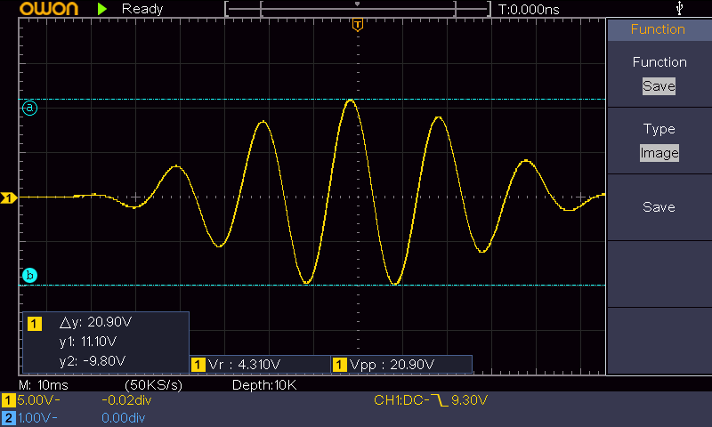

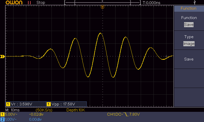

I used a 100x diffirential probe for these measurements so multiply all voltages by 10x in the scope traces. This amp appears to be a class-AB with SMPS in that it can (with one channel loaded with 4ohm) sustain peak output indefinitely. I did not try sustained sine waves in bridged mode as although I am relatively confident from my experience of Crown amps that it would survive I didn't want to take the risk. This amp has a built in defeat-able DSP with crossover, delay and PEQ which is quite handy.
During light use the fan stays off (yay). When the amp is running at full output the fan turns on after about 30s and stays on for a couple of mins after power output is reduced. It is also loud enough it would be very annoying listening to quiet music.
bridge = 209vpp = 1364W (4ohms) (seems to be current limited)
single channel = 176vpp = 968W (4ohms)
so power output is in line with crown numbers, single channel stronger than expected probably because of the low distortion threshold Crown use. I did notice as per the CTS4200 that clipping had to become quite extreme before the clip lights started to flash.

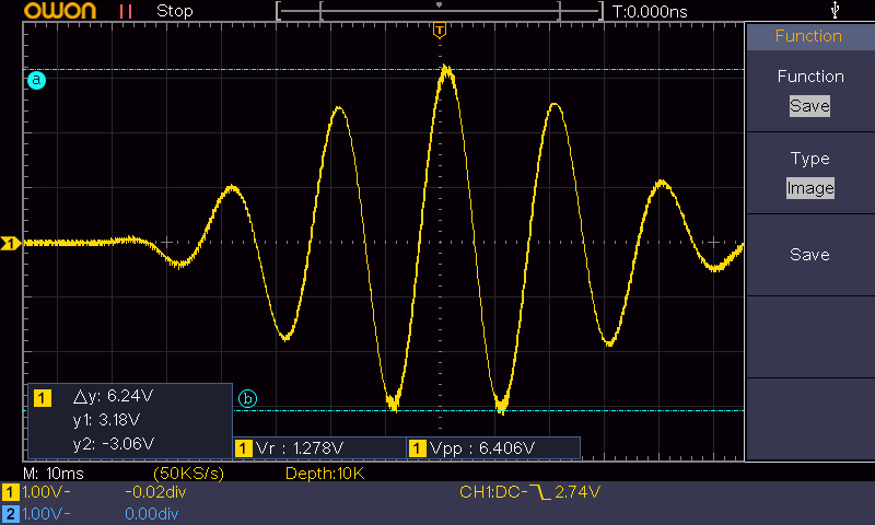

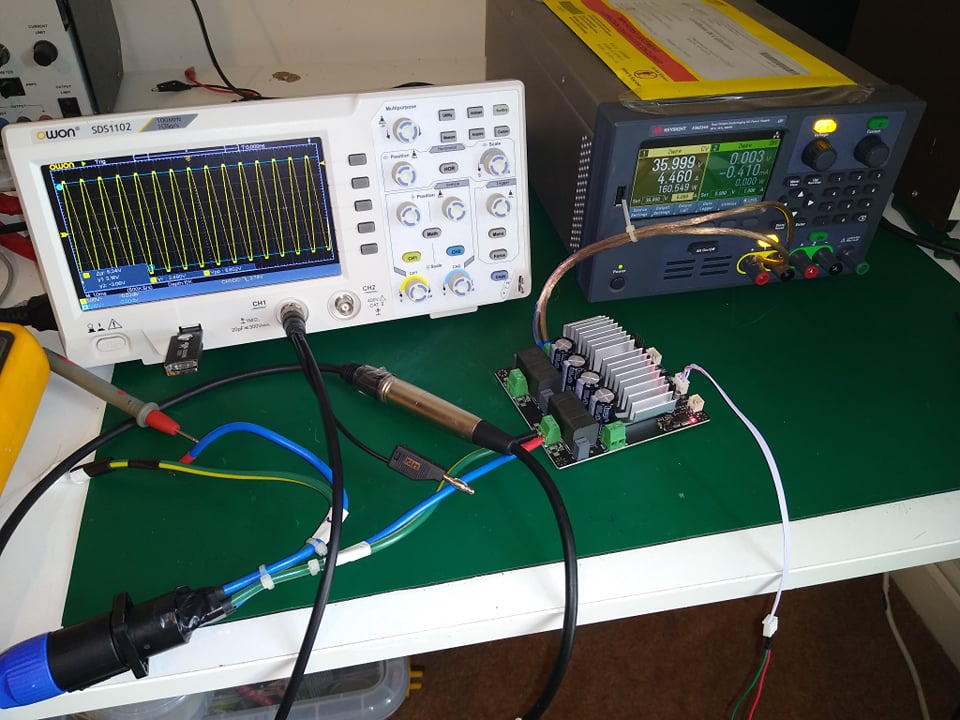

3e Audio EAUMT-0140-2-A (TPA3251 based)
This is a class-D chip amp not a conventional PA amplifier but I am using them in a battery powered PA application and they are silent and cheap (although by far not the cheapest TPA3251 amplifier). I went with the TPA3251 rather than the TPA3255 mainly due to the current supply chain issues and a desire for minimum idle power consumption.
Initially I had issues with the amplifier shutting down and displaying a fault light when I ramped up the power. This turned out to be due to the output of my audio interface not been a true balanced signal which is not normally an issue but in this amplifier each leg of the balanced signal directly drives each side of the bridge so one side of the bridge was held at gnd while the other drove it which apart from inducing early clipping was causing the amplifier to trip into fault mode. So I conducted these tests in SE mode using only the + signal and gnd. I did not have any further shut down issues.
The amplifier seems very efficient not getting more than warm when running at full sine wave power for minutes at a time. Sine wave output power is the same as burst.
64vpp = 128W (4 ohms).
