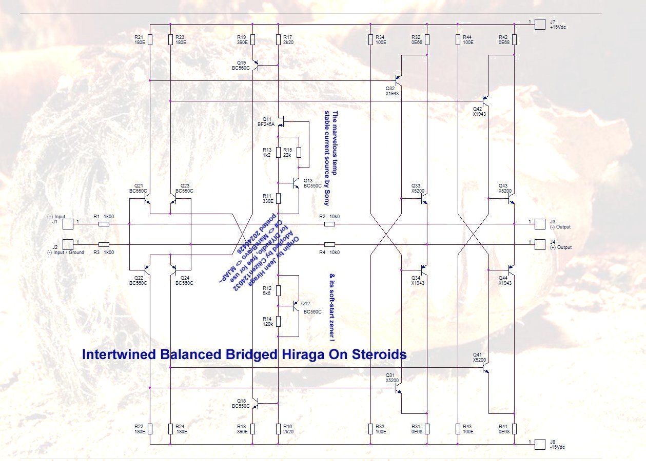

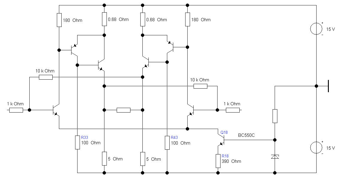

That cs is ultra stable, and with the rubber zener guarantees bumpless swiching on/off.
Please explain in detail how the complete interconnection between the nodes q19_base and q18_base works.
Also what or who is thermally coupled to whom.
By the way, do you have enough components to select /and match them exactly and form pairs?
I'm curious what doesn't match, as regards connections of I/O and feedback.
Sorry, I didn't mean to make you feel insecure.

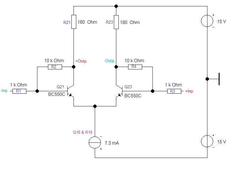

Quickly, let's take a BJT, simplified representation - and consider C as the output node, then B is the inverting input with respect to C and E is the non-inverting input. If we now look dynamically at the two inputs, we can clearly see different impedances.
Ideally, number 1 would be infinitely large and number 2 infinitely small.
This is the case with the Hiraga (also with the SuSy), but not with the SuperDuper "HeadSea".
In the Hiraga, the resistance ratio Rf/Rn does not determine the resulting bandwidth, in the Hiraga it is completely independent of this. fh is determined here by the size of the negative feedback resistor Rf alone and can therefore also be specifically adjusted.
If I am not mistaken?, but I can of course check this.
Hopefully this (as a pointer) will shed some light on the situation.

The Hiraga and the Mark McGwire Hiraga certainly have different feedback topologies. I was referring to the SUSY, which appears to me to use the same feedback topology as citizen employs.

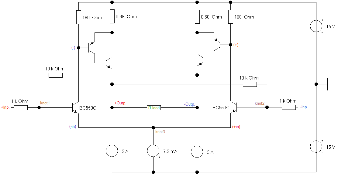

Citizen124032's idea doesn't really have anything in common with J.H. Design, anymore and unfortunately the circuit doesn't fulfill the criteria of the N.P. SuSy, but it is definitely a kind of X-Amp. To put it clearly - a bridge amplifier, nothing more and nothing less. I doubt whether it will ever see the light of day in working order.
Have you already considered the "ultra-stable cs"? Or modeled the entire circuit as a control loop?
Let's have a break for now,
HBt.
The X
I hope that the two attached sketches* will help us to understand and provide further arguments and explanations.
*simplified

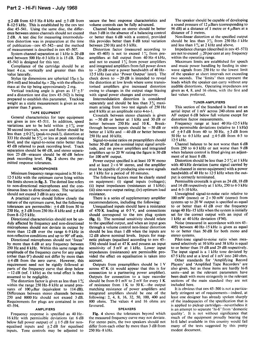

And I think you can also contribute a concrete dimensioning - perhaps a small 5 to 10 watt audio amplifier that at least fulfills the ancient HiFi DIN standard - i.e. is suitable for everyday use and reliable.
Since you mentioned the "old" DIN 45500 norm i ll just point an observation since sometimes the path of a road can be better understood when starting from its end rather than from its beginning.
It makes about sure that there s very few speakers, if any, that are up to even the most miserable amplifier assuming that
it s just a little above this norm, as speakers distorsion is on the order of a few percents, and that s why almost all amplifiers
will sound good enough unless there s a gross misconception in the design.
We can routinely talk of 0.1dB linearity within 20-20KHz, but is everyone sure that his speakers are just within the DIN 45500 norm?
So in a way concentrating the efforts on the amplifier is just constantly reinventing the wheel while never adressing the most rustic part of the vehicule to wich it will be attached, or to use a more vulgar expression to feed a pig with some very refined cuisine.
Reactions: hbtaudio

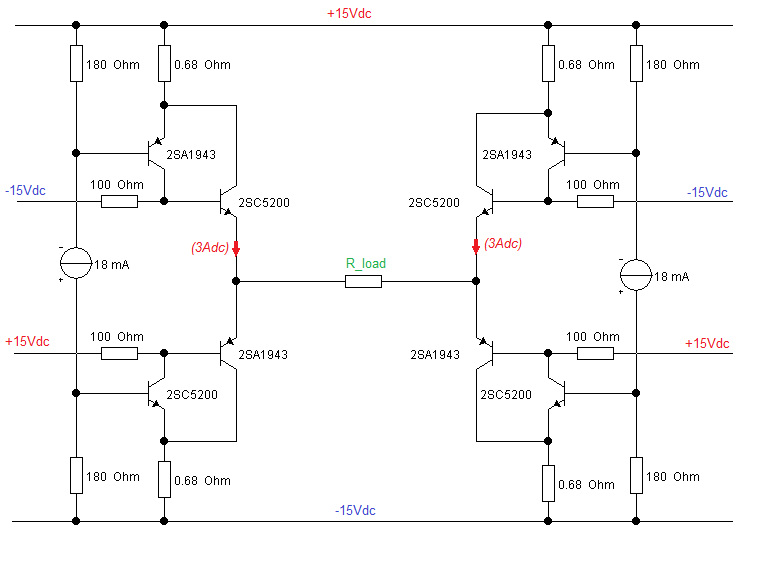

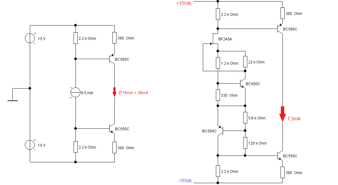

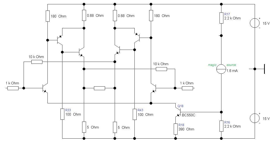

The ultra-stable and magical source / sink
Dear Citizen124032,
are you absolutely sure that your design is actually mature, functional and practical - or is it just a wish, a belief?
I have my doubts. But in the end, the test setup/experiment will bring ultimate clarity.
In any case, I wish you success.
kindly,
HBt.

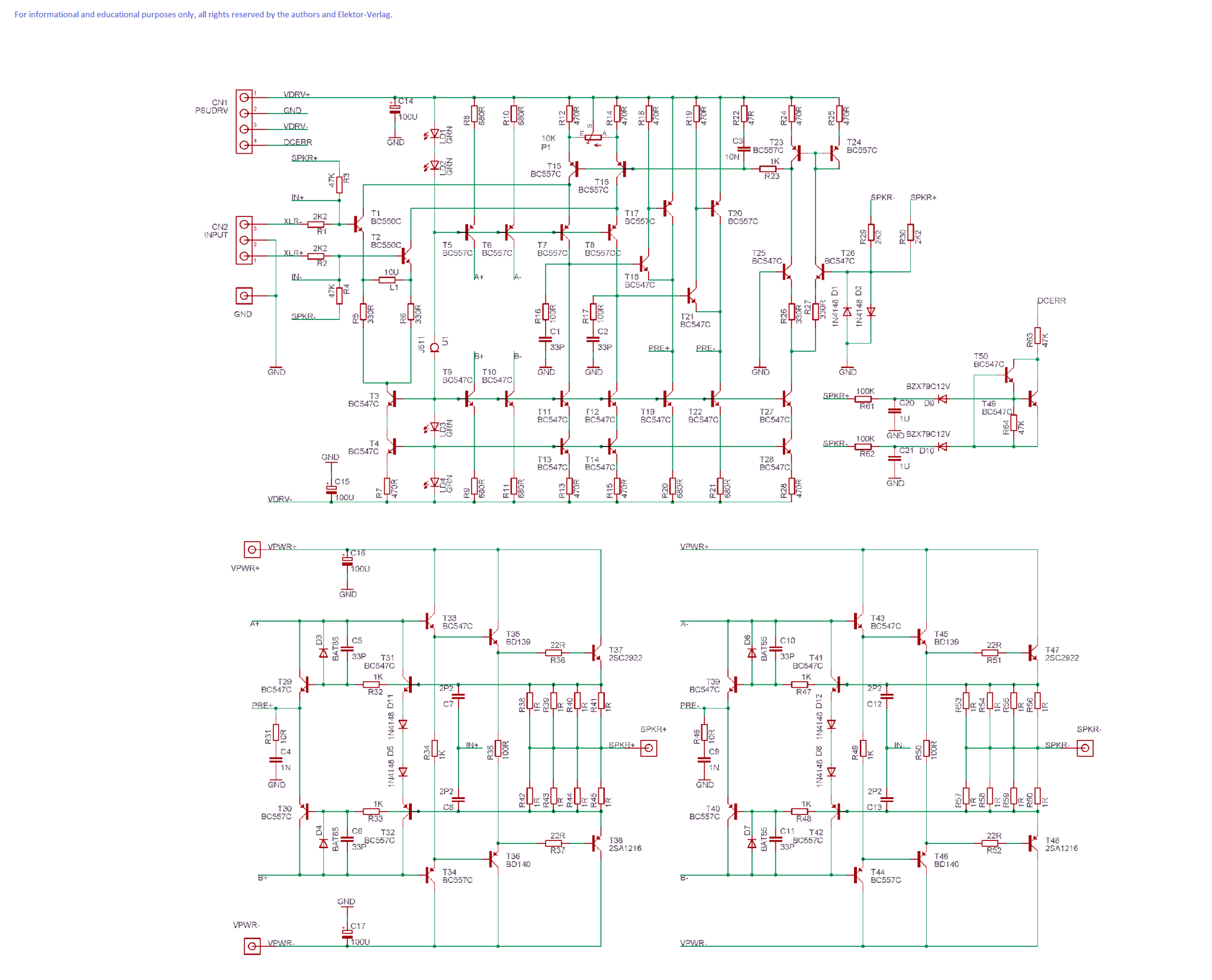

Extrem-A
The commercial use is not permitted without the express permission of the authors. With questions and general questions about the design can be directed to
the authors at bruno@hypex.nl and ssassen@hardwareanalysis.com.
I don't know when the Elektor article on the "ExtremA" audio amplifier was published, but its promised output in Class A mode is said to be a full 100W PowerAmp
This is a bridge with +/-30Vdc Rails and autobias!
Unfortunately, the entire article requires an infinite amount of tolerance for the written German word.
I hope the translation AI smooths out the gibberish of the German edition.

Again:
sqrt(2) * sqrt(50W / 6Ohm) = 4,082A_peak lead to 100W_peak equal to 50W_rms; 50 watts in operating class B, I now consider it a bit far-fetched to deduce 2Adc as a permanent quiescent current. Unless, of course, we calculate the dynamic case a little bit to nicely for the push-pull class A-operation.
Iq =
1/2 * sqrt(2) * (60Wp/8Ohm) = 1/2 * sqrt(4*30Wrms/8Ohm) = sqrt(4)/2 * sqrt(30Wrms/8Ohm) => sqrt(30Wrms/8Ohm) !
So, now we are back to the classic, 1.94Adc (for the 30W HeadSea).
100W(RMS) under a static load of 8Ohm now leads to a quiescent current of 3.54Adc for the ExtremeA - and to 0.184Ohm for the obligatory emitter resistor.
Only the single-ended circuit must carry at least the peak current of the load (expressed as Iq) as quiescent current. For push-pull, it is half this value.
One last question
Since 'HeadSea' is also a classic push-pull amplifier, Iq_8=1.94A (or Iq_4=2.74A) should be sufficient and this would allow us to reconsider the basic component dimensioning.
Or should the anabolically upgraded amplifier actually be designed for complex loads of less than 4 ohms (under full scale and power) ?

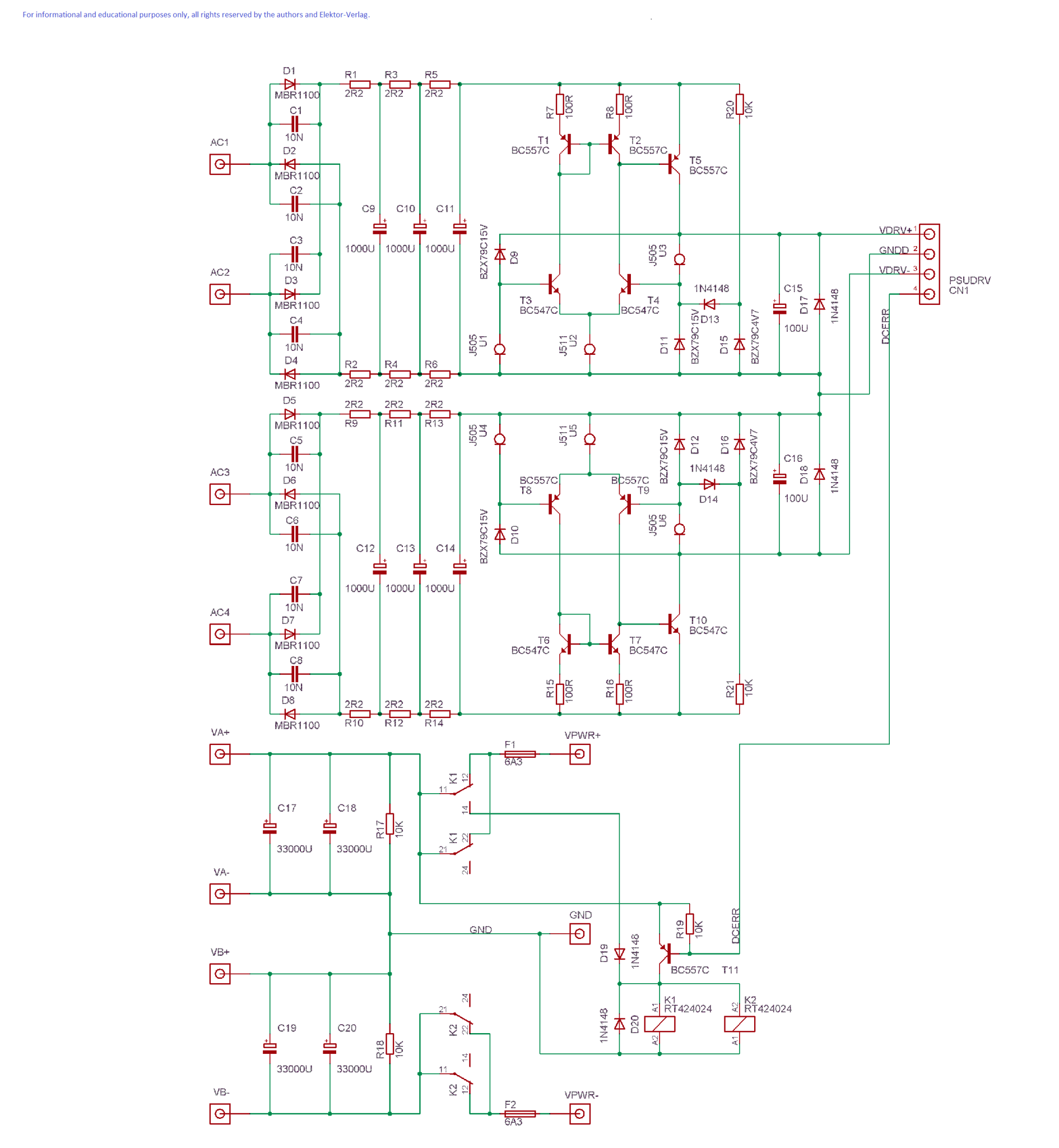

At the end of a journey, every dazzling bubble bursts, including the so-called draft (the authors' formulation) 'ExtremA' - which nevertheless led to a final amp and an incredibly poorly formulated article.
I suspect that Citizen124032 also knows the article, but I only found it by chance today in a German high-end forum.
Let's summarize:
Class A can mutate into a very demanding challenge - or it can be quite simple.
