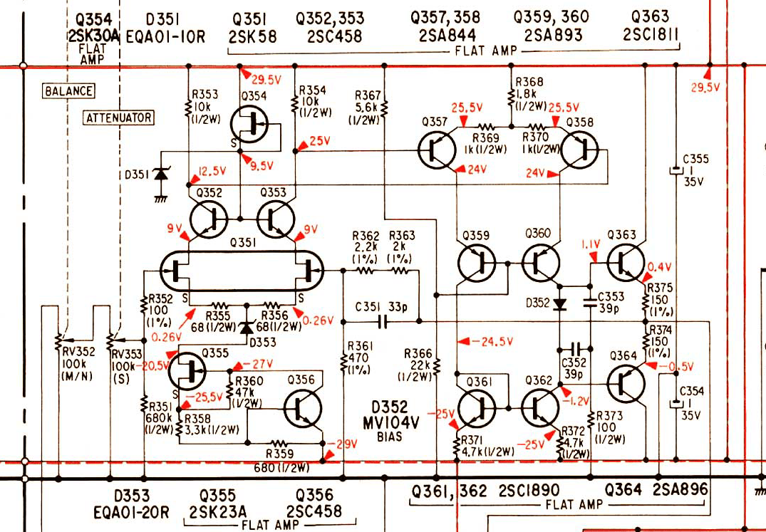

That s a uselessly complex schematic, and what is funny is that there s a misconception as soon as the signal enter in the amp,
namely in the input differential stage whose linearity is intrinsically limited, i guess that at the time they thought that getting
stable standing currents was the end of all and that it was enough to yield the best possible linearity.
Given how an amplifier work if the input stage linearity is limted so will be its ability to correct the non linearities by mean of global negative feedback whatever the linearity of the following stages, as the error introduced by the first stage cant be corrected by the NFB provided by the following stages once the loop is closed, be it a VAS with 150db gain.

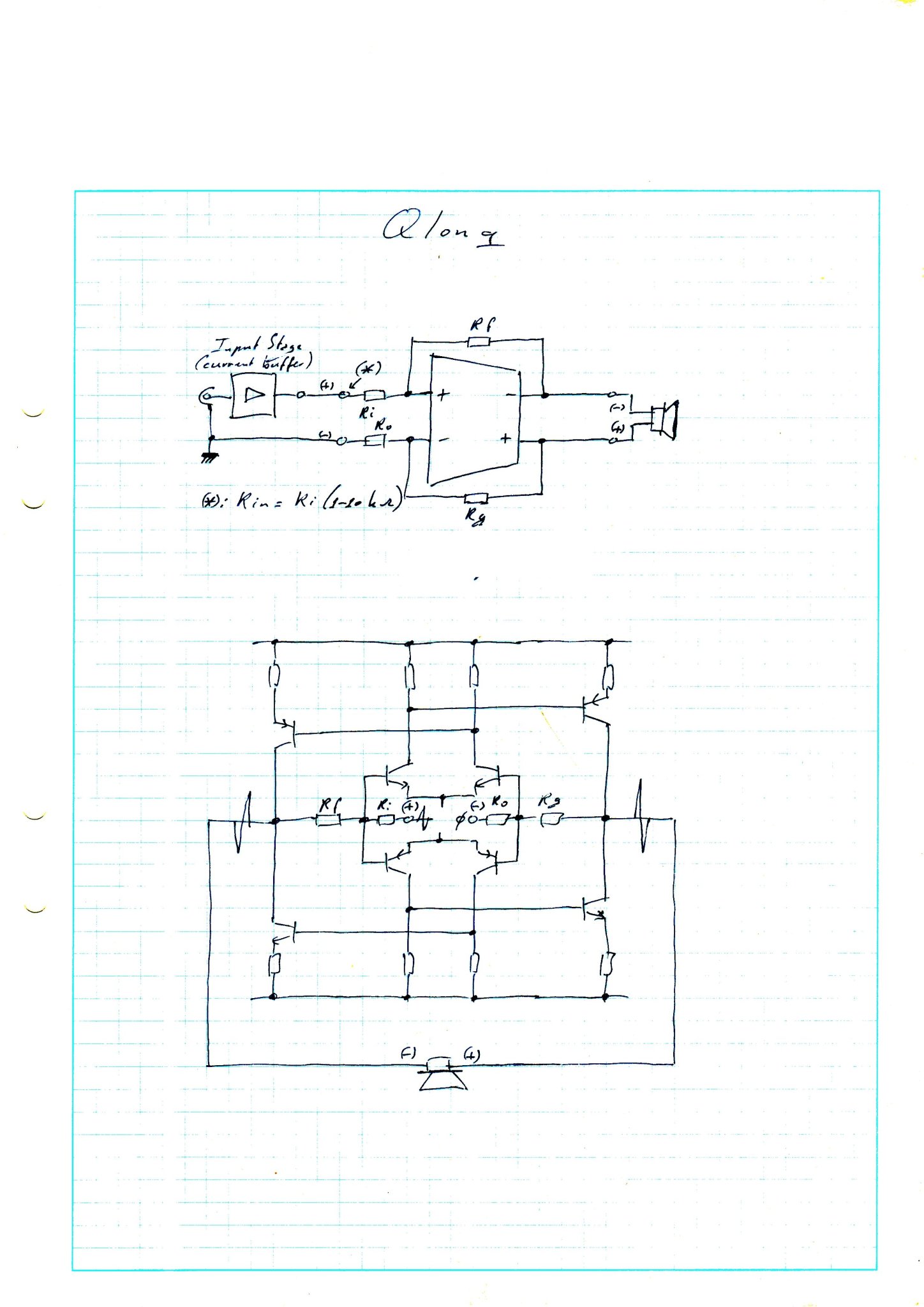

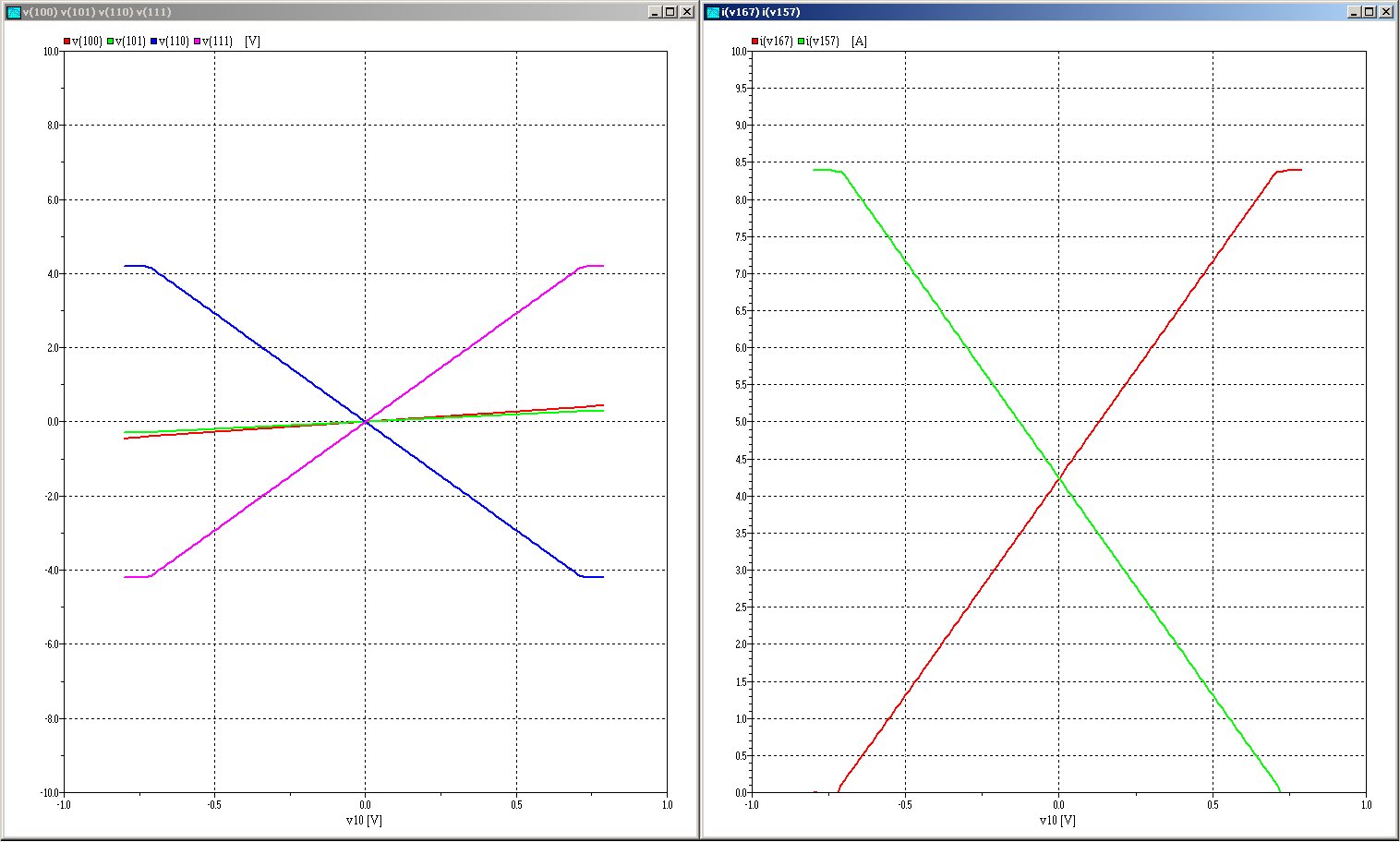

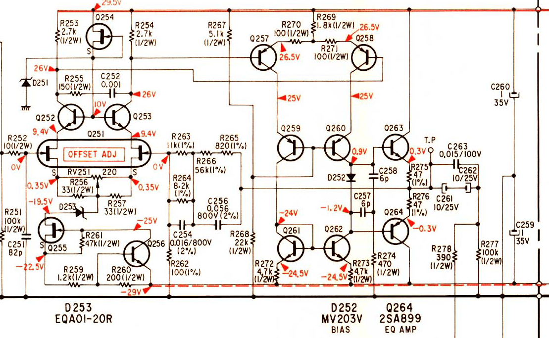

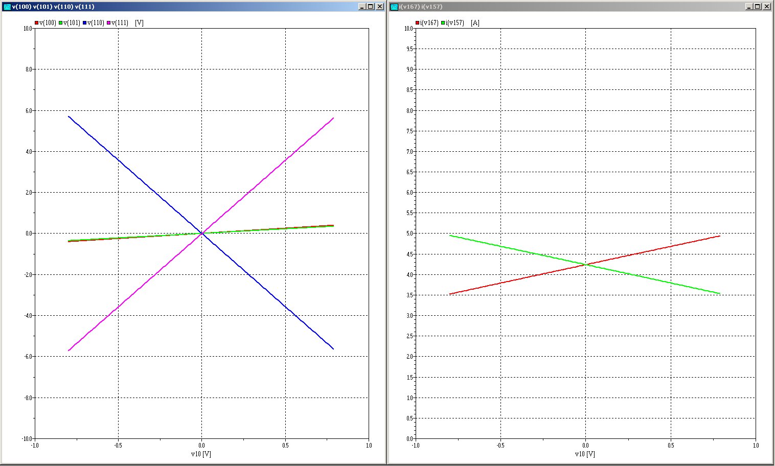

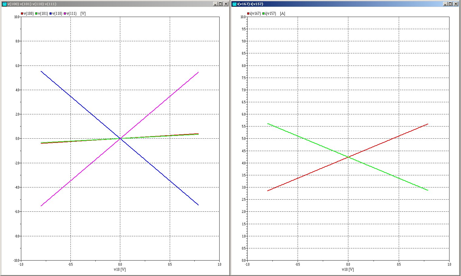

Please explain in detail how the complete interconnection between the nodes q19_base and q18_base works.
Also what or who is thermally coupled to whom.
By the way, do you have enough components to select /and match them exactly and form pairs?
Fet's and BJT's have opposite tempco's (by Sony, in the 80's).
I do not prefer to select from oceans of components, as the industry does not either. The circuit design should cope with that.
The build in #126 consisted of a buy of 20 pairs, from which 4 pairs were deviating very much.

You re welcome, as for Elektor statement that there s no mesurable THD + IMD it sound to me somewhat prepostperous,
class A and the EF3 help a lot but there s nothing in this design that would cancel any distorsion unless it has excessive
GNFB at high frequencies and is hence discutable stability wise.
One can design any possible circuitry it will be inherently limited by its two amplifying stages in this case, the intrinsical
non linearity of the transistors and the forcibly low NFB at 10-20kHz, there s no workaround for this limitation and increasing
the transistor count above the necessary one is just cosmetic.
Finally i get back to where i started, that is, the speakers wich have always orders of magnitude lower linearity than about
all amplifiers, you ll notice that Elektor never ventured in speakers design, and for a reason, all the difficulty is in this domain,
find a very good pair of speakers and suddenly all debates about amplifiers will appear for what they really are, an infinitesimality.

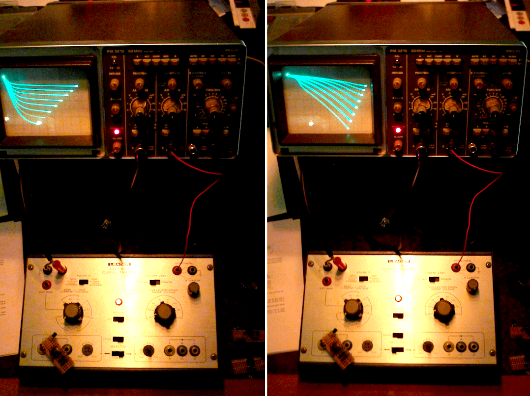

Keep in mind that this design configuration was conceived for another purpose, as stated in #87, last sentence.
As the lower circuit in #130 shows, the outputs are collector-collector nodes, and not stable without feedback.
That corresponds with NP's SUSY, but I've never encountered that design before mentioned in this topic.
Leaving the Sziklai's behind, low output impedance compounds (alike V-fet's) to replace them.
This development is on a more active pace the last few years and is taking considerable time, but publishment is unsure as publishers are not eager to adopt 'vacuum technology' in their portfolio.
In the photo, the output characteristic of a standard (left) and modified (right) compound is shown (both flipped though).

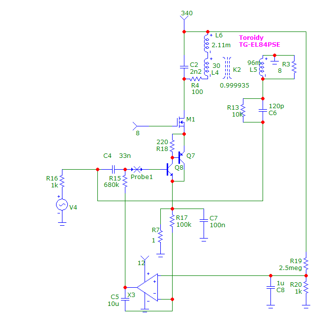

Like in my case, with ear-speaker distance ~0.7m, 1 watt output already is loud. To enjoy "somewhat green" class A, one would have to start with a modulated current source with sufficient GNFB. When the reference voltage for the current source is derived from the supply voltage, lowering that lowers power and in such a way that at any given volltage the setting is optimal. My theoretical approach started (for a 2.5k output transformer) with this sim. The final and much improved version will be constructed probably end of this year.
