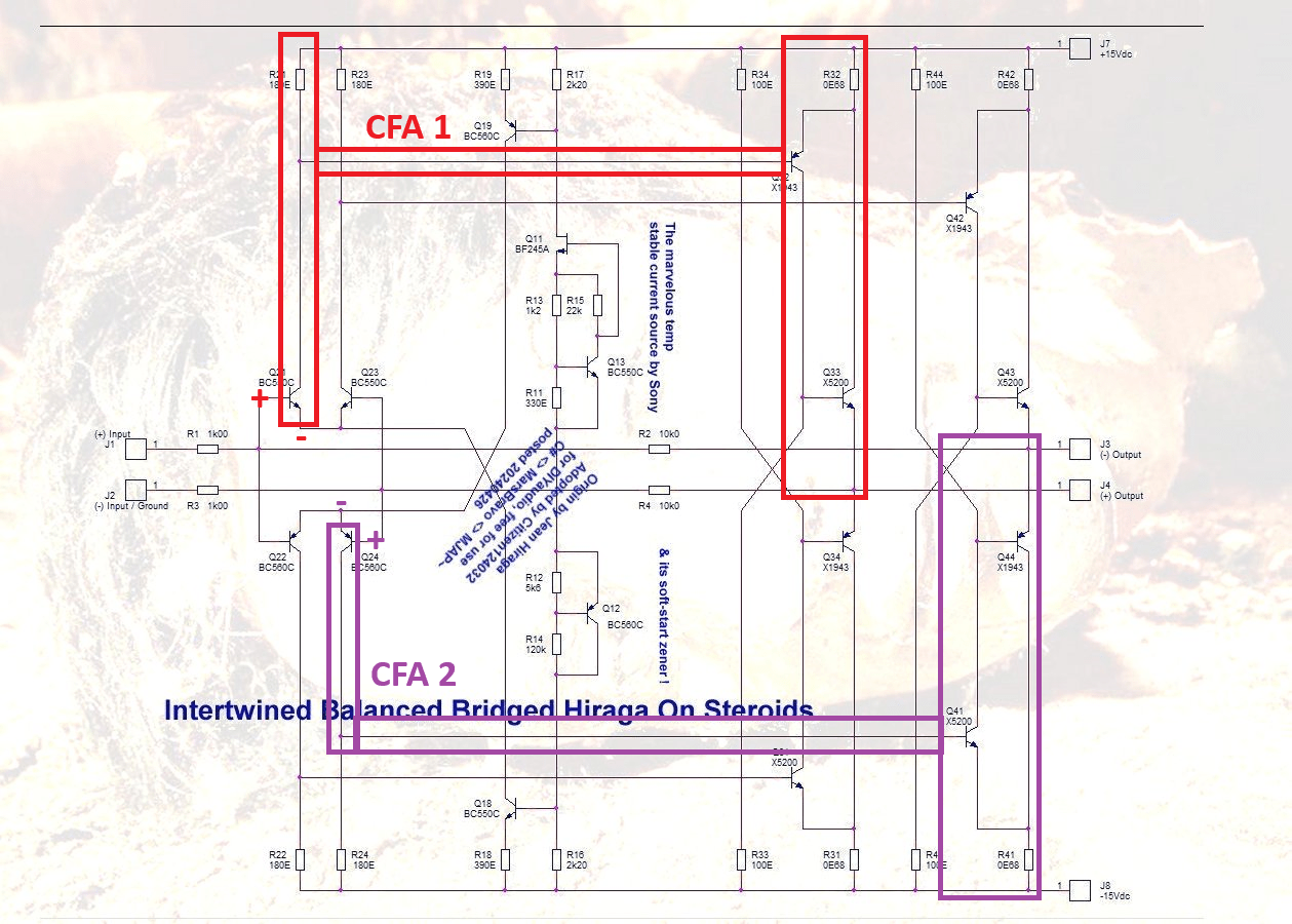

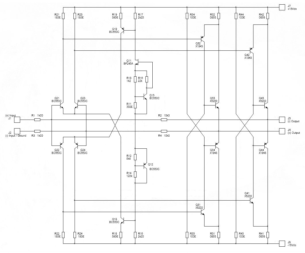

One notice the absence of e-deg at the input diff's which should be there.
That cs is ultra stable, and with the rubber zener guarantees bumpless swiching on/off.
Inverters are not often seen, let alone bound instumentation front end couples.
Accepts asym and sym signals alike, even unbalanced sym signals, and ease them out symmetrical at the output.
All is running quite hot, for other reasons.
Supply rails at twice value demands extra output legs, but simu's are ok with it.
Another simu is a naked (no ri) ac source at the outputs driving into those output legs; guess.

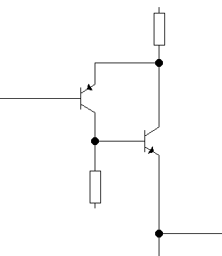

This circuit was designed for another purpose: getting rid of the marvallous Sziklai's in favor of compound solid state triodes, consisting of two active devices and some resistors only. A collector-collector output alike the V-fet 4650/5650 amplifiers. All has become deep frozen now.

It bears some resemblance to Hiraga, an IPS followed by CFP CE OPS, all symmetrical/complementary, but that's about it.
IPS is different in all respects except resistive loading. OPS is class AB with 300mA in outputs and 150mA in drivers, whereas Hiraga is class A to 8W and driver current is output current/output beta. Feedback is different, see attachment.

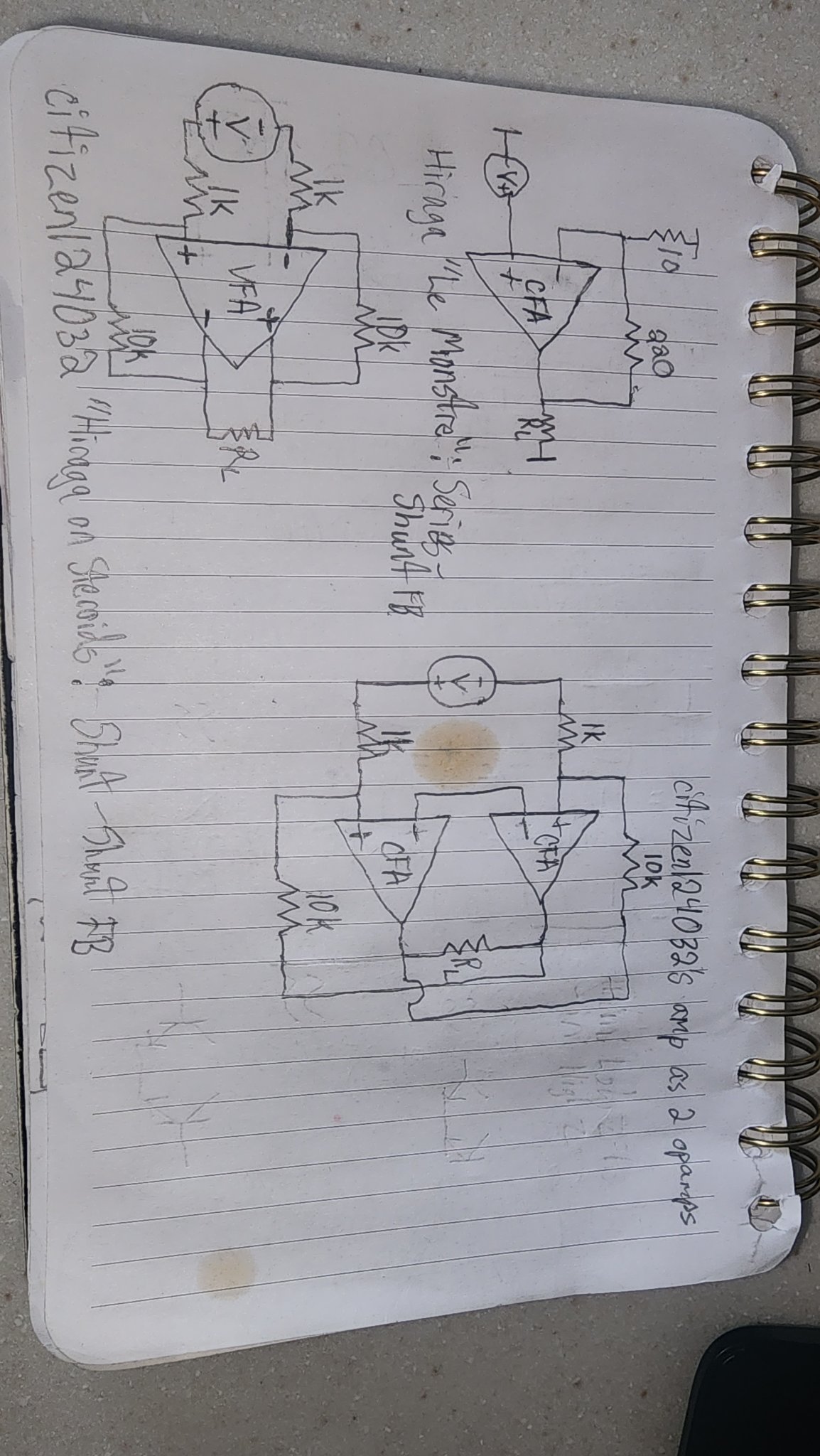

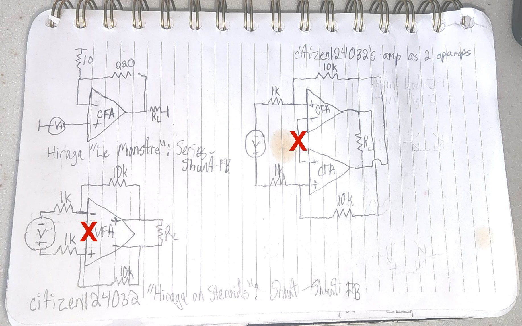

Not quite so.Attachment with op-amp equivalents and various stains
The upper right hand drawing has the inverting inputs connected together to nowhere.
The lower left assumes an inverting and non-inverting input, which does not suit the design.
There is no regular equivalent in opamps actually, not in 'split mode' either.

Now that we know the development idea better, we can analyze it in a targeted manner:
4 times 1.5A equals 6A -> Iq = 6A / 2, i.e. three amps per (entire) output stage.
The power loss in idle state is therefore 3A * 12.96V, approximately 39W per Q33,Q34 & Q43,Q44.
This enormous power loss must be absorbed as thermal energy and dissipated to the environment, the room air, by means of convection.
In total 4*39W = 156W as heating - and there are still a whole handful of other losses missing here.

The top right does not have the inverting inputs connected to nowhere, it has them connected to each other. The negative inputs on a CFA are connected via a low impedance to differential ground. The two op-amps are just a way of drawing an LTP with differential outs followed by another inverting stage, with or without gain. If you look at NP's amp in the thread hbt posted, R0 turns the two independent CFA IPS into a differential pair. R0 is split into two resistors in your amp, the internal emitter resistance of Q21/Q23 and Q22/Q24. Any linear amplifier circuit can be drawn as an op-amp. I've attached an annotation of your amp with the 2 CFAs blocked off and inputs marked (the complementary side for each is part of each as well but not blocked off for legibility).Not quite so.
You're absolutly right!
But as soon as the input stage is modified to a differential, a double inverter 'intertwined' configuration will keep the circuit unconditionally stable.

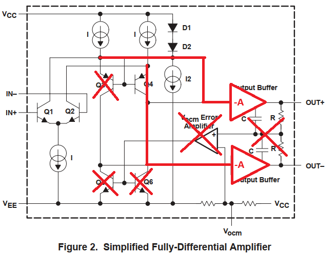

As for the bottom left drawing, see figure 2 of the attached PDF app note on FDAs. Your amp eschews the cascode for additional gain, opting instead for a common emitter Sziklai OPS. Mark-up of fig 2 to show your variant as FDA attached. You used + and - yourself in your drawing. Of course, either one could be considered + or - and neither path internally inverts, but the point of an op-amp equivalent isn't to represent the internals but represent an amplifying device and its external terminals.
I do think it's an interesting design and would be interested to hear more about results of sims and additional performance details.
delivering 30+W running at 4 x 1.5Adc in the totem poles.
Could it be that you wanted to express something else, namely Q+Q+Q+Q = 4Q and used the variable Q=1.5A?
Let's take a look at the class A operation:
(1/2) * (1.5A)^2 * 8Ohm = 9W
This fits perfectly with the rails of +15Vdc and -15Vdc.
Now we bridge and calculate the theoretically possible u_peak.
30V-(2*3V) = 24Vp
(24Vp)^2 / 8Ohm = 72Wp which corresponds to 36W in our class A concept.
The quiescent current must now be doubled, otherwise we switch to AB operation.
In short:
sqrt(2) * sqrt(36W/8Ohm) or also sqrt(72Wp/8Ohm) equals 3 amps.
Now we know that the Iq per branch or output stage must be 3A, unfortunately you have somehow concealed this fact. This cannot be due to the translation AI.
