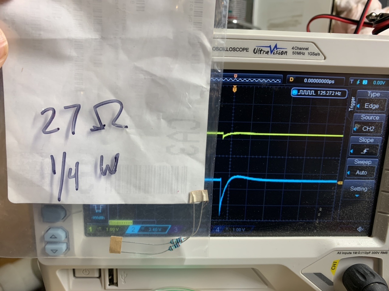

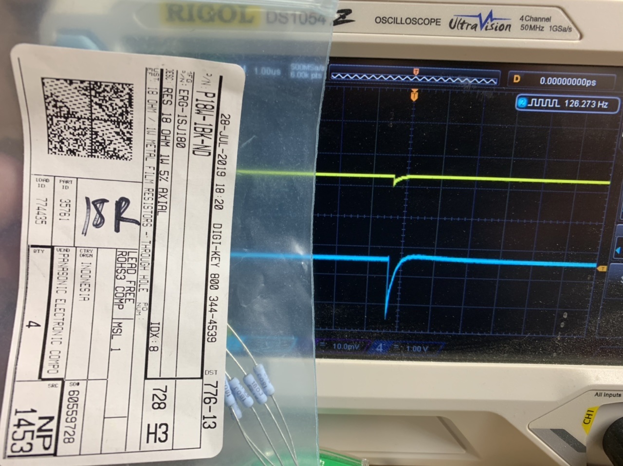

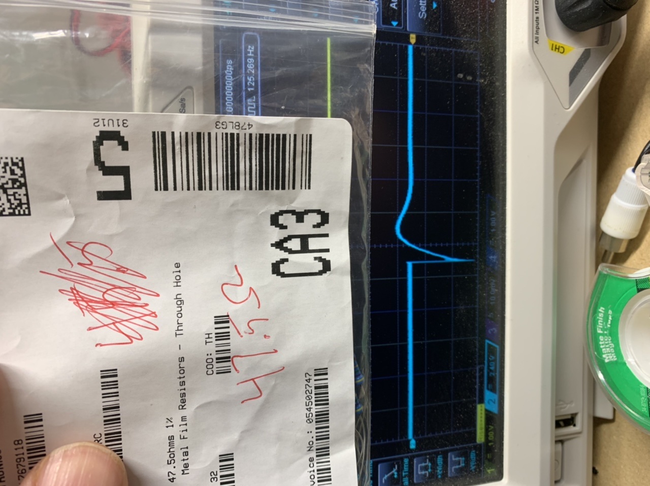

Wow, I just measured the same one yesterday for the F1 build I'm doing. I dropped some fixed resistors in to show my results.

As Sixto mentioned above, there's a range of resistance that works okay so the different versions of the 300va Torroidy transformers will most probably lie within that range and you can just experiment to see if there's much difference in the 'sound' with different snubber resistors, or just start with a middle value and go from there.
It is really satisfying to use the 'ideal' value (the perfectionist in many of us) but in this case it isn't so critical and much better to just add these simple filters and 'fiddle' with that resistor.
Cool. Thanks! I noticed most of the values, for the caps specifically, are more or less completely the same throughout on Toroidy results here. In this case my future trannies will be the exact same as Darrr measured. Target 12 and experiment with 8R-16R?
