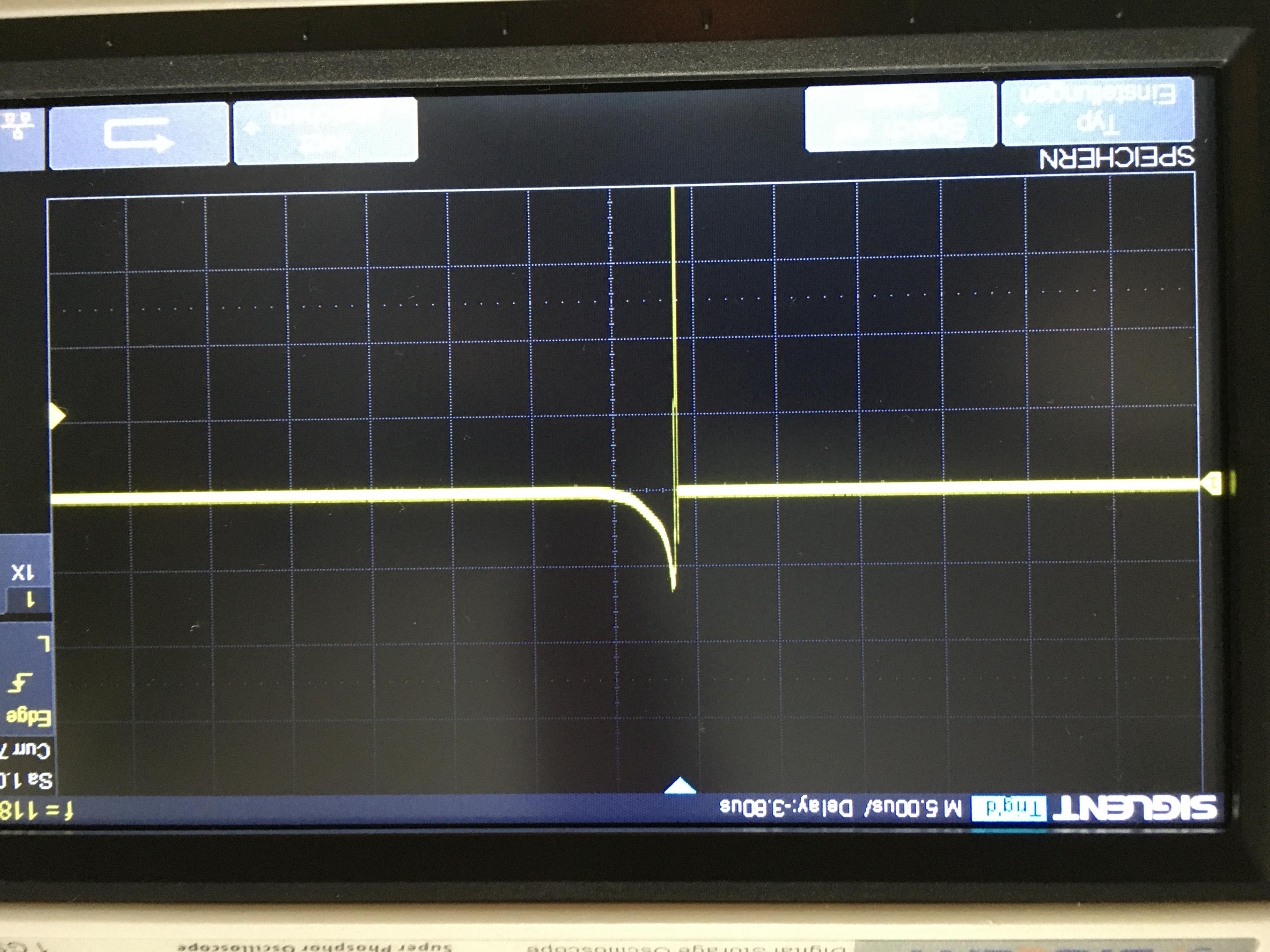

Simple, no-math transformer snubber using Quasimodo test-jig
Toroidy TS400VA 230v 2x18v
13R
Cx 0.01uF
C2 0.15uF

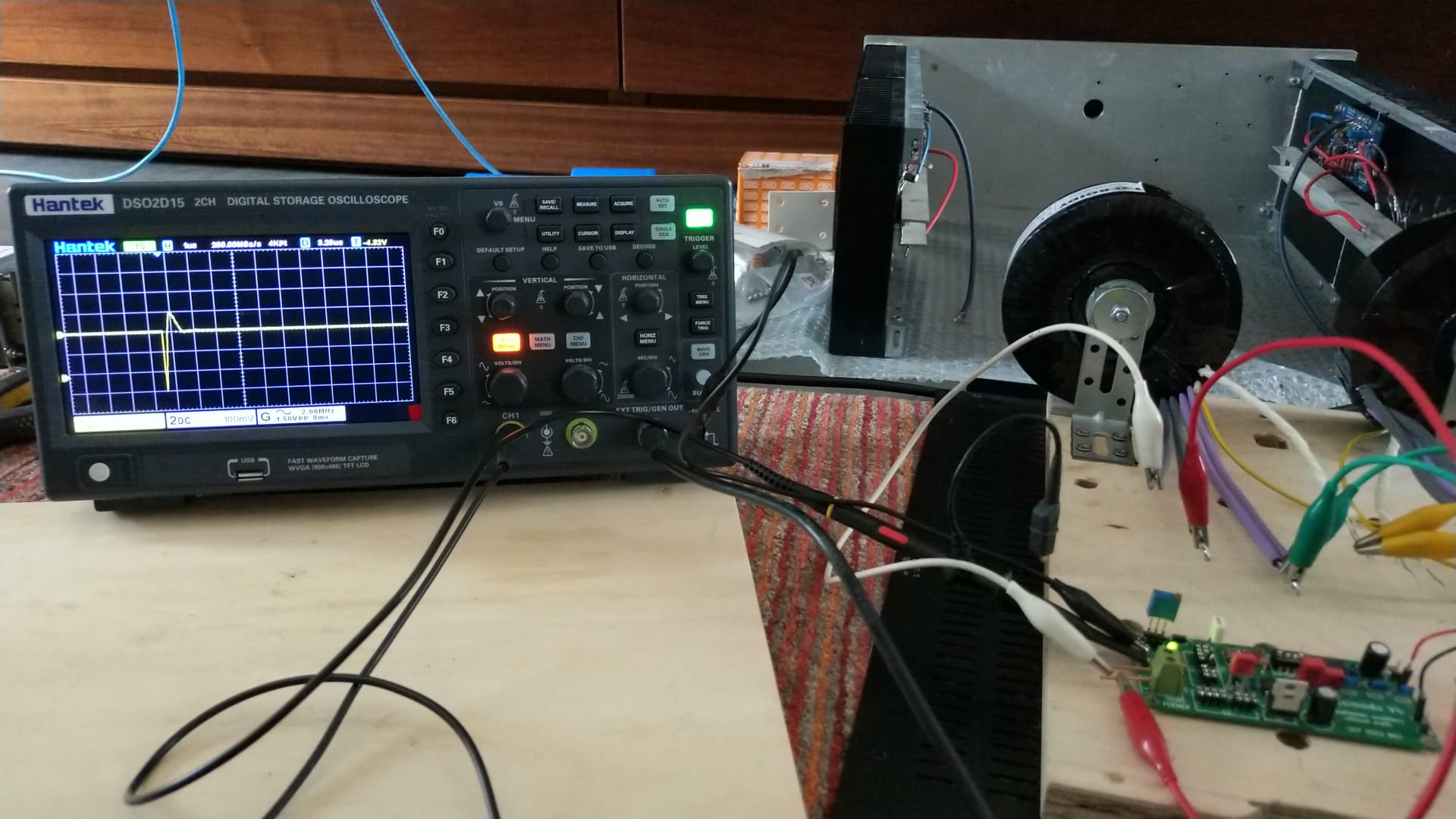

Toroidy TS50 VA 2 x 24 V
Toroidy TS50 VA 2 x 24 V, secondaries independent
Cx 10nF
Cs 150nF
Rs 18.5 R
Toroidy TS50 VA 2 x 24 V, secondaries parallel
Cx 10nF
Cs 150nF
Rs 25.5 R

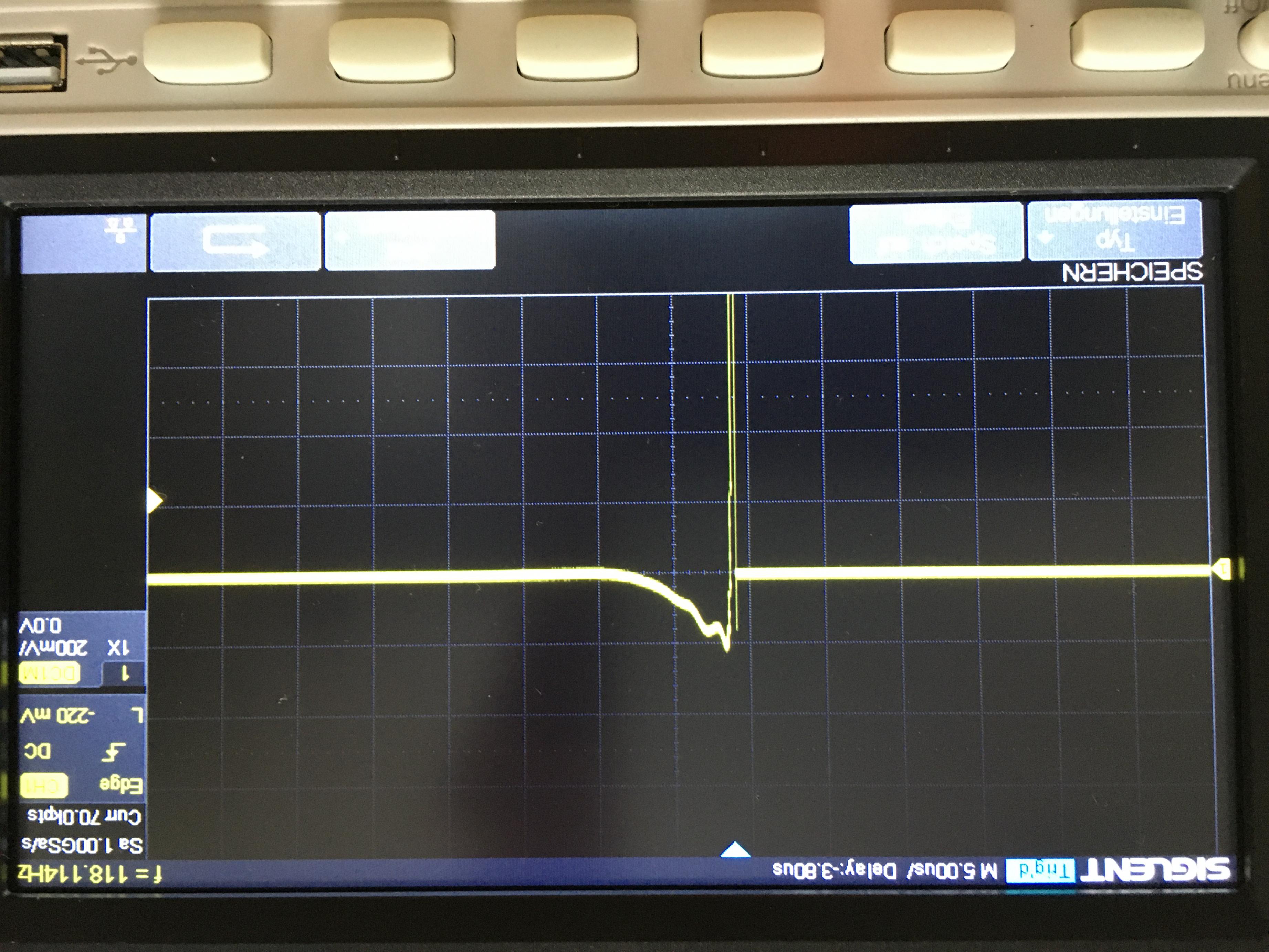

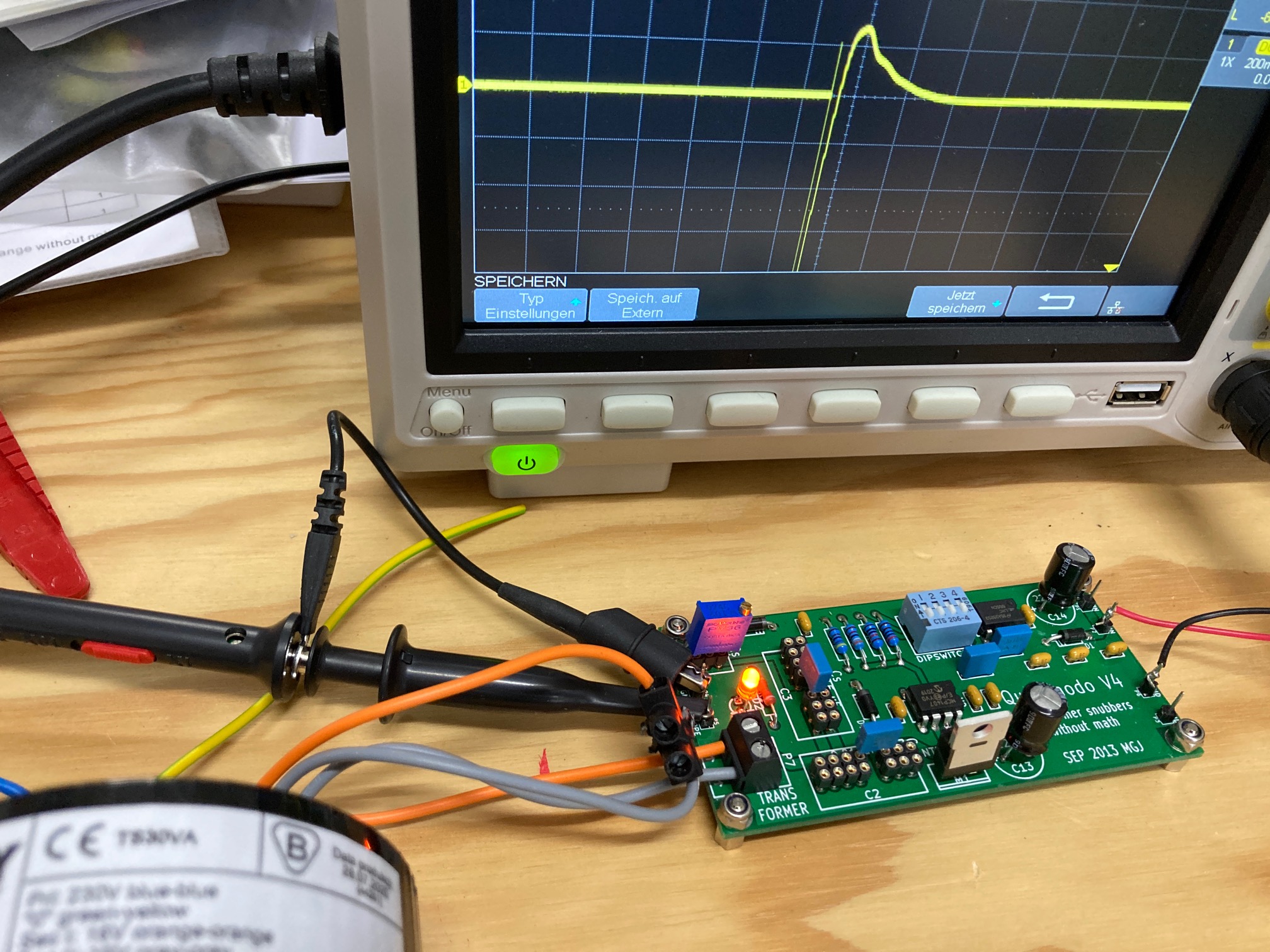

Antek AN-6225 600VA 25+25V
Independent secondaries
Cs: 0.15uF Cx: 0.01uF Rs: 15R
I measured on the scope and my pot was at ~18R.
I had a fixed 15R on the bench that I put into the Quasimodo to test - works great! 15R is in the amp now.

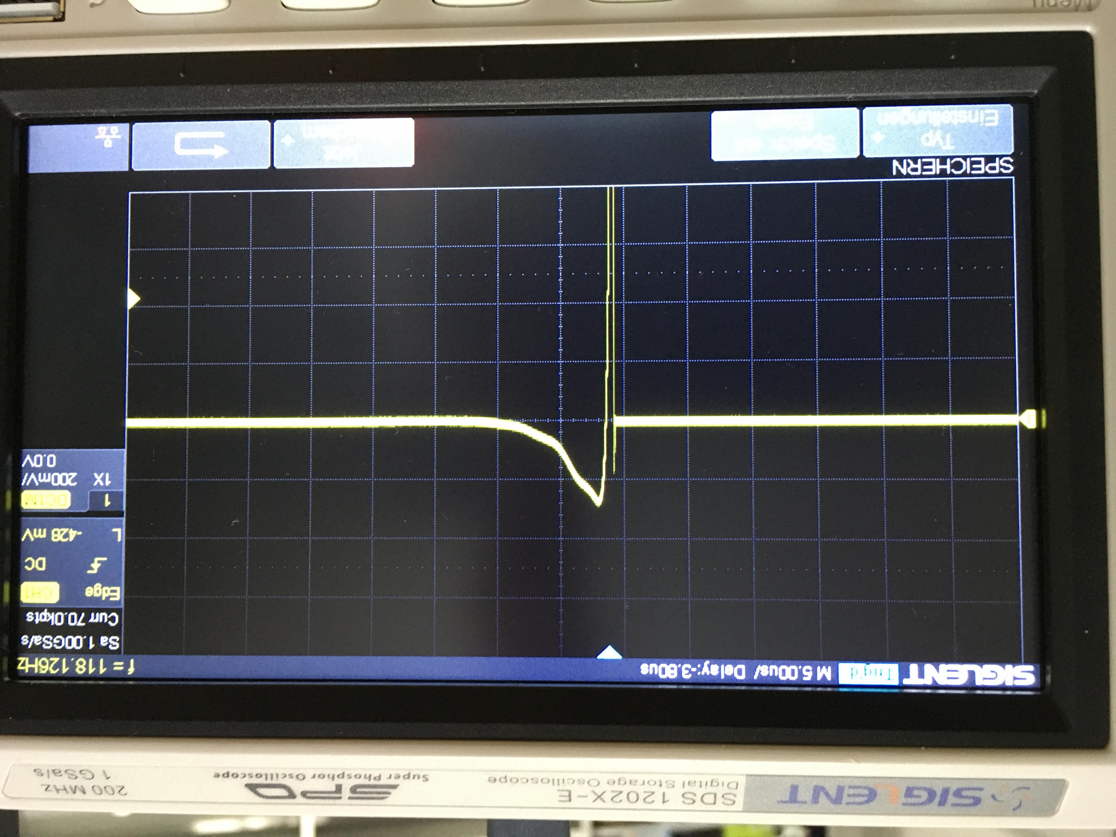

AnTek AS-3218
10-12ohms
Can confirm, got the same range of acceptable values as thompsontechs for my AS-3218 trafo.
Cs = 0.15uF
Cx = 0.01uF
Rs = 7R5 as measured off the pot (actual resistors of 10R to 12R worked fine)
AnTek AN-3236
Cs = 0.15uF
Cx = 0.01uF
Rs = 16R4 as measured off the pot (actual resistors of 10R to 22R worked fine)

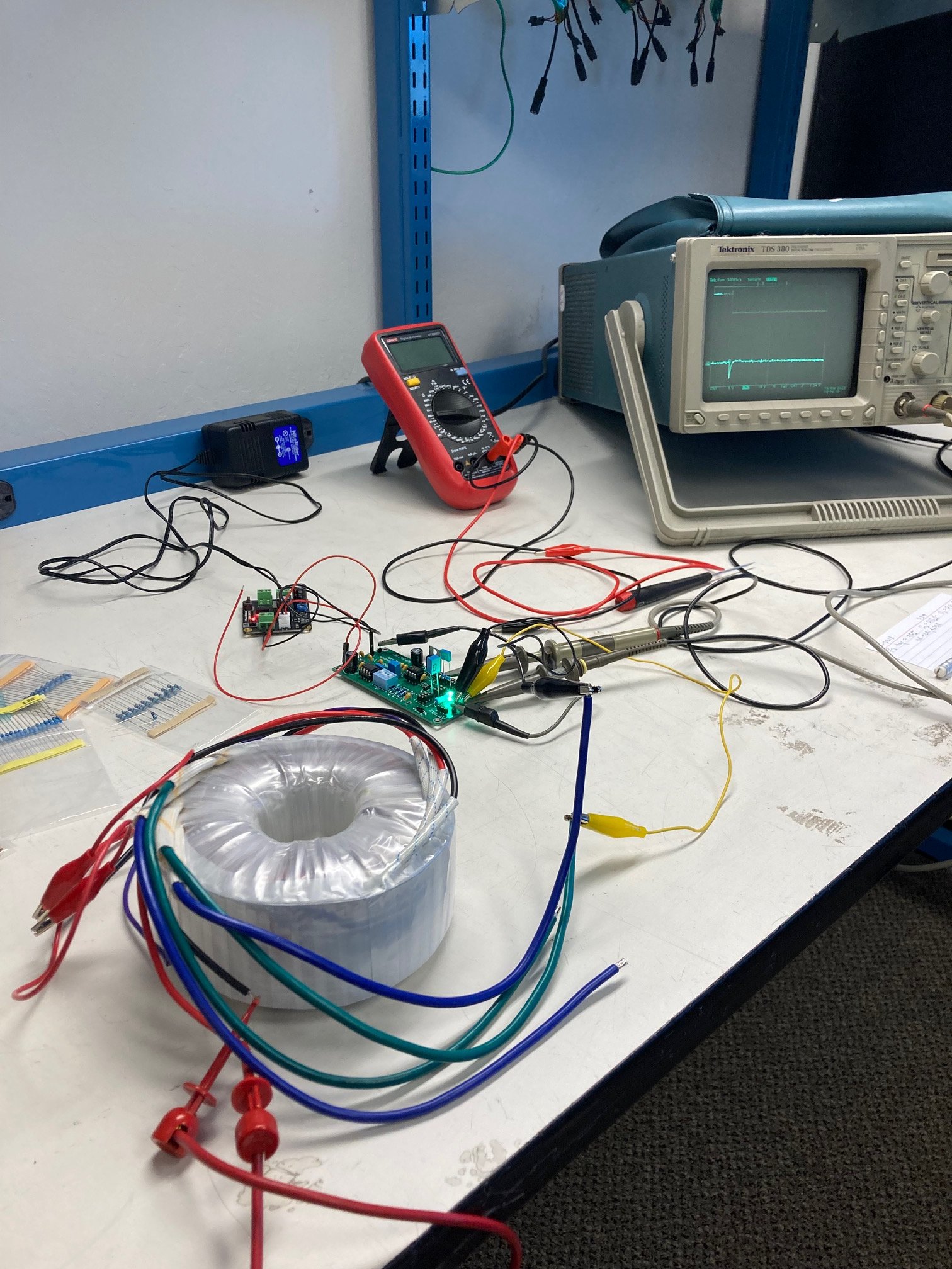

Toroid Corp of Maryland custom order. Asked for 300VA, 18V secondaries and quiet as possible. Per ZM fashion was build on oversized 410VA core, ES shield, Mu metal band, resin potted.
Results for all 4 transformers showed Rs of 9-11R as measure on pot.
Cs = 0.15uF
Cx = 0.01uF
Rs = 10R
