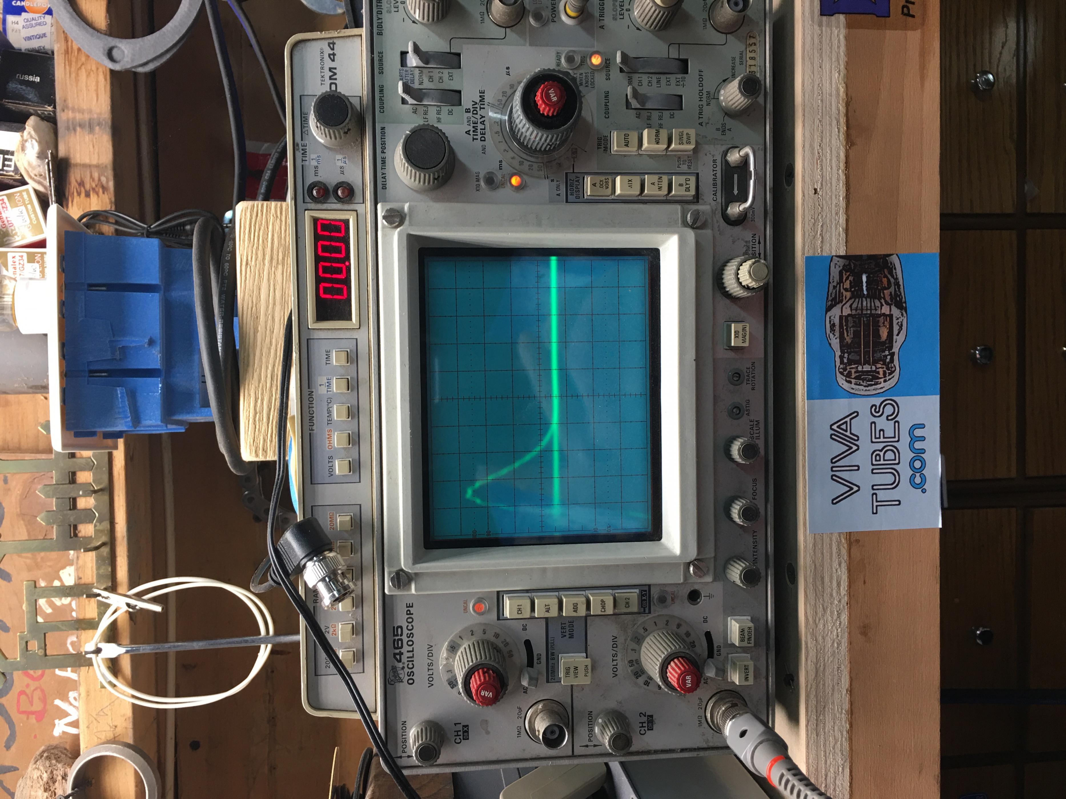

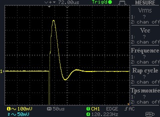

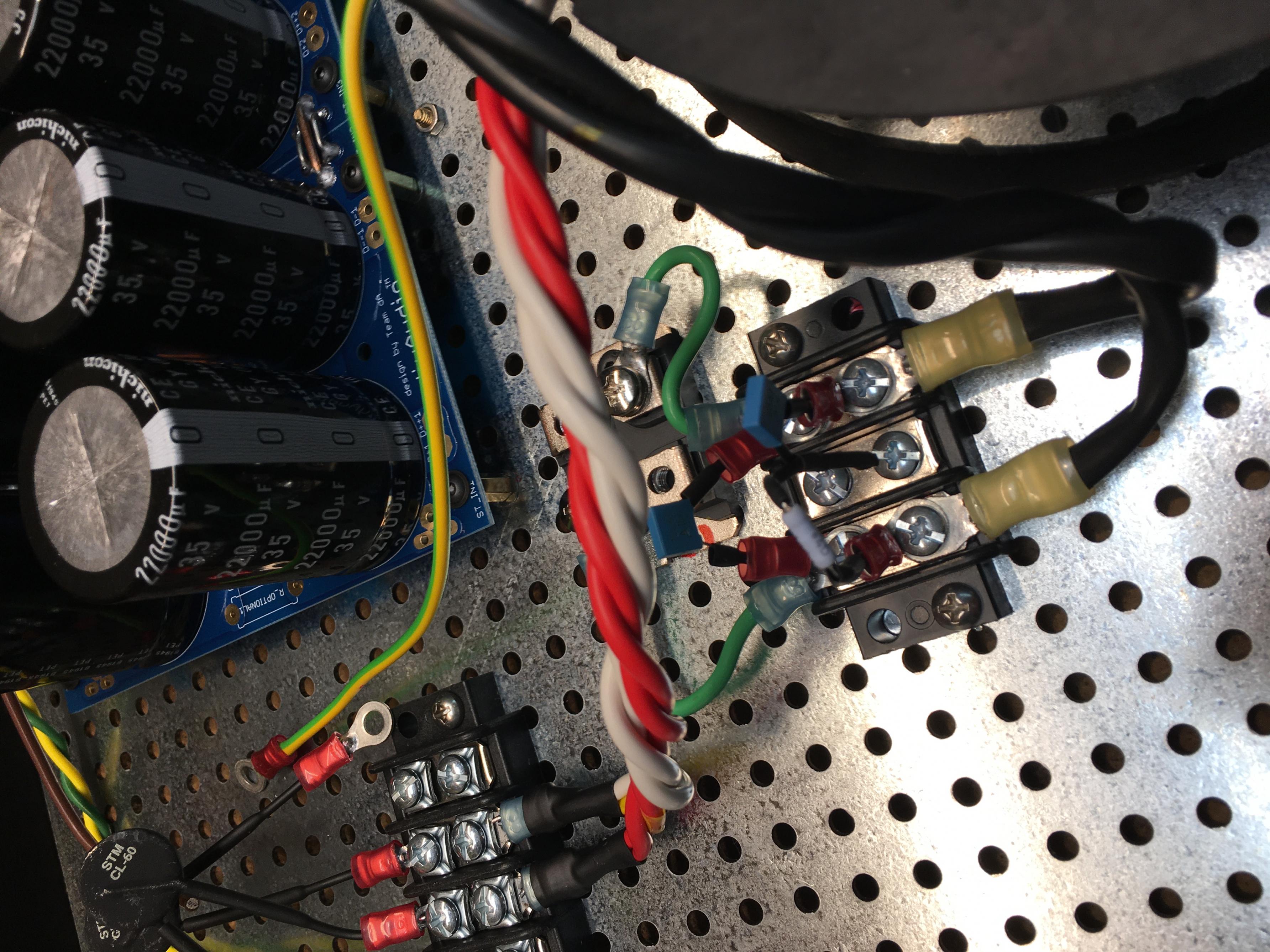

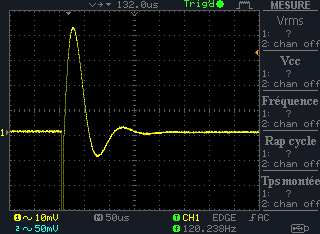

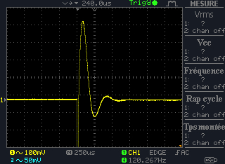

Quasimodo results (ONLY)
After re-doing RS-12.7 ohm..Qmodo U2 failed had to put in a new one.
Antek AS-0515
50va dual 15v secondaries
Cx = 0.01uf
Cs = 0.15uf
Rs = 50 ohms and 51 ohms on the other secondary
Antek AS-0532
50va dual 32v secondaries
Cx = 0.01uf
Cs = 0.15uf
Rs = 84.4 ohms and 88 ohms
Both tested with 110v primaries shorted

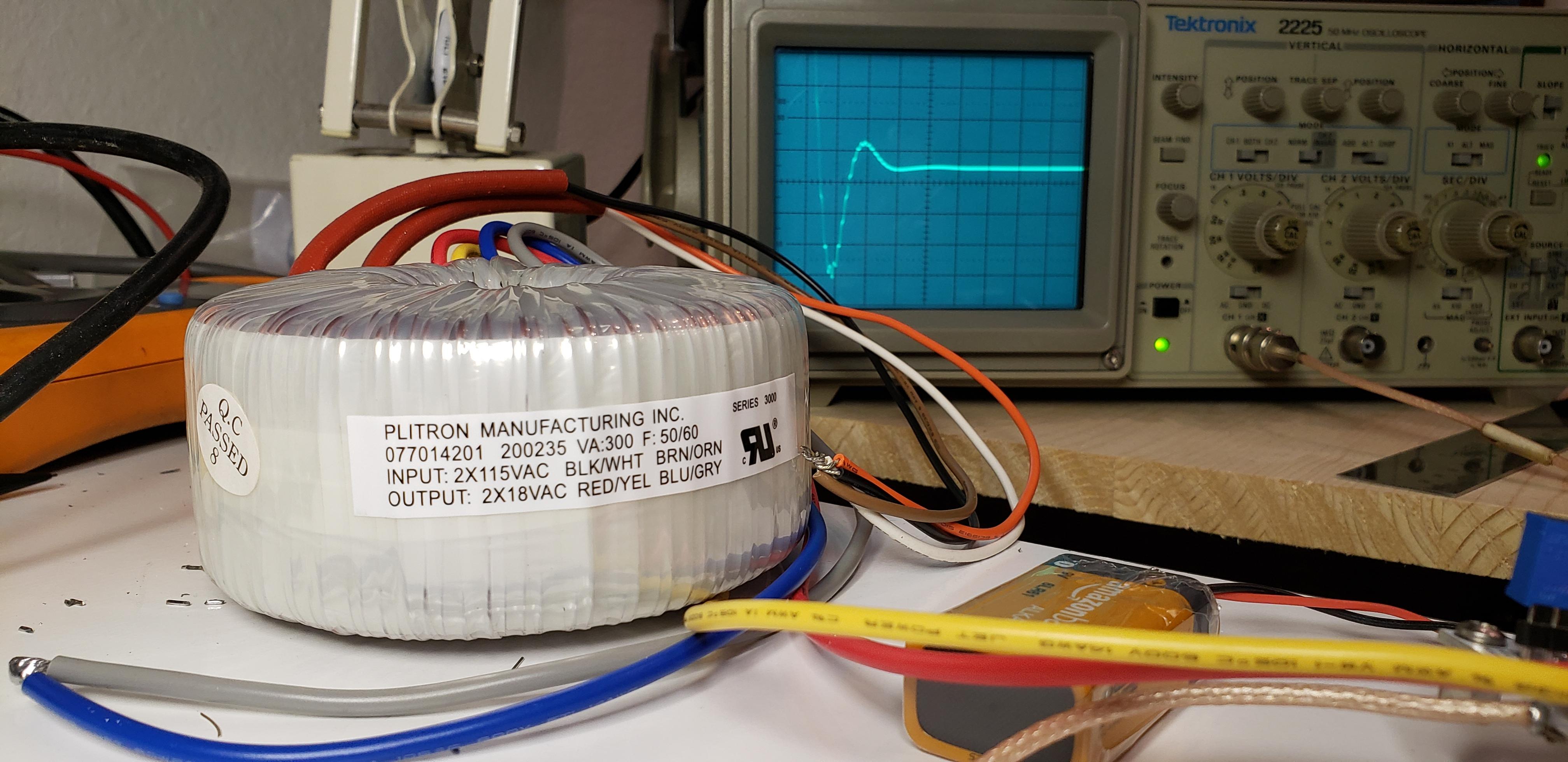

Good info here...does anyone have a suggested for values on a Hammond 1182u24, building my first diy PSU v3 and F5 turbo mono blocks...any insight is appreciated. Looking for Cx, Cs and Rs, noting I am running 120vac on the line side, 24v secondaries on the transformer.
