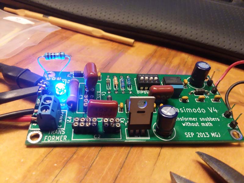

Just got the PCB today See post Quasimodo 4
Vigortronix VTX-146-050-218 50VA 115/230 18+18
Primaries in series (230V)
Cx 10nF
Cs 150nF
Rs 26Ω / 26Ω

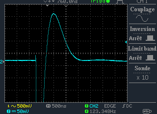

After all this time, finally remembered to post my results over here.
Using Hammond 229D40 transformers acquired from Mouser
"My" chosen snubber values are:
0.15uF, 0.01uF and 424ohms (I have a BUNCH of 196 ohm and 226 ohm resistors so easily made my "424"ohm resistor, but that much accuracy is not needed 🙂 )
mlloyd1
Talema 70053K 15VA 2x15V
Cx 10nF
Cs 150nF
Rs 30Ω

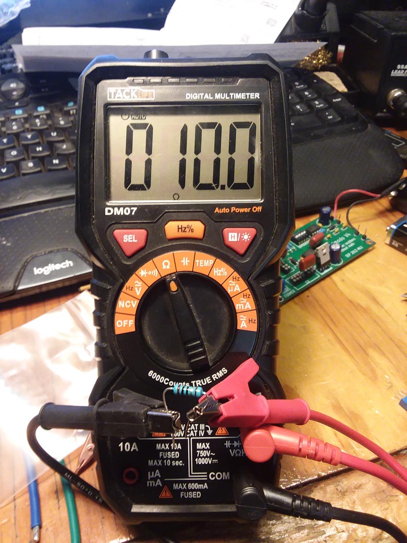

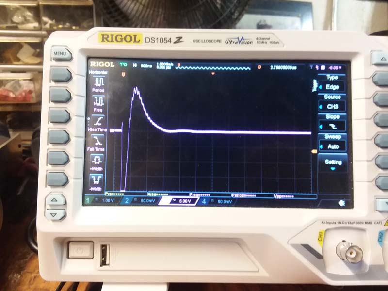

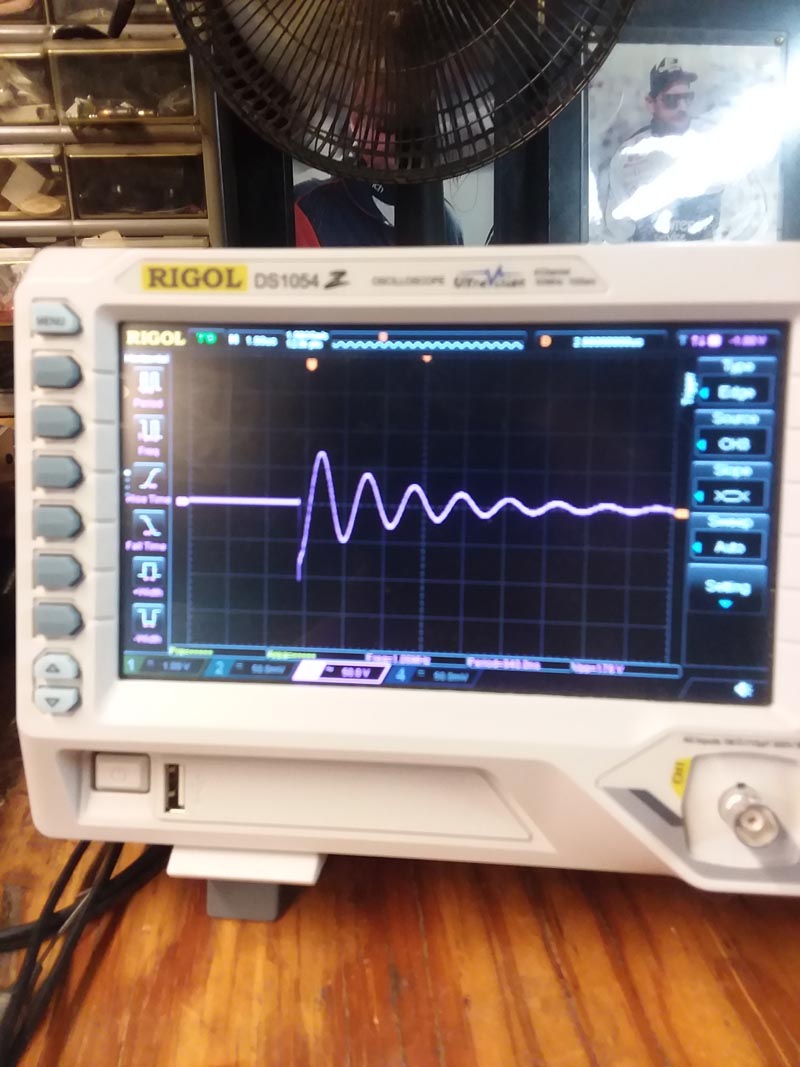

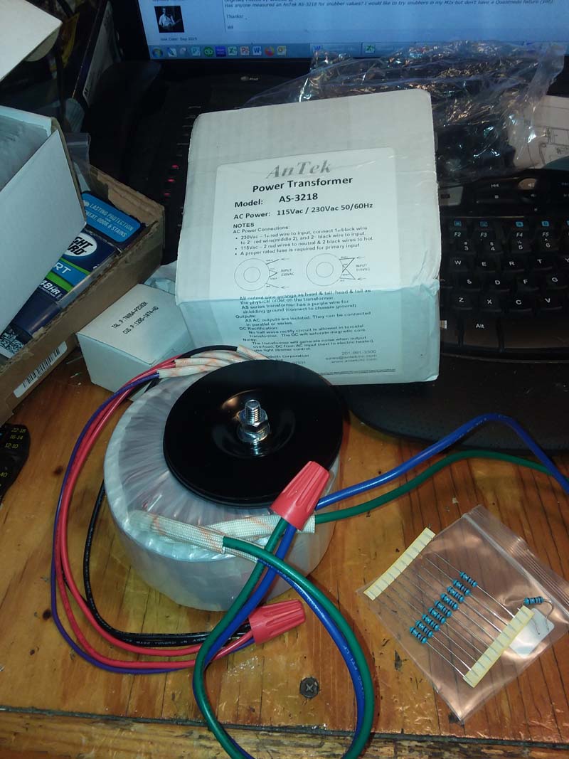

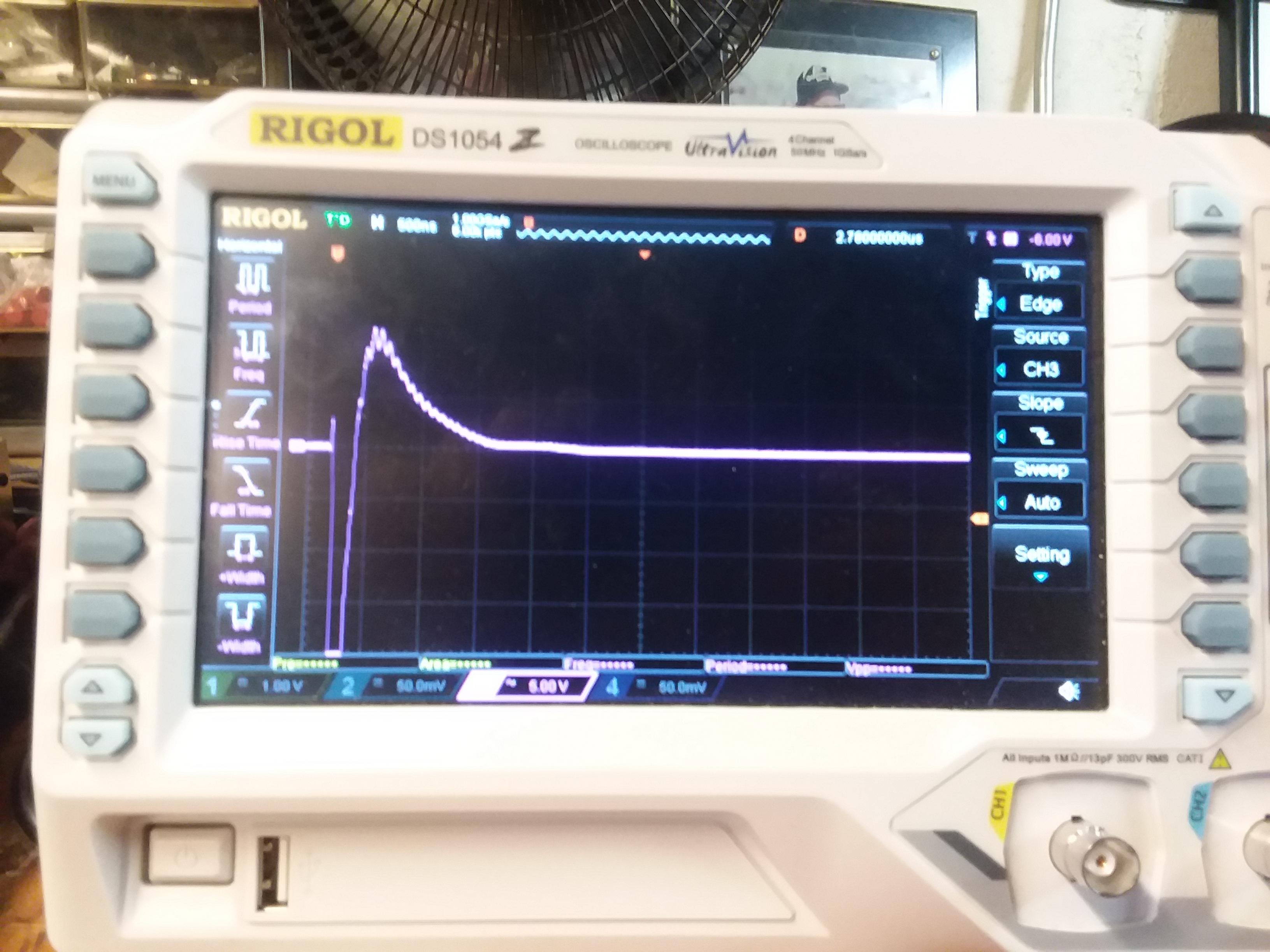

AnTek AS-3218
AnTek AS-3218 115v-18v
.01uF
.15uF
Primary shorted
1st secondary other shorted
10-12ohms
2nd secondary other shorted
10-12ohm
Both look pretty good, but I wrote 10R on the box for when I use it.
