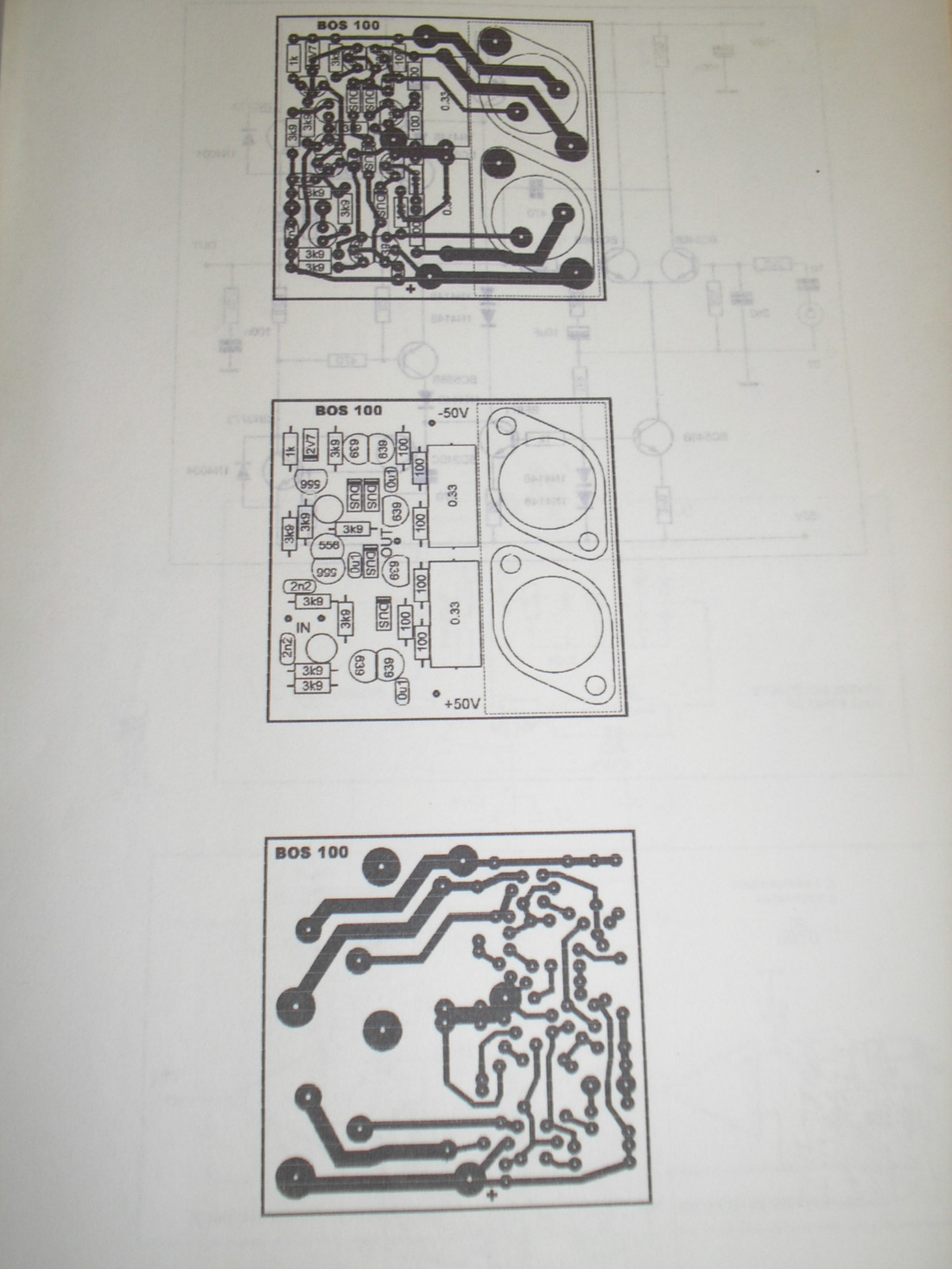

Do you have schematic for that? I can't figure out the diodes and some of the transistors! Please do help kind Sir!

I find paper with circuit of this amplifier with single pair 2N3773 and added VI limiter.

No, I lost schematic for BOS100, but you can use pcb design as start point for simillar amps.
Amplifier from post #1 is fully worked design.

I am a bit skeptical about the schematics that you had pointed to me (post #1), because the schematic itself doesn’t coexisted with the PCB design that you had posted. Components are different and events the circuit board design are mismatched. Please help kind Sir! If you happened to have power amp with 2N3055/2N2955 please send over.

Circuit is simple as possible, but if you still confused, you can go to 100W Ultimate Fidelity Amp and use 2N3055/2N2955 with +/-30V DC rail voltage. I can explane to you anything about QUASI amp. This amp can be used for many powers and many diff part can be use for this amp, and it's for beginers to get expirience in buiding and have funtional amp at the end. Any sound from this amp will be better than no sound from not funktional amp.

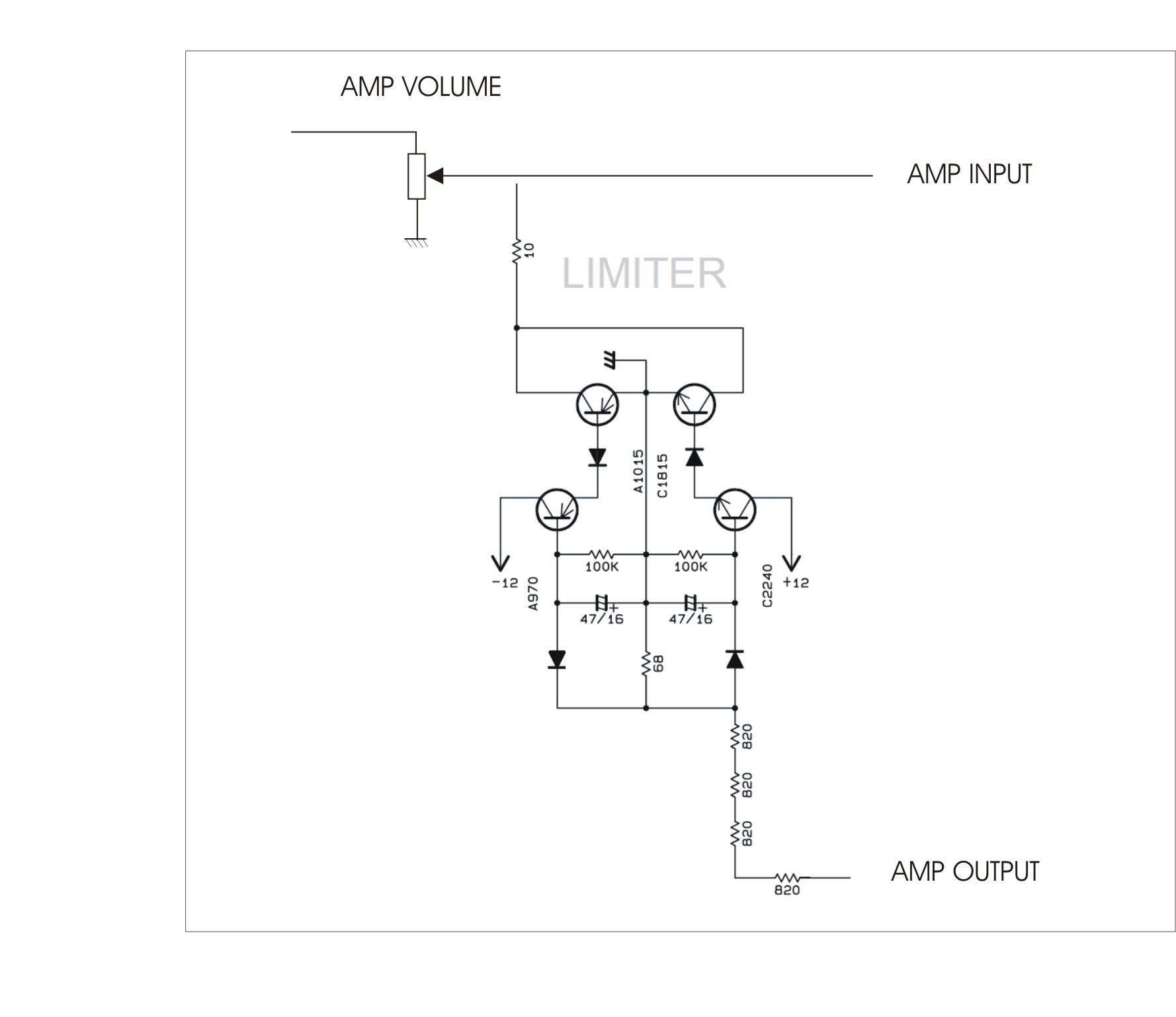

Simple limiter if you use amp for PA or as powered subwoower amp.
apex sir,
how does this limiter works???...how do i know that the limiter limiting????...how do i modify the circuit if use to another amp???...
