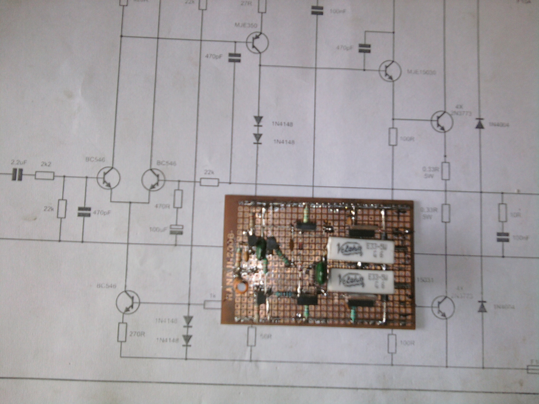

apex sir,
how does this limiter works???...how do i know that the limiter limiting????...how do i modify the circuit if use to another amp???...
tnx...
ees...
Limiter activate amp output voltage at clip level (or low if you want limit amp under full power) and it atenuate amp input. Clip level voltage is about 5-15V under rail voltage ( rail voltage +/-75V DC, clip level about 65V).
You can adjust limit level with different value of resistors 820R to get 2V in point 820R, 68R whan amp out is on clip level voltage.
Use formula: Rx=Uclip/0,03 or Uclip=0,03XRx
Rx is 3280R (4x820R) in schematic, Uclip is 100V this clip level is for APEX H900 you must use low value for Rx depend of rail voltage or if you want limit amp at low than full power power use formula P=(UrmsXUrms)/Rload, Urms=Uclip/1,4
Regards

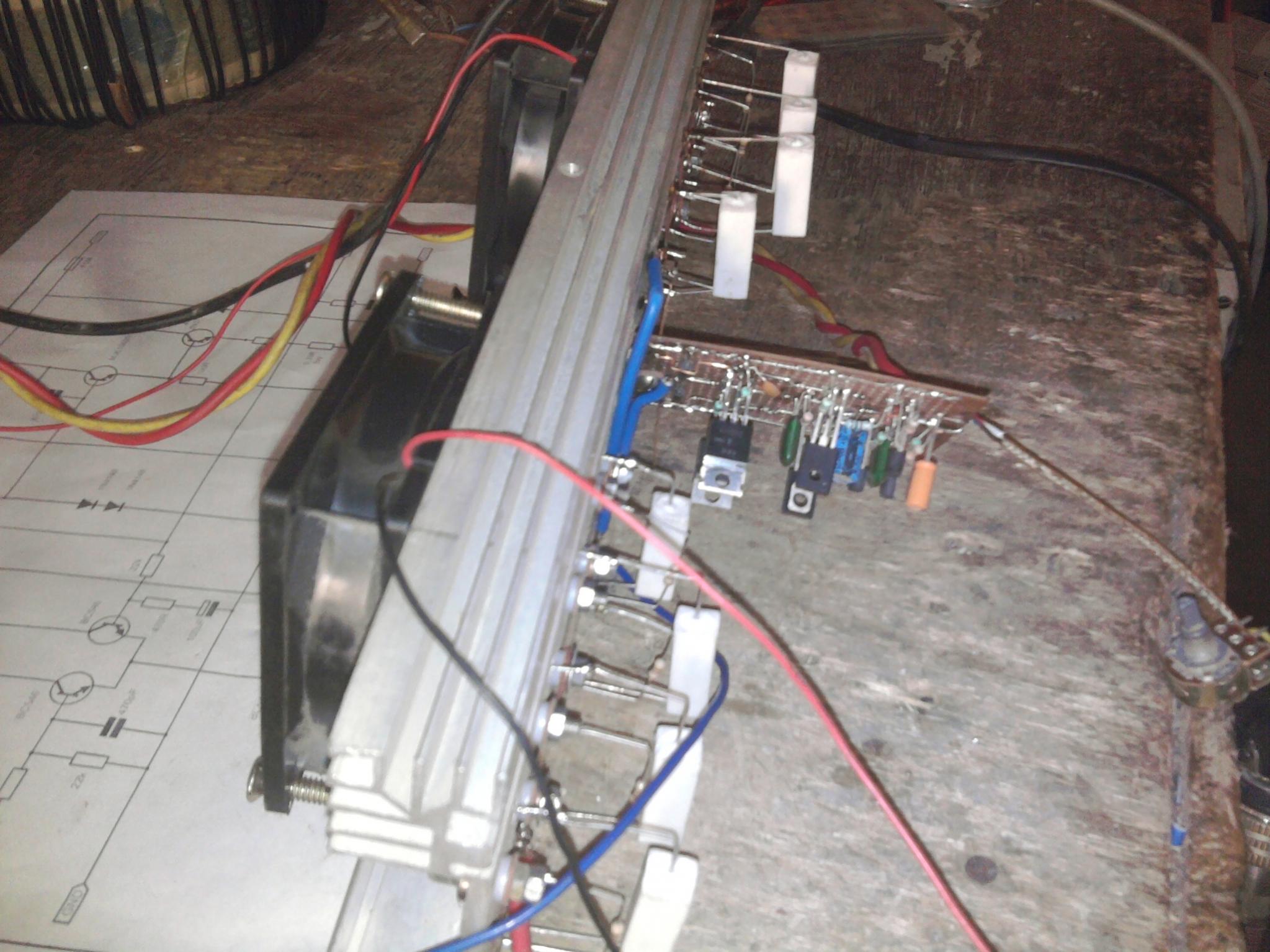

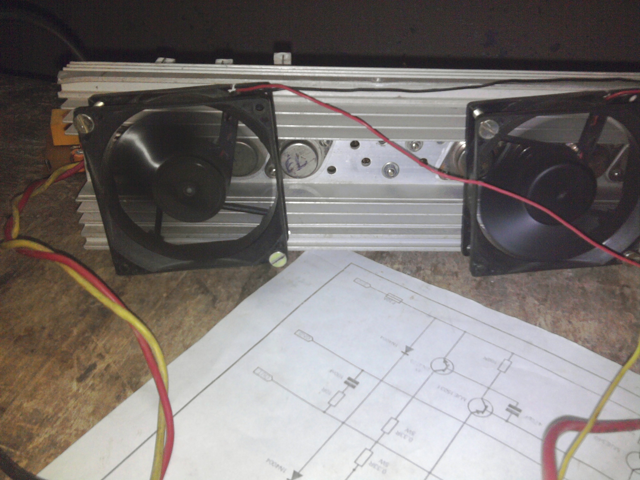

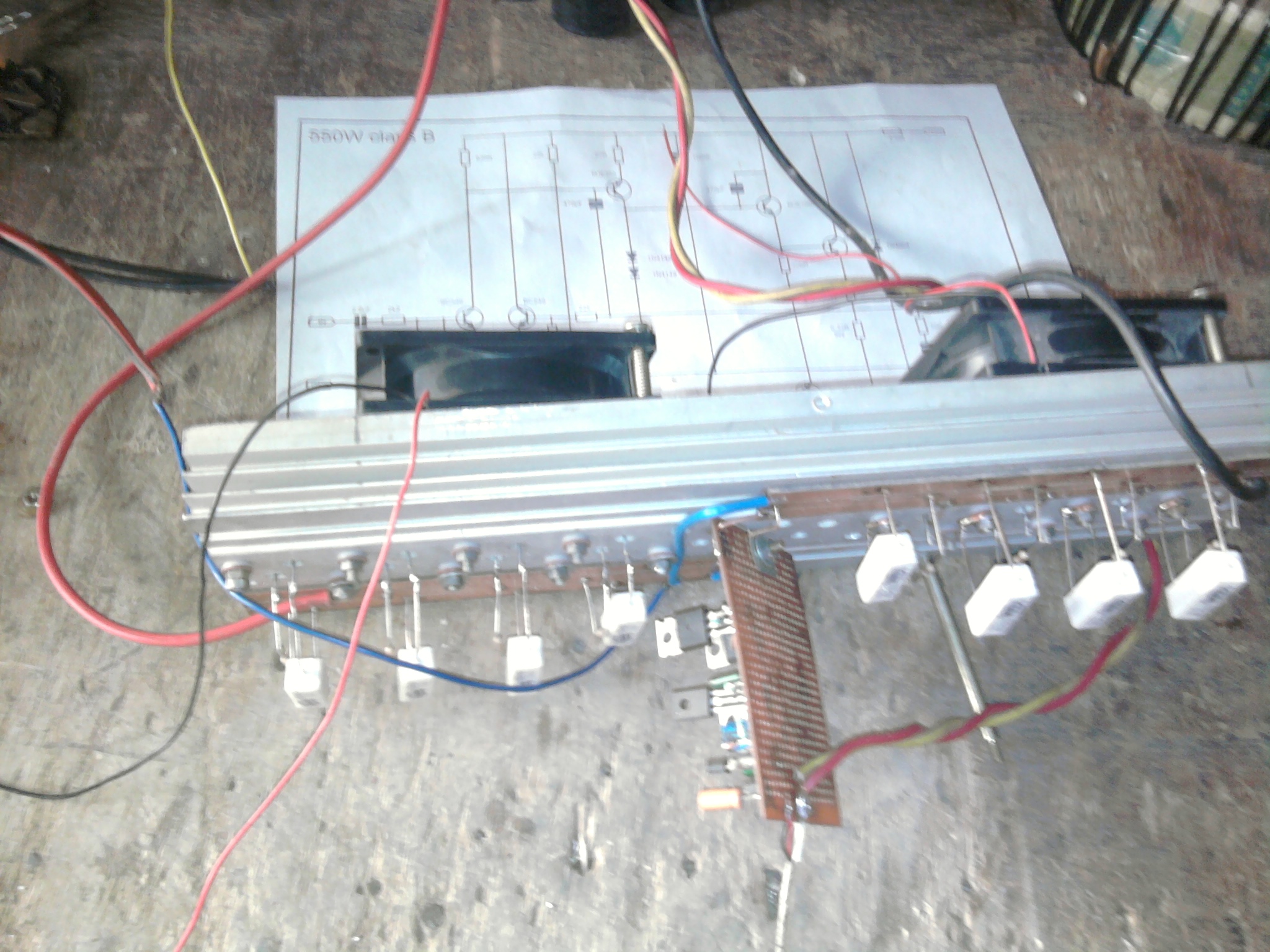

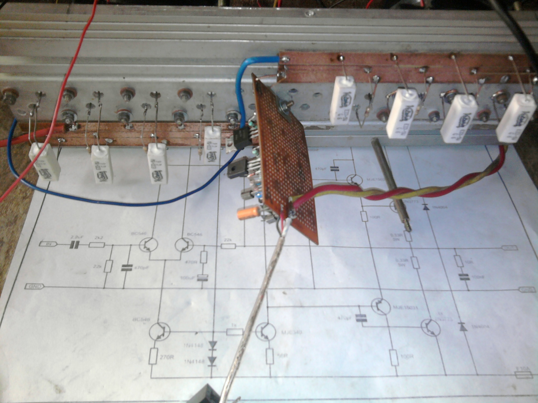

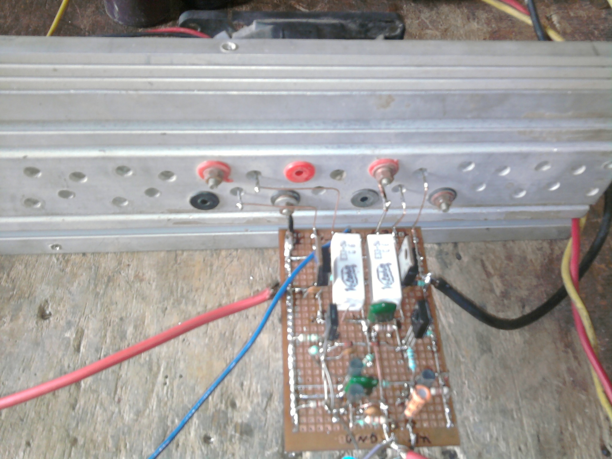

hi
hello sir
this is my project....
