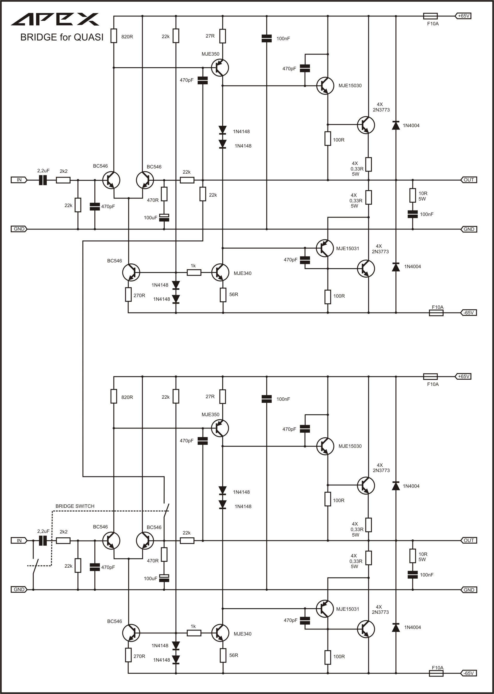

bridging
apex sir...,
i'd like to ask something...
how do i bridge amps like this without using an inverter or birdge buffer???...
tnx and regards...

Yes, use this schematic for simple bridge.

thank you sir...
i see...a 22k resistor connects the two amps...
ahmmm...what is the idea behind???...
so i can implement it in any other amps that i may encounter...
please help...
tnx and regards...

22k at the input is to match the 22k in the NFB.
is it necessary to match the input and the feedback resistors???...why???...
so if i have 33k feedback i'd also use the same value at hte input to bridge the amp...
thanks...
ees
input bias currents
yes, it is very important.
Any schematic that shows different values should explain why it can be considered as a very rare exception.

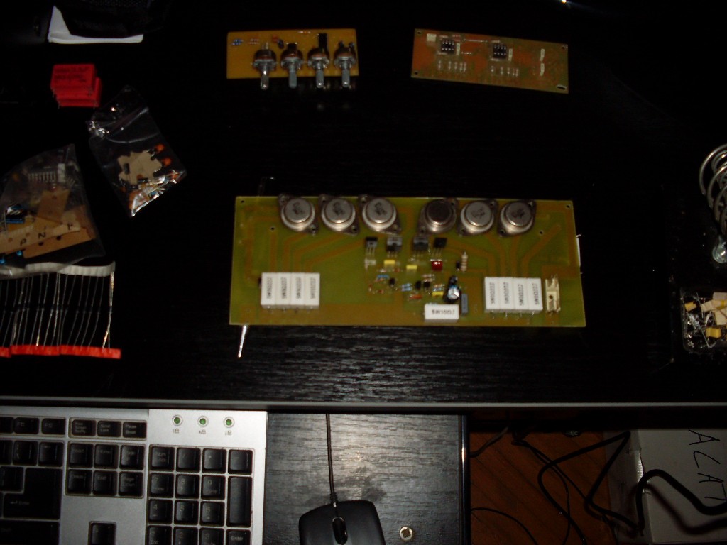

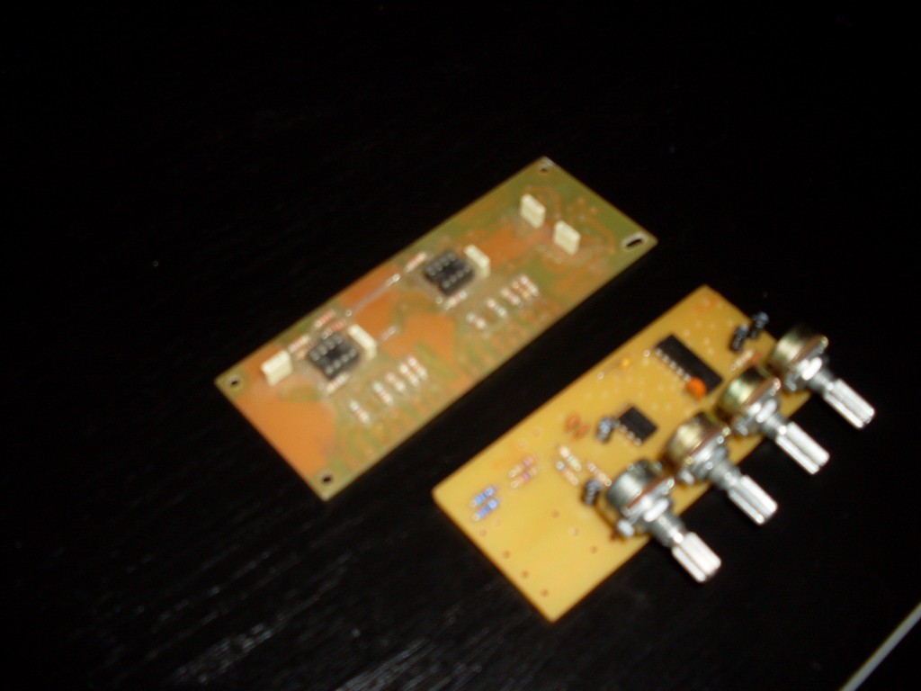

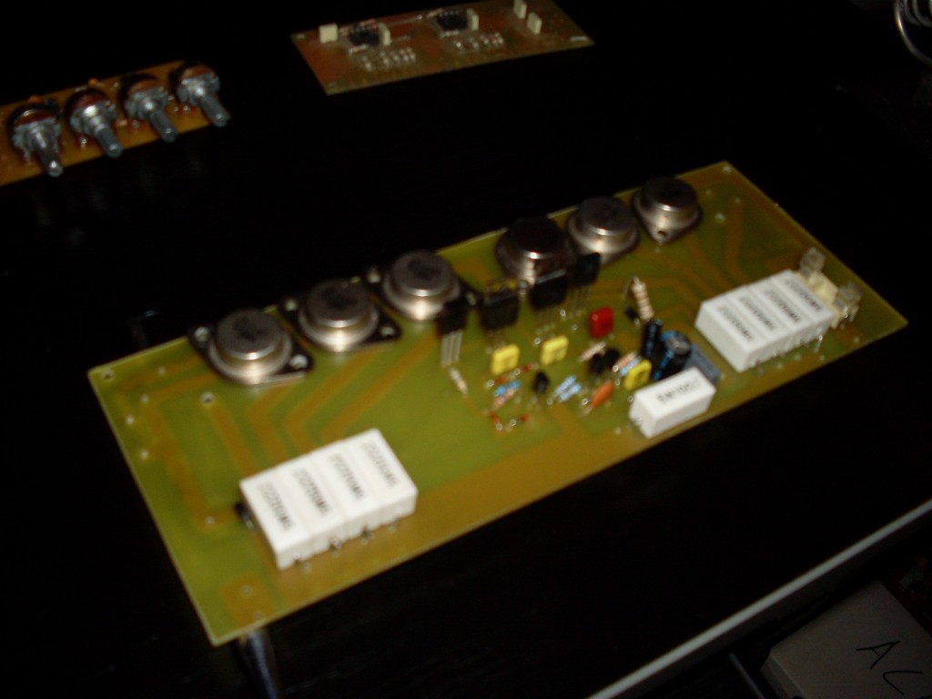

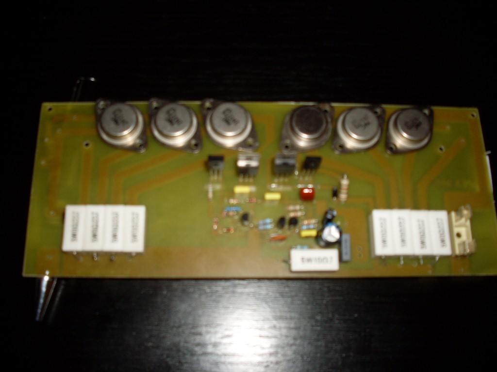

Nice PCB with TO3 outputs on it, but can be smaler or you can add protect circuit.

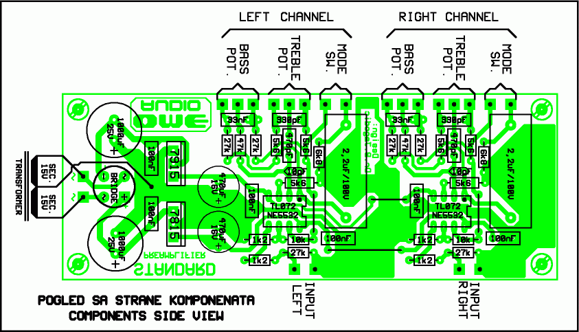

What is 'standard preamp'?
Regards
Regards

hello sir nice work.....

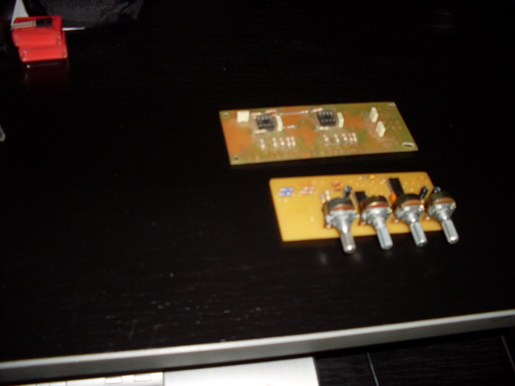

And Apex ML3 tone control with STANDARD preamp...

Standard preamplifier is the name of Borivoje Jagodic stereo preamp.
This is schematic and PCB of it.
Regards
