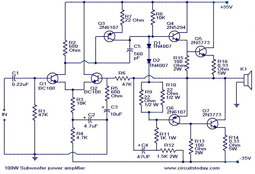

i found a circuit in the web but it did not worked to me output transistors are getting very hot even at medium sound (see attachment) hope yours will run cool
please attach a fresh schematic with bias adjusting with modifications as per my requirement
sorry for my bad English

You can use this amp for keyboard and guitar, and it will work with 35-0-35 transformer with two 2N3773 on 8ohms load. Amplifier run cool at medium sound. There is no fresh schematic.
Regards

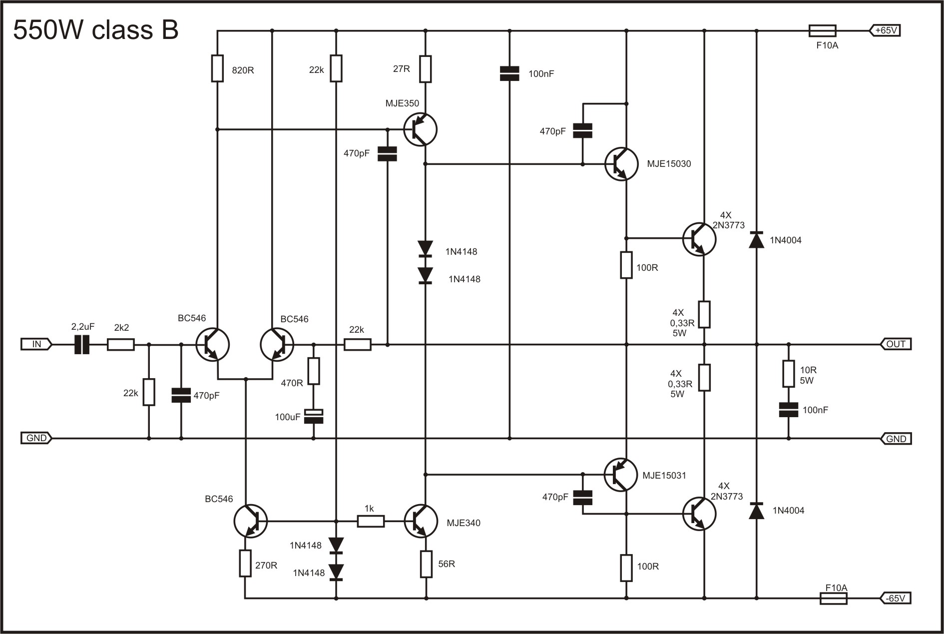

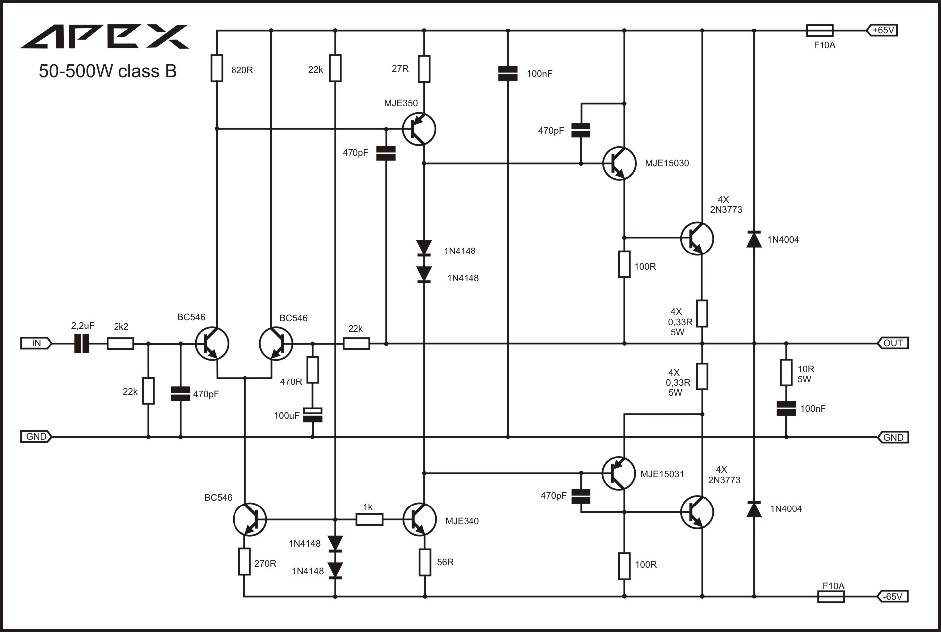

i am confusing between these two schematics which one is correct?
what is Iq of this amp?
what is offset at output?
what is the wattage of the remaining resistors?
Both schematics are correct, only difference is connection of PNP driver emiter, on second schematics connection is same as PCB circuit.
Iq is 20mA, and this is VAS Iq, output stage work in class B
Offset at the output is +/-10mV (+/-20mVmax) without matching diff pair.
Resistors wattage is 0,25W if no other notification.
Regards
