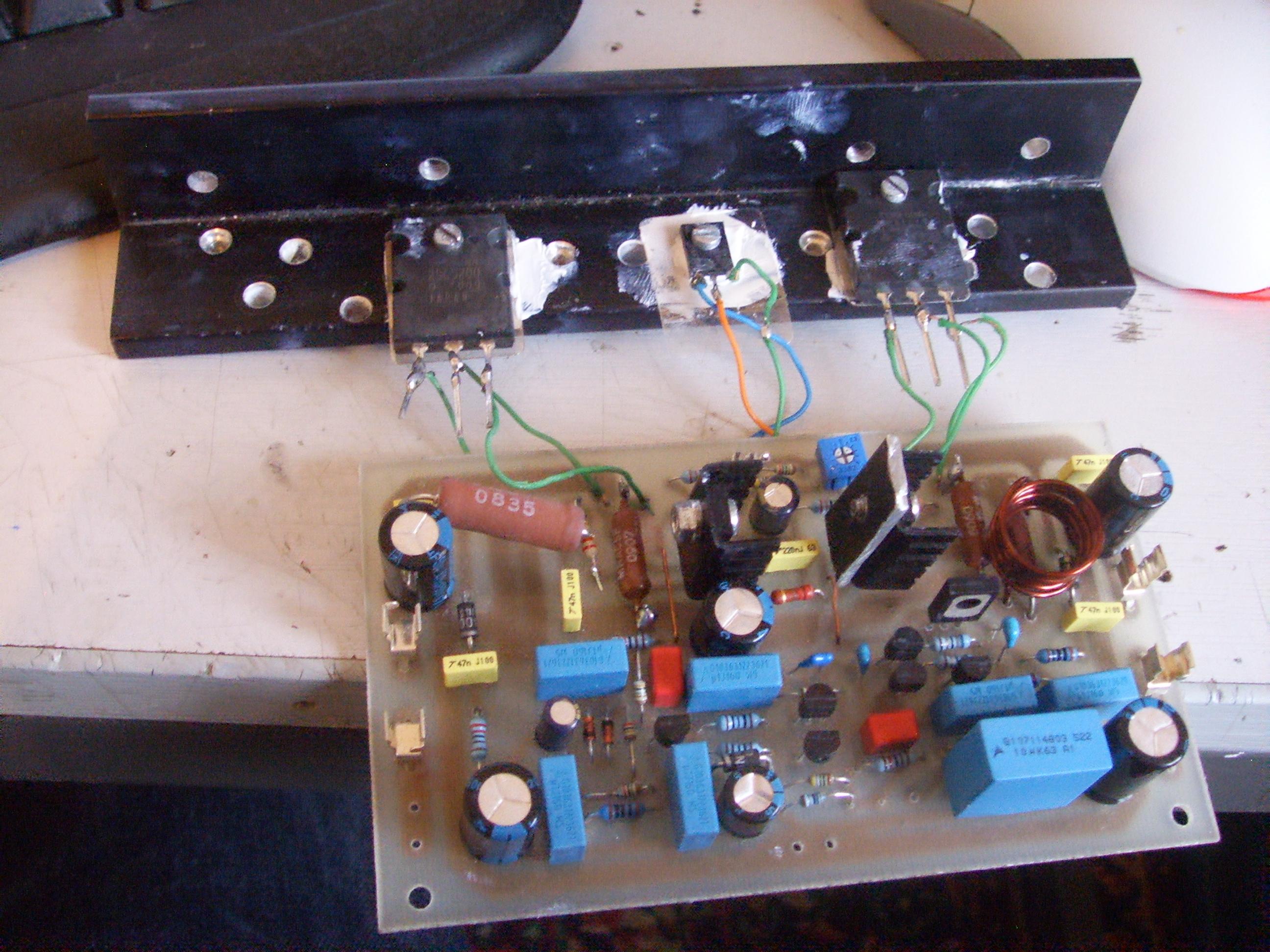

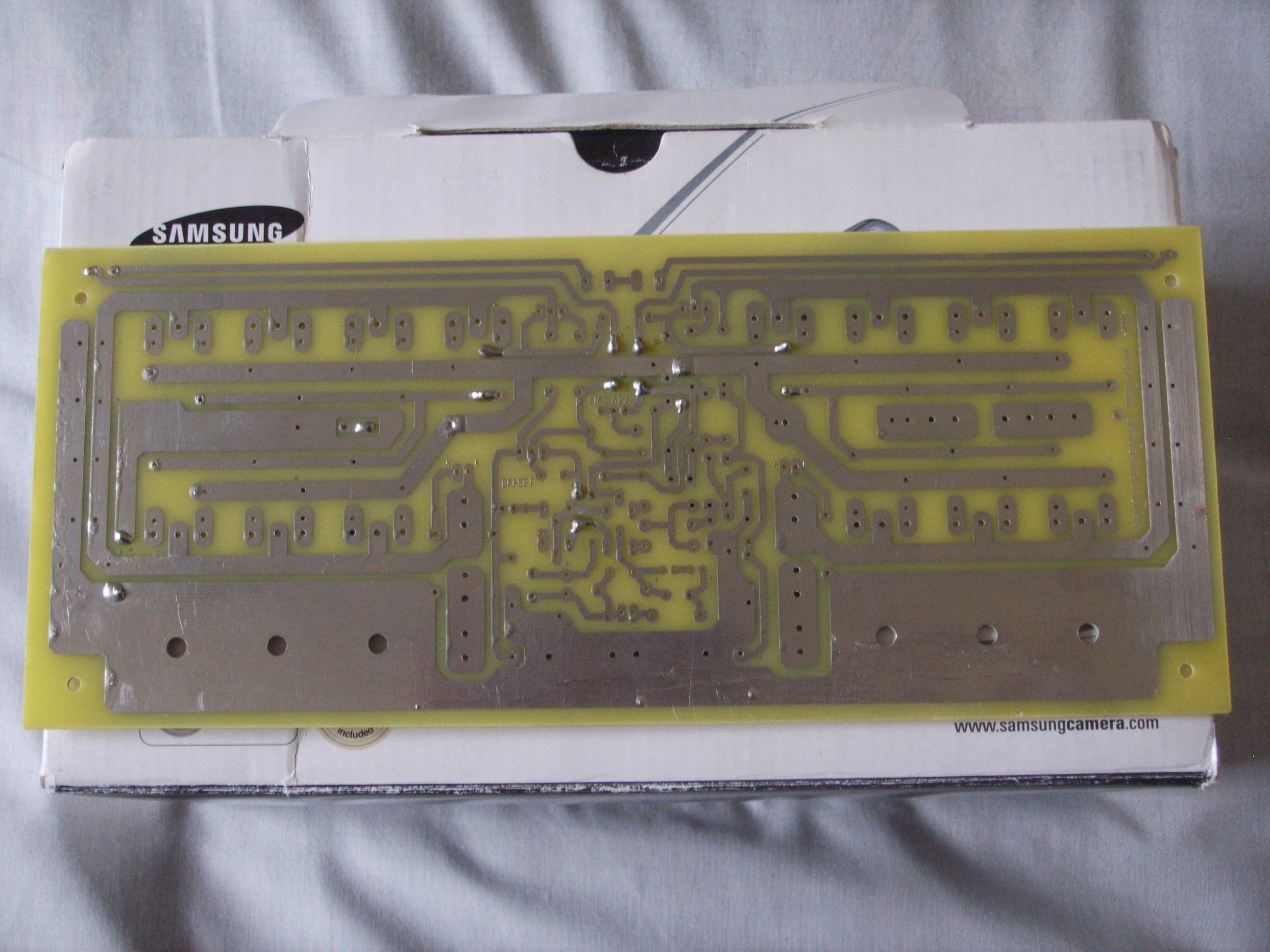

here you go
If you can have PSU without voltage drop with full output power, you can get 120Vpp or 42vRMS output voltage with +/-65V DC rail voltage. That will be 225W/8R or 450W/4R with 1% THD, or 300W/4R with 0,1% THD like CROWN DC300 with 1,5kW transformer. Power is not important, this amplifier give great chance for begginers to made functional amplifier.
