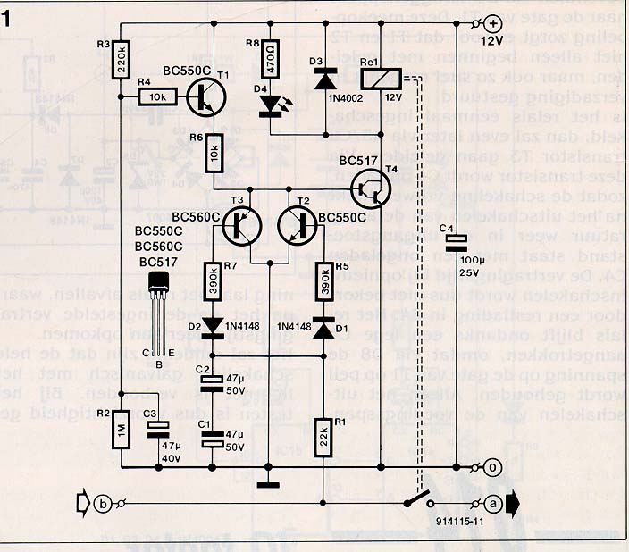

Apex 550 with protection
PCB with DC protection. 😱
  • Apex550 with protection.pdf
  • Apex550 with protection mirror.pdf
