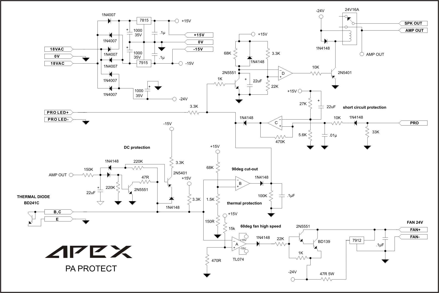

I don't know how to connect termal protection and where on pcb, haven't done it yet.

In that case fan make noise, and will be death for a few months, you can use circuit from my PA protect,I don't know how to connect termal protection and where on pcb, haven't done it yet.

Thermal protect can be separate from circuit and use for fan drive. Fan polarity on schematic was reverted, sory for mistake, on pcb layout polarity is OK.

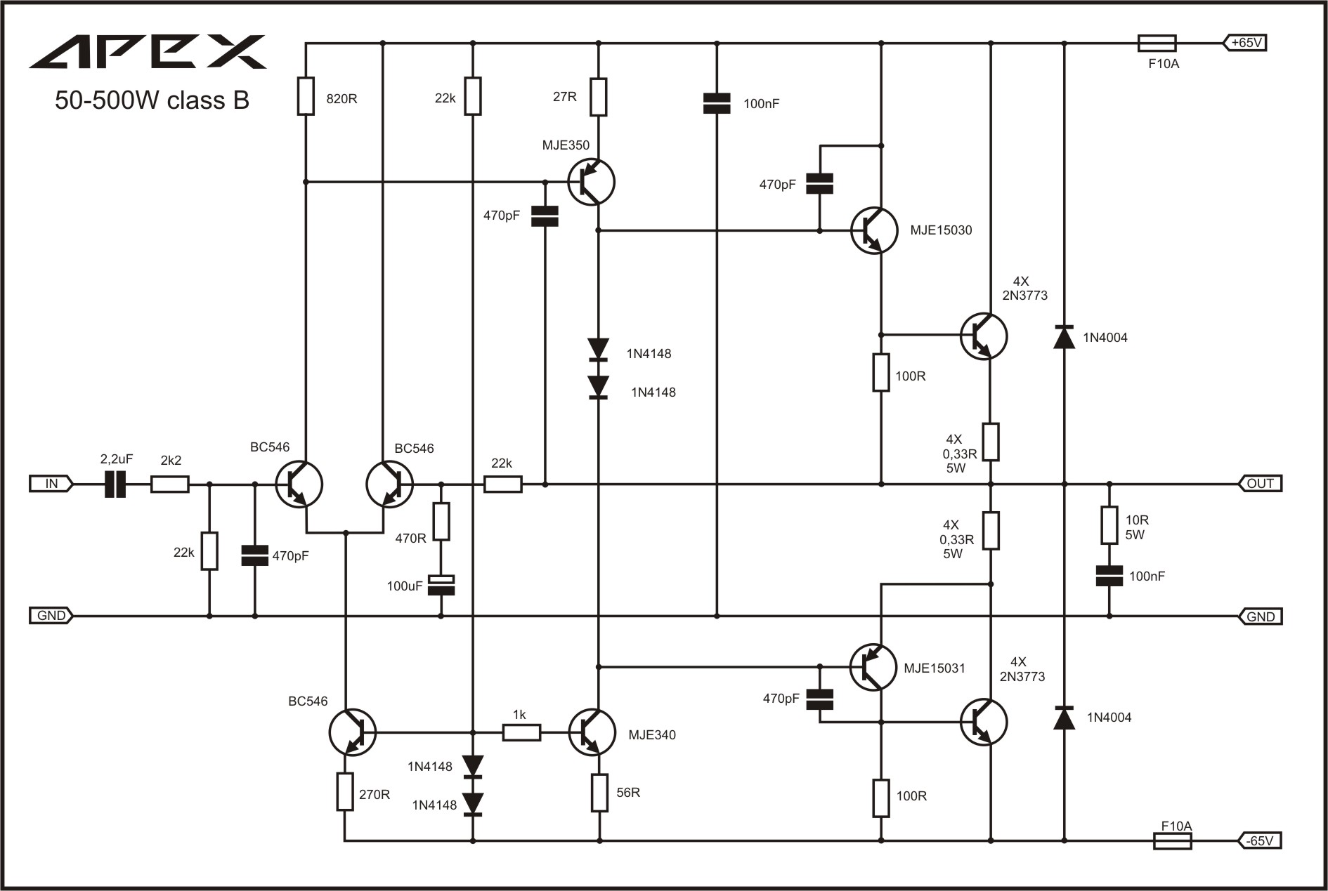

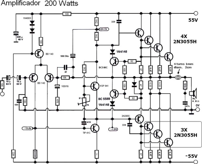

It is not much similar, to high rail voltage even for 2N3055H, and can't work in class B (to much crossover distorsion),Hi Apex
I found this circuit from the net. It seem similar of yours.
I have a question. Can it run in class B and how many output current biasing?
Sorry for my bad english. Thank you.
Regards

There always be begginers, and some people with expirience go back to this simple design 20 years after they build first one. This is clasic circuit as bridge rectifier, and always will be usefull,
Regards
Regards
At my view beginners should not start with an high power audio amp circuit appropriate for supply voltages between 80V until 160V !!!There always be begginers, and some people with expirience go back to this simple design 20 years after they build first one. This is clasic circuit as bridge rectifier, and always will be usefull,
Regards
20-40 volts (+/-10 - +/-20 volts) are enough for starters and first projects. Because this means much lower output power, more amp devices and multi-amping modes resp. active crossover solutions are necessary.
The great advantage by carried out this solution is the possibility to go on in steps (at first small amp, after checking the reliability the clone of more such devices and as last step an active crossover network).
BTW - in the schematic from previous post I would introduce additional resistors in the collector lines of the BC546, so that the voltage from C to E arround 20-25 volts

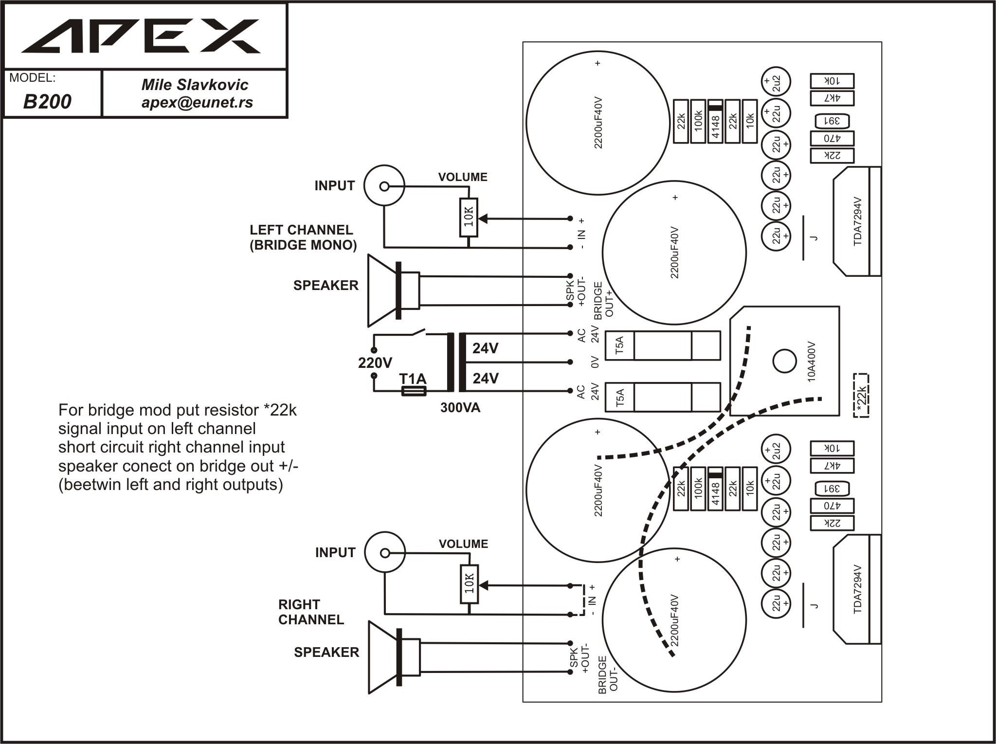

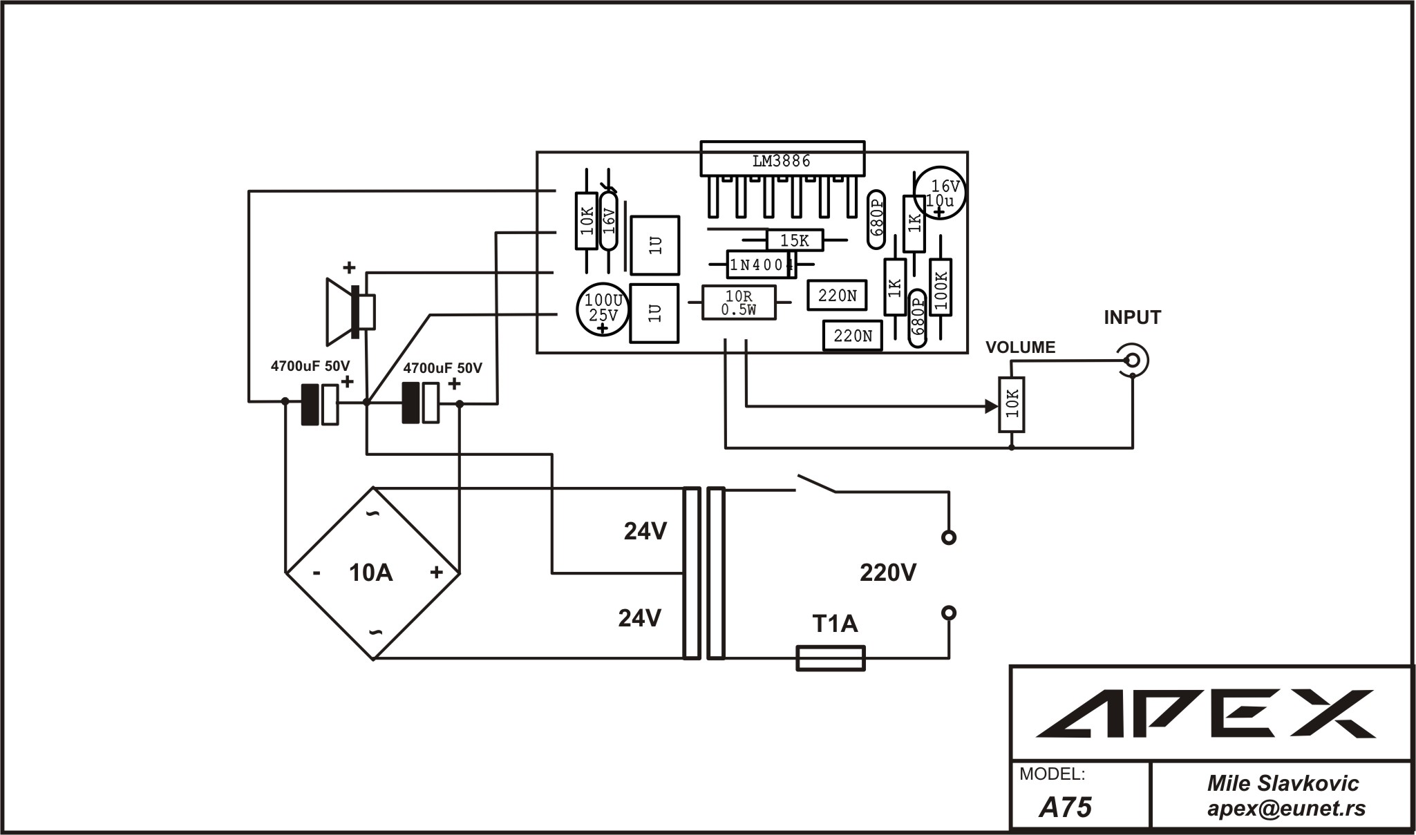

For absolute begginers,
http://www.diyaudio.com/forums/chip-amps/162099-lm3886-schematics-pcb.html
Regards
Regards
Stereo with PSU
http://www.diyaudio.com/forums/chip-amps/162179-tda7294-stereo-bridge-psu.html
Regards
Regards
Power is not that important, this is simple schematic with no adjust. Begginers may have problem with any amp no metter what power it is.At my view beginners should not start with an high power audio amp circuit appropriate for supply voltages between 80V until 160V !!!
About resistors in the collector... This is oldest schematic version, I add cascode, current miror, VI limiter, bias adjust... but that is new amplifier,
