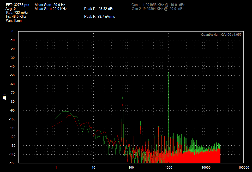

Here's a shot of the graphing window. This was taken with a /10 setting on the QA190.
If you look at the left hand end you will see a strong signal probably 60 Hz. It will be easier to see with a log display. That is what is limiting the THD+N number. the THS at .013 is not bad at all. There just is a lot of hum. It may be from currents between the computer chassis and the amp chassis. Sometimes a clip lead between them will reduce it a lot.
The noise seems to be induced from the amplifier power cord. I suppose this would be improved if using a shielded power cord, or perhaps better shielded BNC's? I am using some BNC cables that are not so great. I've misplaced one of the QA400 cables.
Also, if the test signal is pushed to 0 dbfs, the THD+N goes to 0.27%. I suspect that the input is picking up the noise, as the crappy cable is on the output.
Try the clip lead trick. You are getting a lot of 60 Hz so its probably electrostatic coupling. making sure you have a good common reference even with the differential probe will help. if you have a strong signal it can cause the fundamental to clip and seem distorted even if it isn't. You can look for the hum by muting the test tone and looking at what is coming out with no signal. Another possibility is power supply modulation when the amp is under load.
also -- use the shortest test leads that will do the job.
second -- shielded twisted pair cable isn't expensive and you can make very good test leads on your own.
ditto the clip lead trick
