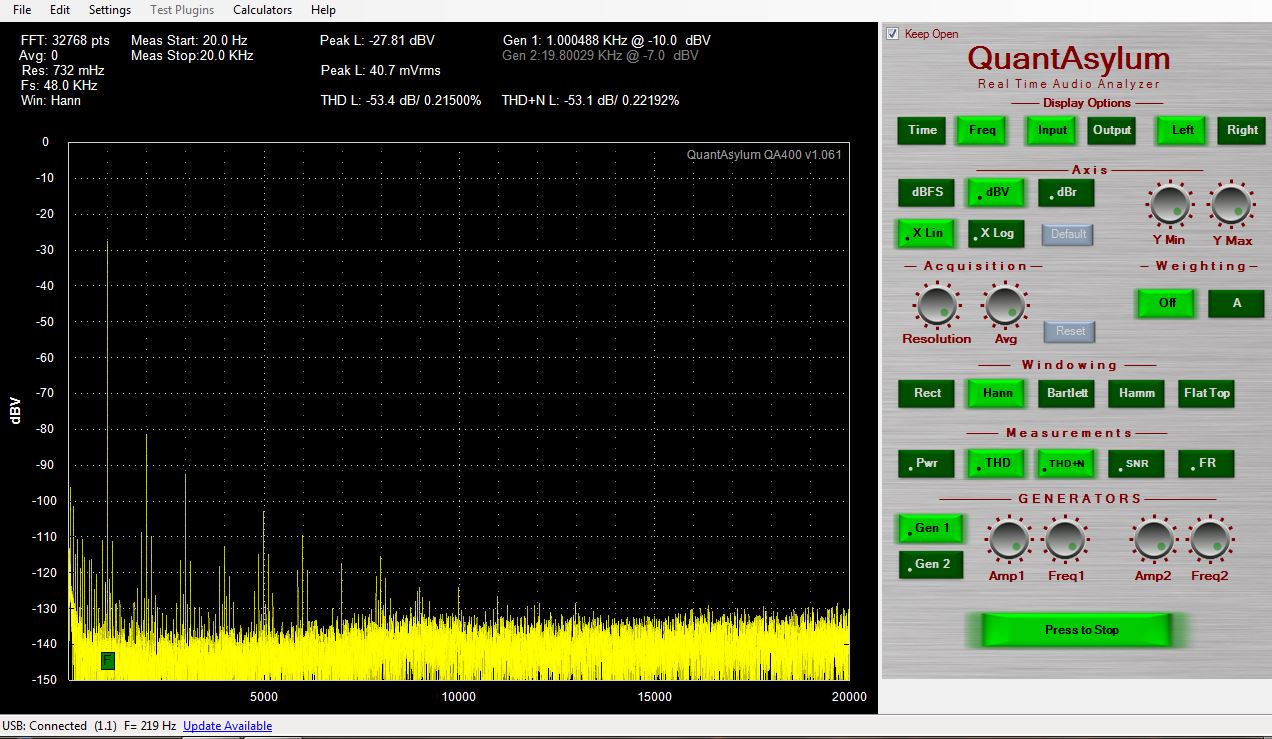

Ok, here are the screen shots of the Dynaco ST-70 tube amp I have been working on. Left and right channel. I have the amp hooked up to 8 ohm dummy loads. Across the dummy load I connected the QA190 probe at X100 and just used the voltage input and measured 1 channel at a time. I am not sure if I need to change setting within the QA400 for this or not and if this connection is correct. I am essentially just trying to measure distortion in old tube gear I repair and learn some new tricks along the way. Any direction greatly appreciated. This is all fun and games for me. Robert

Did you connect a ground reference from the amp to the chassis? While the QA190 has good common mode its not perfect. I am seeing 60 Hz modulations on the left channel. Otherwise its not unusual.

Thanks for the reply 1Audio! The powder cord is a 2 prong. The black speaker outputs are connected to chassis ground. Am I clipping an alligator clip from the chassis to somewhere else when I do the distortion measurement? If you could explain the 60 hertz modulation you see in the left channel that would be helpful also. Thanks for giving me the opportunity to learn something here. There is not a lot of support or documentation for this product. Robert

Just a clip lead from the PC chassis or the QA400 chassis to the amp chassis or ground. Check with a meter first to make sure there isn't a more serious leakage or hot chassis problem.
If you look att the fundamental and harmonics you will see sidebands on each side. I'm guessing they are 60 Hz from the fundamental. Closer inspection will confirm. If they are still there with the extra ground link I would suspect power supply hum. It usually gets worse under load.

Significant difference between channels -- I'm guessing a bad tube or other circuit problem in the L channel...

Thanks for the responses. That really helps. You cannot hear any hum when you play the amp. I know some people modify the power supply on these and add another choke for more filtering. Robert

Increase the "AVG" to 10... it is at zero now.
set the fundamental level to about -10dB.
Btw, 0.02% seems too low for a typical ST-70 tube amp.
What is the actual output level from the amp in either volts or watts? And
are you using a dummy load on the output of the amp?

I will change the average from 0 to 10. I see the knob for "average". What will that do? Yes, .02 distortion for a tube amp does not seem correct, which is one of the main reasons for posting. I do notice a wire in the left channel going past the rectifier tube and 2 electrolytic caps. I bet if I reroute the wire, some of that 60 hertz hum will clear up in that channel. I still need to figure out how to take a power measurement with the QA400 and QA190. The instructions are seriously lacking, but the price is great. Thanks for keeping this fun! Robert

Do you have a dummy load on the amp?
The increased average will drop the noise out somewhat and give a result that is "better".
Not sure this instrument is going to give you a direct power reading.
Ohm's law is going to tell you the power...
I do notice a wire in the left channel going past the rectifier tube and 2 electrolytic caps. I bet if I reroute the wire, some of that 60 hertz hum will clear up in that channel. Robert
At the rectifier and caps you don't have 60 Hz - it's 120 Hz and up at that point.

Yes, I have dummy loads on the output. I think 200 watt 8ohm that I got from Parts Express. They are huge bricks. I will play around with the settings and see where I land. Thanks for taking the time to reply. Robert
