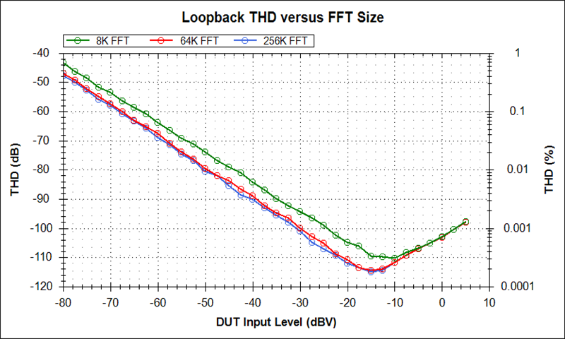

The basic idea is that you make a measurement sweep, generate a graph, make a tweak, make another sweep and then push the output of that sweep to the previously created graph. And then the graph tool let's you interactively pretty everything up (min/max on axis values, trace widths, titles, notes, colors, etc)
The "THD FFT Size" plot below is a look at THD versus FFT size using this technique. Sweep, change FFT size, sweep, change FFT size, etc. At each step, keep pushing the output to the same graph.

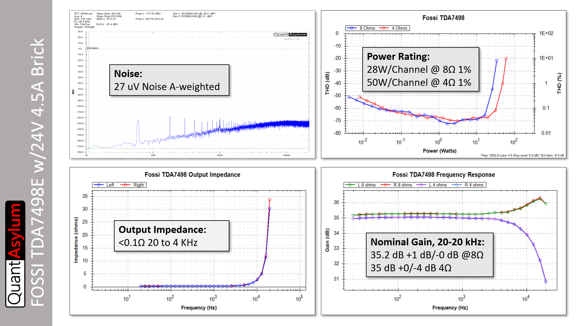

If you need to generate project documentation from your measurements, then the easiest way to do so is to run all the sweeps you want, pretty up the graphs in the QA401 graphing tool, and then copy them all as same-size bitmaps and paste them into PowerPoint. Then arrange as desired, and then group them and re-size them all at once to fit the page. Below is a summary on a Class D amp based on TI's TDA7498 from a company called Fosi. The total time to make the measurements, build the graphs, and group them in PowerPoint and add the text, drop shadows, banner, etc, is around 20 minutes.
Comments on what seems confusing or broken and where to improve are always welcome
