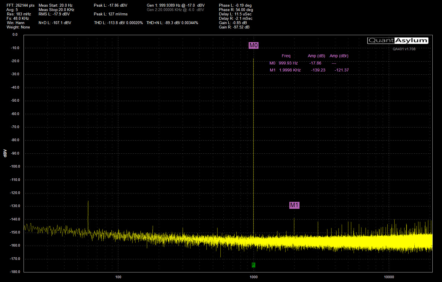

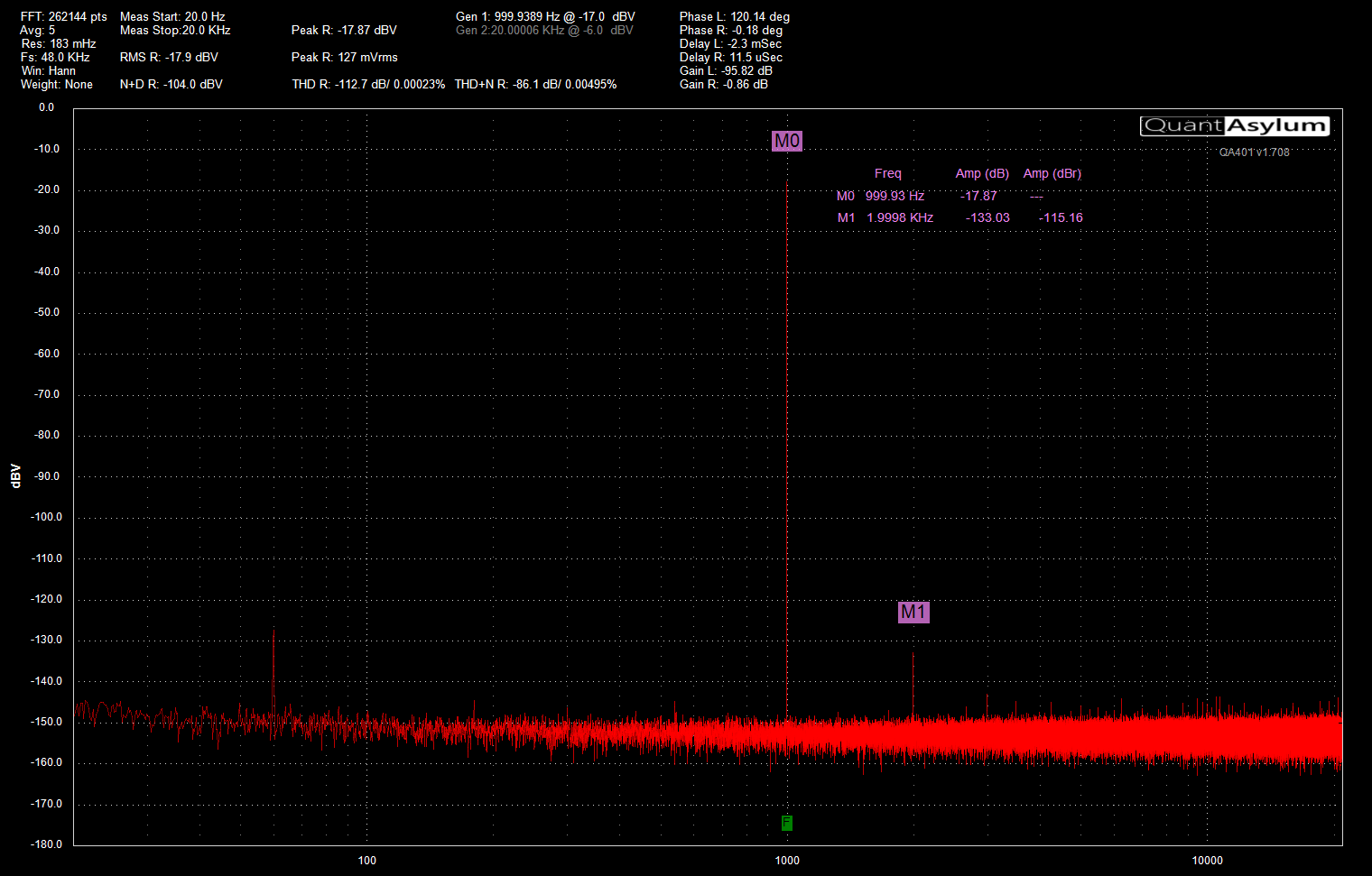

Nice article! Does the distortion rise significantly with the 10k source impedance compared to OPA1612?
I had to measure to be certain about THD, but the answer is "not much" for THD. Degradation is about under a dB for THD. THDN is about 1.7 dB for 2156 and 5 dB for 1612.
In the plots, you can see the output is -17 dBV, and the measured in is -17.86, which is the 10K source forming a divider with the 100K input.
As an aside, on the QA website Demian correctly observed the hash seemed a bit worse with the 2156. That seems true to me too. When using an external 10K at the end of a BNC cable more stuff seems to be picked up by the cmos versus bipolar. But this is sample size of 1, room temp, nominal voltage etc, so I don't know what to make of it at this point.

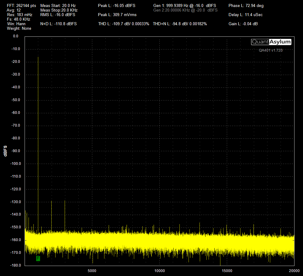

Attached are selftest plots of my QA401. First with a generic USB cable and then with a slightly better USB cable. Normally I would expect dropped frames or other ugly with a bad cable but NOT a major difference in the distortion pattern.
If you get bad results it may be the cable. ijn this case since nothing else was attached I could see no other possible issues and I was first worried that my QA401 had failed somehow. . . but just a funky cable. FWIW the cable shield measures about 500 milliOhms, a decent cable should be closer to 100 milliOhms.

Hi Demien, there's a write-up located here on USB noise. The distortions you see looks like a 250 Hz picket fence. That might be the USB polling rate on your machine?
Some particulars that might help with your exploration...
A QA401 draws about 530 mA while running with the attenuator off, and about 480 mA with the attenuator on. That is slightly higher than the USB spec, and in some modes, it can go a bit higher still depending on how fast you can measure.
On a "fat" USB cable (about 4.8mm diameter), they have probably used 22 awg power lines. On a "skinny" USB cable (about 3.5mm diameter) they are probably using 26 or even 28 awg power lines).
On a fat USB cable, you'll see about 90 mV of drop across the cable. That is, with 5V at the head end of the cable, inside the QA401 at 530 mA of load you'll measure around 4.91V. When the USB voltage measures 4.55V inside the QA401 the first regulator to drop out will be the 5V isolated supply. This means at teh head end of the cable, the USB voltage would be around 4.64V, which is about 100 mV below the USB limit.
So, the summary is that if you are using a USB cable with 22g power conductors you shouldn't be facing problems related to voltage sags, drop outs, etc.
Now, back to the picket fence...it's likely not data errors that are giving the picket fence, it's more likely USB supply voltage noise, potentially made worse by a skinny USB cable or a cable where the power lines have been compromised (eg some strands have broken due to repeated flexing and the resistance has creeped up).

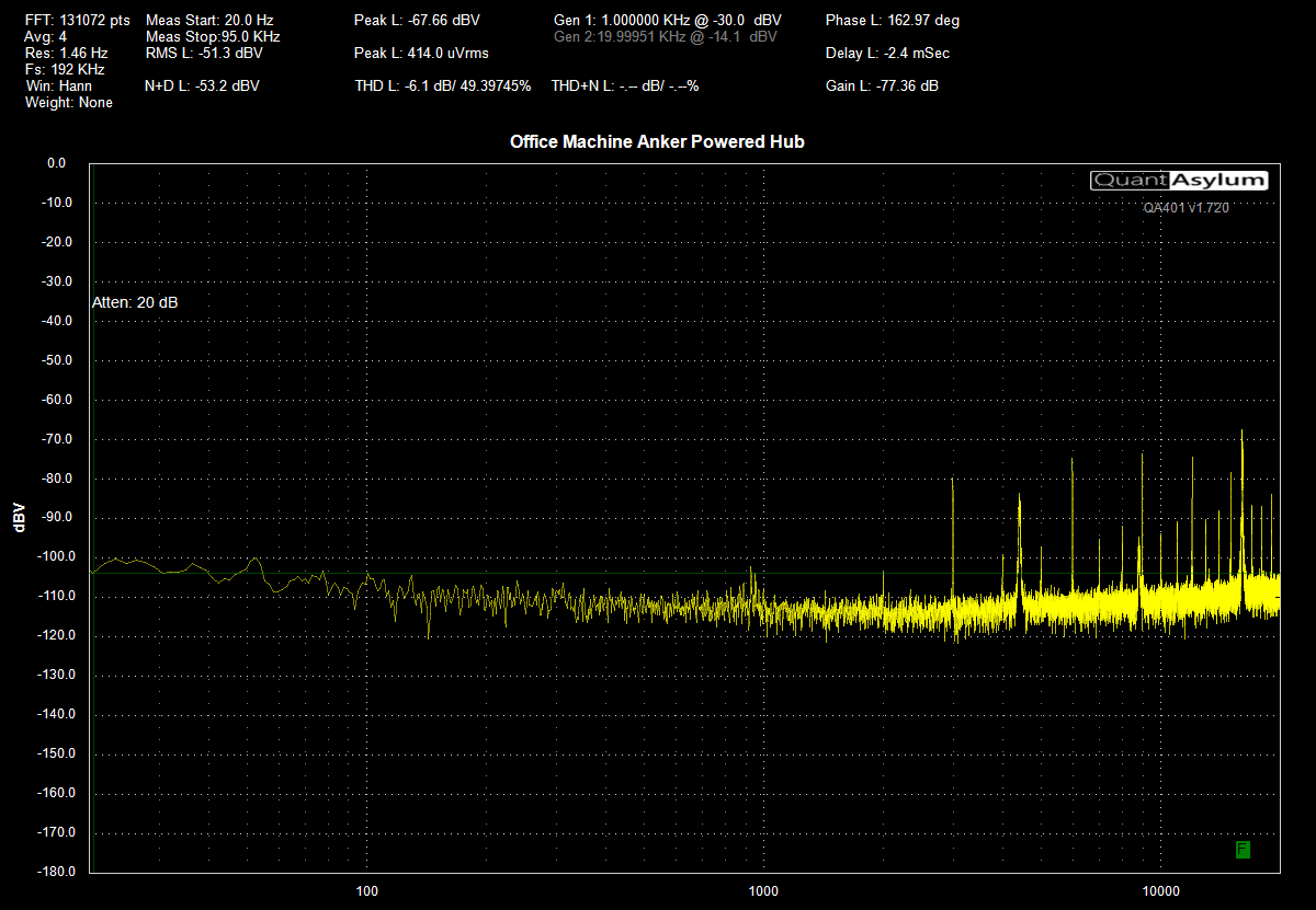

Also, there are some USB ports that are absolutely nasty in terms of the power supplied. In the attached, you can see the USB3 port on the Asus motherboard in my office is 60 dB worse than the Anker powered hub at 1 KHz. This measurement was done by shorting the L- input on the QA401, attaching a scope probe to the L+, and then touching the scope probe with ground lead to the USB supply lines on a breakout board. The breakout board allows the use of data lines but lets you supply power from some other source.
Notice too how pronounced the 1 KHz is on the office machine. That is very likely the USB polling rate on this particular hub.
Do you have a powered hub you could try if the cable swap doesn't solve it?
